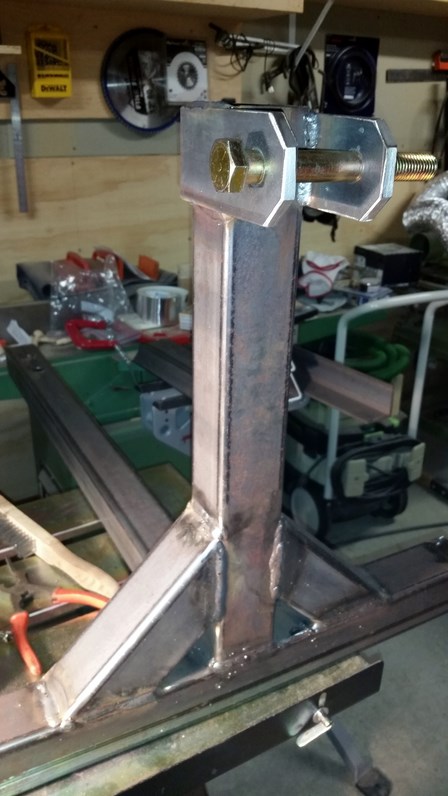

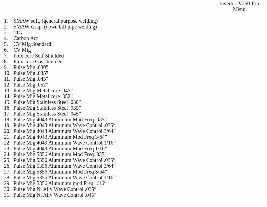

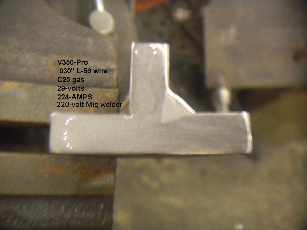

This is one of the nicest Mig welders I've ever used. Lincoln V350-Pro.
Lots of power!
