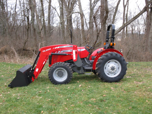

IMHO if I were to fool around in the woods I'd want no less than 40 horsepower. 4 wheel drive is a must for snow, a front blower is the deal but pricey. If your only going to mow, anything over 25 hp would do the job.
The issue with horsepower isn't just horsepower but weight, with weight comes traction. I would consider a utility tractor, nothing fancy and plenty of weight. With Massey consider the 2600 series not sure about the others.
My brother-in-law lives in Freeport and gave up trying to handle snow with his 20 hp JD. He hires a guy to get most of it and he cleans up as best he can.
You're gonna' spend more but in the long run I think you'll be happier with the larger machine. I'm pretty happy with my 2615.
Subscribe to Lancaster farming and you'll see hundreds of nice used machine every Saturday.
Getting stuck sucks!!!!
