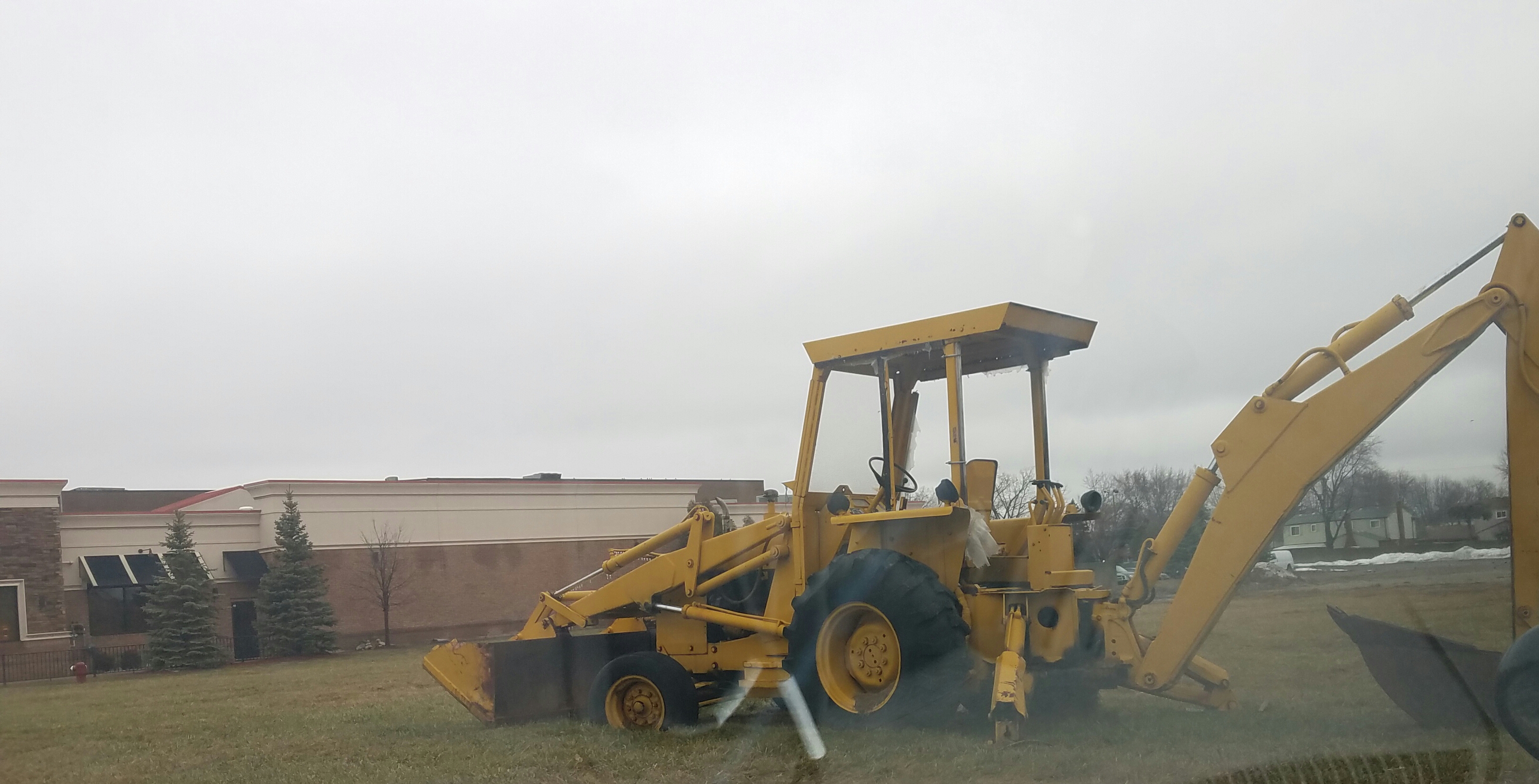

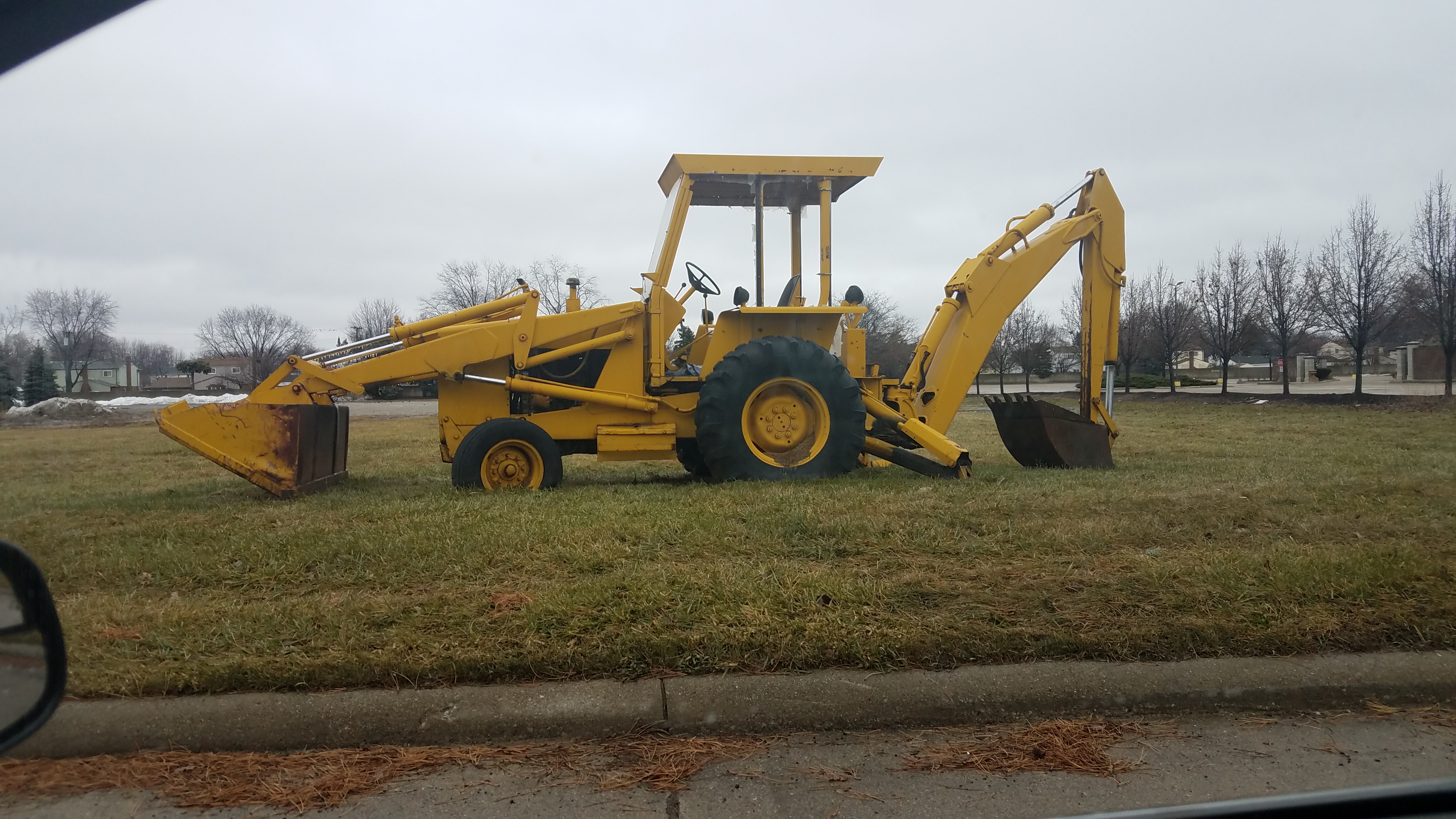

So I have the opportunity to pickup an older TLB from an acquaintance. I'll just say that for all practical purposes, I can have it for basically free. It's been sitting for a year, but this company used it for maintaining their business grounds and pushing snow for the last 40 years. I didn't look at the hour meter, but I'd guess the hours are lower than average. I don't "need" it yet but it would come in handy on some of my larger jobs as my business expands.
Looks like these units were built in the late 70's, weigh in at around 11,500 lbs, and have a fairly strong loader and hoe. TractorData.com Ford 55 backhoe-loader tractor attachments information
This company replaced the unit last year with a newer one with full cab. Apparently before they parked it, it was having issues with the fuel cutting out. Speaking with the employee that ran it, he stated that it would always start even in winter (with an ether shot) and would run for awhile, then stall out. After sitting for a short period, it would restart and run again. It also had a small leak in a fuel line. They believe the stalling issue was fuel related, but instead of dealing with it, they just bought a new one since they wanted a cab anyhow, and parked this one (it's been long long paid for). They say that besides the occasional stalling issue, it was a strong runner with good hydraulics, a couple new lines, minor leaks, etc.
So anyhow... Not that I want a money pit, but for the "price of admission" I think i can justify a potential project.
I tried to find a serial plate on it but couldn't. Granted I only spent about 5 mins looking at it (this just sorta came up out of the blue).
Can anyone with experience running or owning this machine give me any insight, advice, warnings, tips, etc? Do you know where I might locate the VIN plate? Do you have a list of maintenance items, filter numbers, etc?
There's no particular rush, but I want to get myself prepared. Before Spring, I'm hoping to bring some tools to the site, a battery charger, filters, new fuel, portable compressor (tires low) etc... And see if she'll get running. Then I can load her up and get her to the barn for some closer attention.
Thanks in advance!

Just now saw the picture. Nice looking hoe..!! The large holes by the outriggers is where I ran the chain through, when transporting. The holes in the outriggers to drop a chain in, are to hold the boom, in case it drifts off. There should be matching holes in the boom. Pretty sure it takes sections of 3/8" chain.
