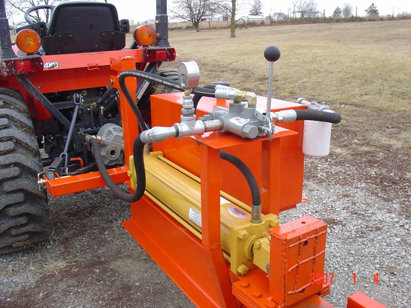

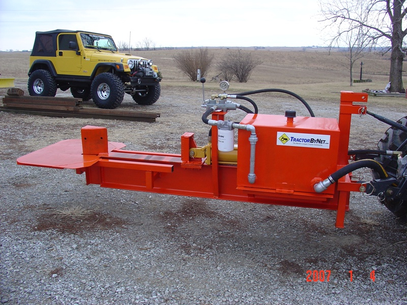

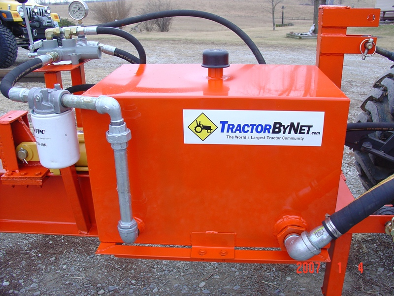

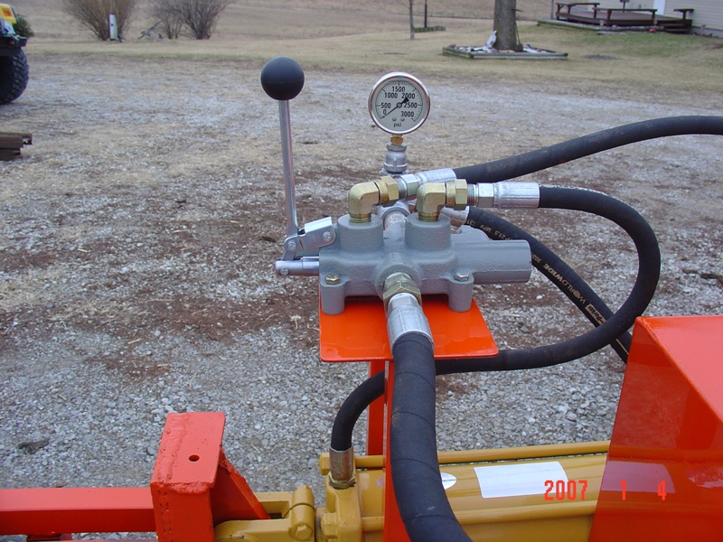

   / Looking for info - 3 point log splitter #7
I sincerely appreciate all the replies and information. Would adding a tank and attaching to the pto pump be an option (similar to how my backhoe works)
Yup, that's how mine is set up,
The size of the pto pump will determine speed, as long as the hoses, ports ect. aren't restricting the flow.
SR
