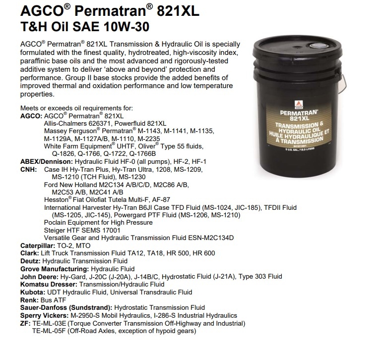

Same here.... When considering hydraulic fluid change in my MF and after a front axle seal change was trying to get some idea what fluids were a acceptable fluid and purchase locally... Out of frustration and lack of good information I went with the manufacturer's suggested fluid that was a 10W30 and semi synthetic blend.. Ironically it was touted to it was also a replacement for many fluids that were listed as manufacturers replacement fluid for many big manufacturers of off road/agriculture/mining equipment.... Ironically the ISO (10-30-46-68-100 (or whatever the numbers)) designations for fluids has little information as to what was is a compatible fluid for any given machine....And ironically I was restoring a 30 year old log splitter that had some problems I found a manual saying it uses DEXRON II auto transmission fluid.... Guess what DEXRON II was not available to me locally so when with DEXRON III ( but label on jug stated it was replacement for DEXRON II) .... Go figure....
