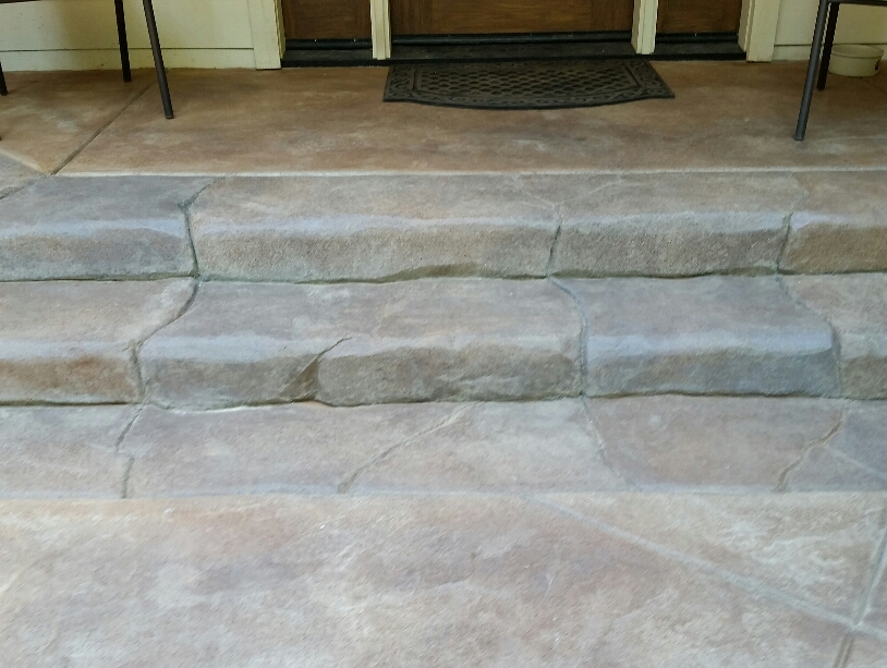

Yeah concrete and steel with pan decking and concrete if it's an elevated deck.
If there is wood involved the clock is ticking no matter what you deck it with because it's the structuring that rots, burns and the bugs eat. I know how to make it last longer but about all you can do is put off the inevitable. I just tore out a wood deck out front and replaced it with concrete and am looking at doing the same for the elevated deck out back. Yeah you do pay more but you only pay once. You can make concrete look real purdy with stamp and stain. You could even make it look like wood if you wanted to. This is concrete Steps.jpg
