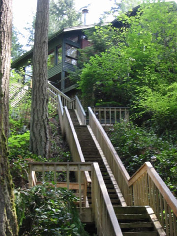

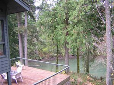

   / Looking for ideas on how to build the best low to no maintenance deck
The joists and beams are what is failing and an occasional small section of plank.
Previous owners rebuilt it and all wood was milled on site... cedar and Douglas fir.
The 4 x 12 clear vertical fir beams have sections have spots that turned soft and punky.
The 2 x 12 joists are the real issue and losing strength.
Planking is easy to swap out a bad section and has been the least of concern
I have 4 cantilever balcony decks, a wrap around deck that is on grade at the back of the house and 12' above the slope where it ends.
The is a 4 x 12 fir stair case to the lower lever... both treads and stringers... the treads have done well the stingers not...
Seems like return to nature happens at an accelerated rate in Western Washington.
