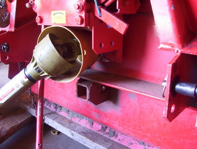

</font><font color="blueclass=small">( Has anyone added a hitch receiver to a Farmi Winch? Not sure of best place to attach without messing up function of winch. )</font> <font color="red"> </font>
Here is one I recently added to my winch. Cut the hole with a cut off wheel on a grinder. Inserted receiver tube and braced it some on the back side.

Maine_Polack,
Thanks for the pic. Looks like a good way to go. Is that hole positioned just below the attachment for the PTO shaft?

Went out and took another pic from the back this time.I positioned it here because it was easy to brace. Idealy, I think it could be lower. I use a hitch that allows the ball to moved up and down, so I set it down a ways and it works fine.
