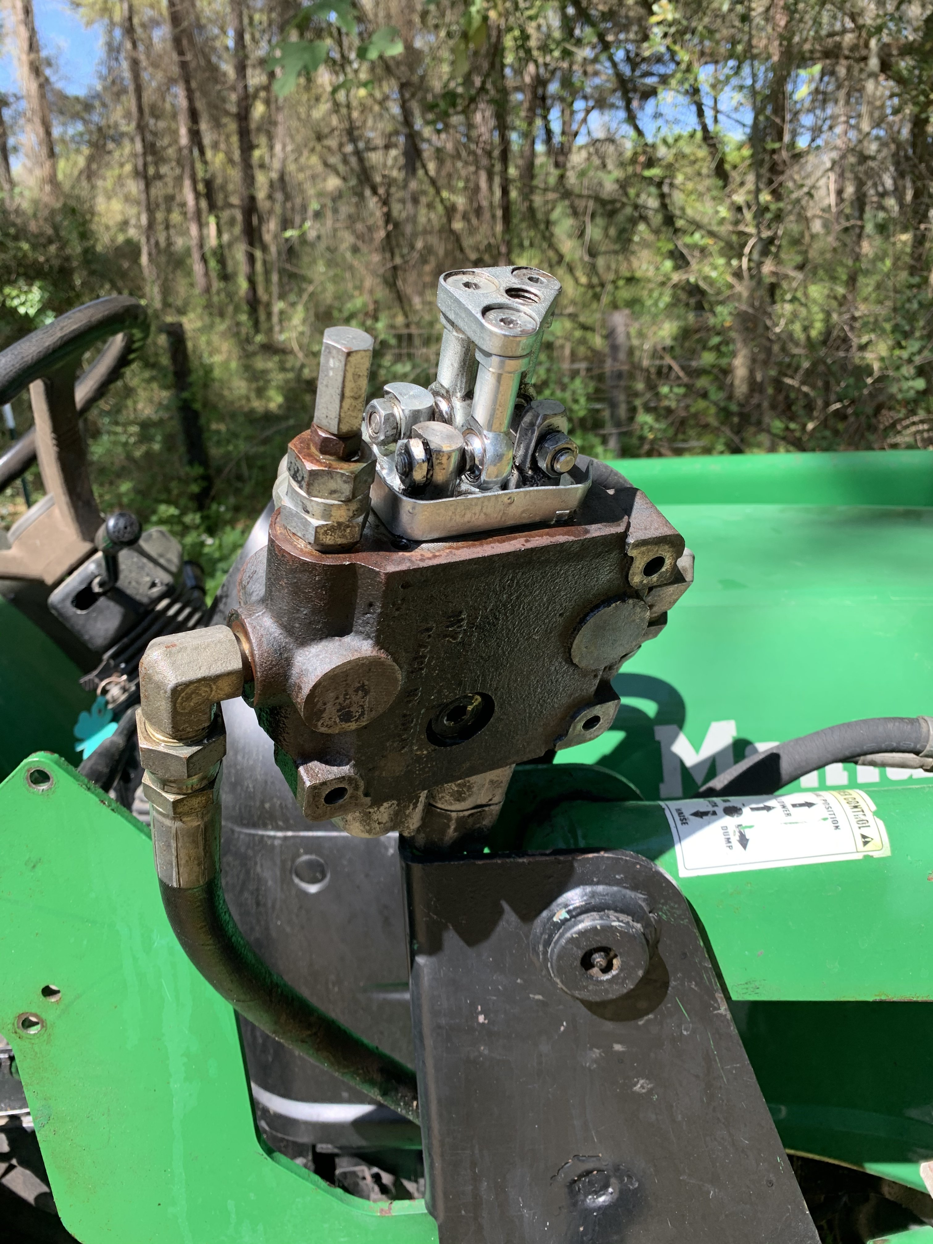

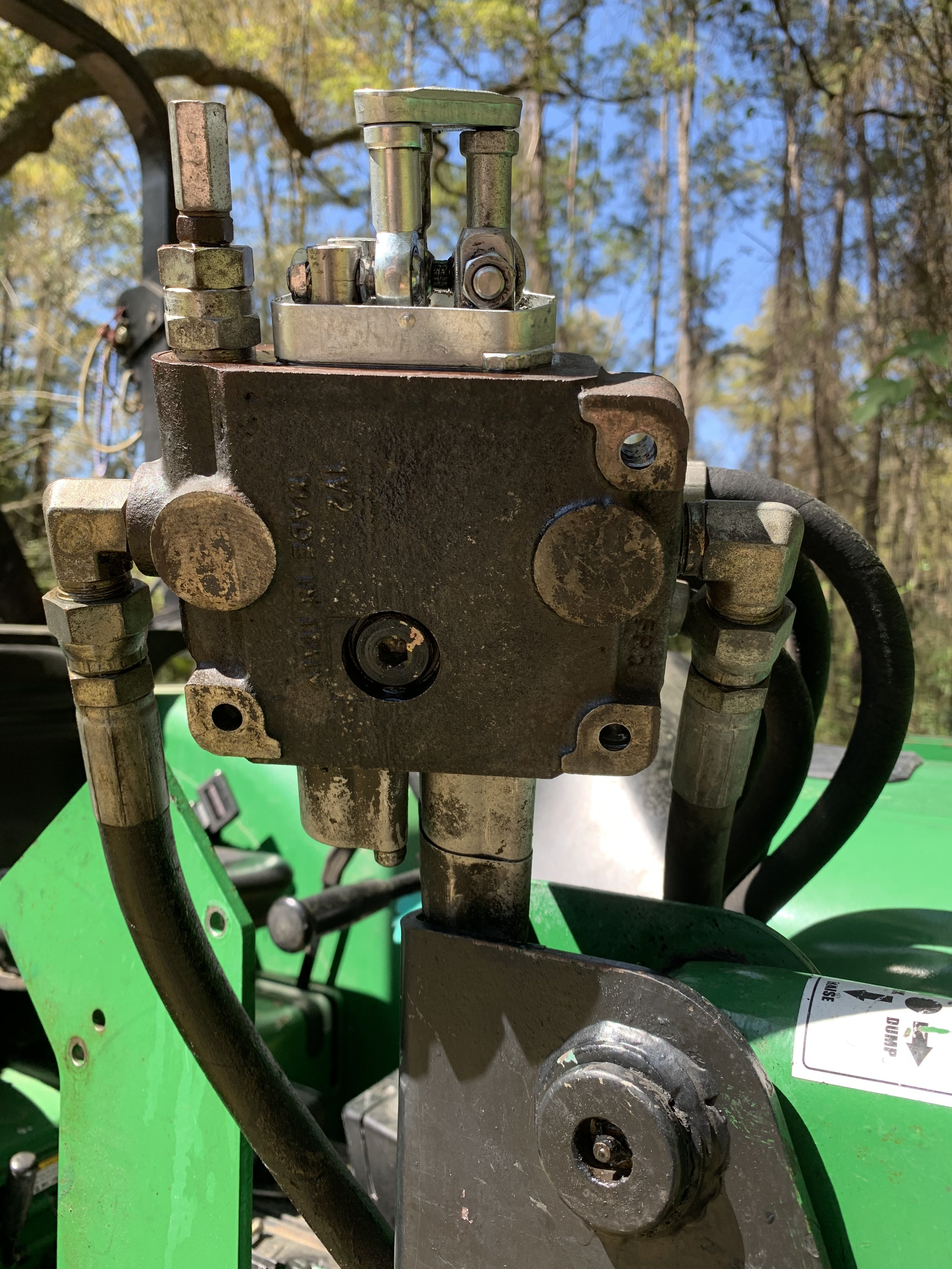

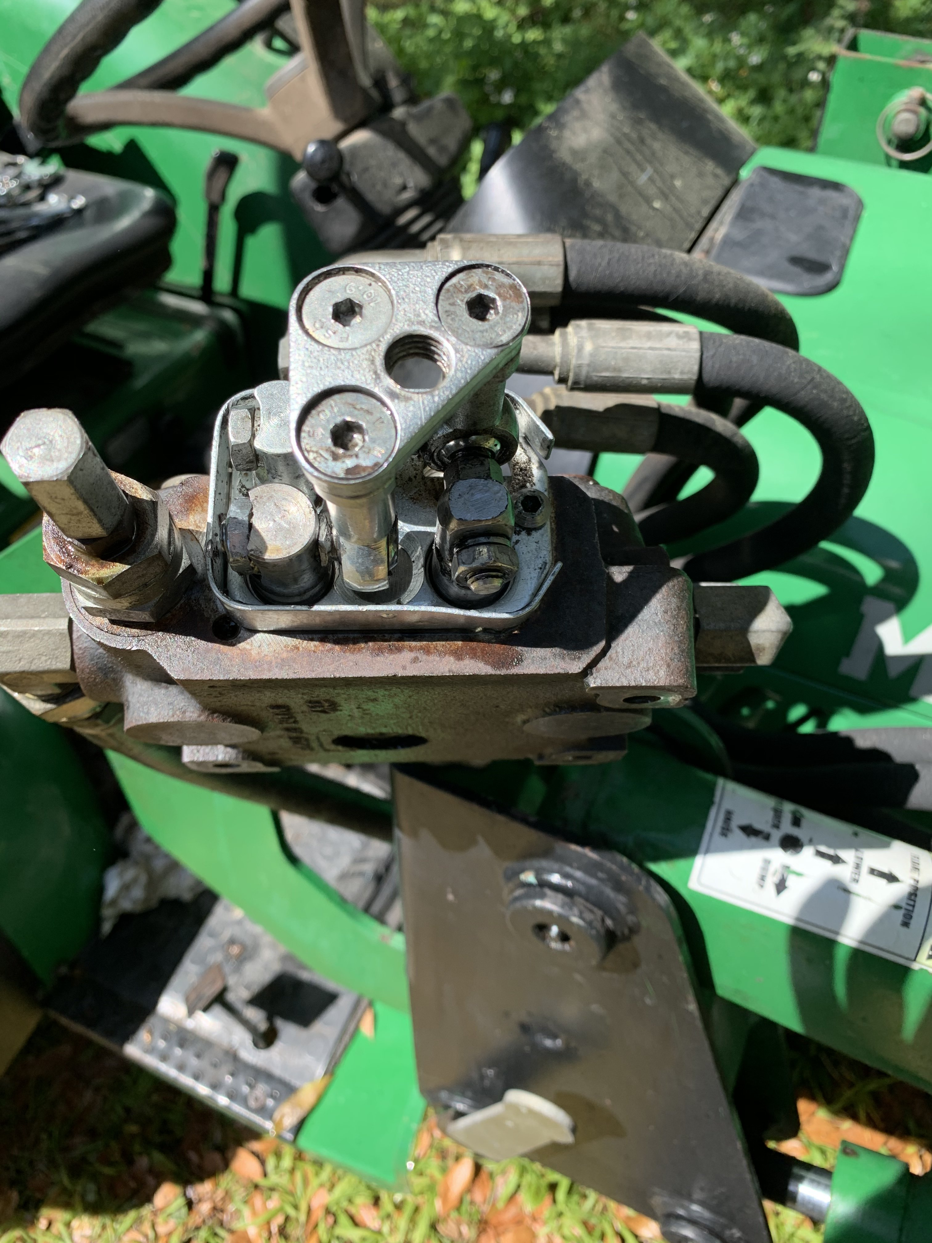

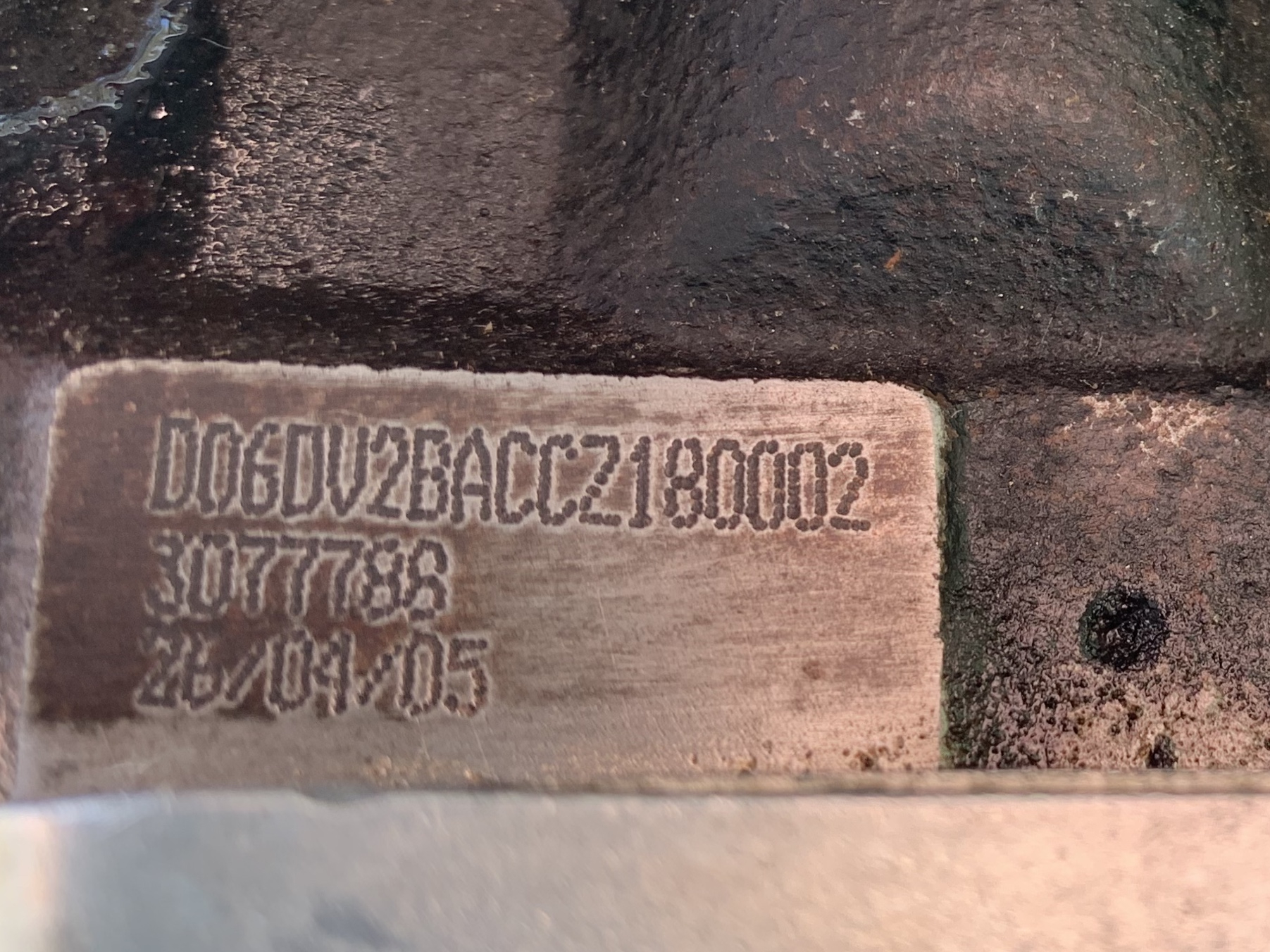

I’m Looking For This Part. Not Good With Computers So I Have no Choice But To Post pictures.
This is on A Montana Tractor 3840
Part # Seems to be A Problem. Can Someone Help.

Finding exact replacement is going to be tricky. The OEM manufacturers usually make those things under contract to the tractor company (Montana in this case, which was built by what is now LS) and they won’t sell direct.
You can either try a larger LS dealer and see if they can find the direct replacement, or you can install a universal joystick valve assembly like this one at Surplus Center:
https://www.surpluscenter.com/Bran...ontrol-Valve-w-Float-Chief-220957-9-12475.axd

I wonder why do you want to replace the valve. Valves usually don't go bad that often.
What's wrong with it?
3Lfarms has a good suggestion. Surpluscenter does have a couple valves available that will work just fine.
   / Looking for hydraulic bucket valves replacement for 3840 Montana tractor. #5
Unless something is scored, you most likely can just replace some seals or Orings to rebuild it. If you aren't comfortable doing it, I'm sure a good hydraulic shop would do it.
