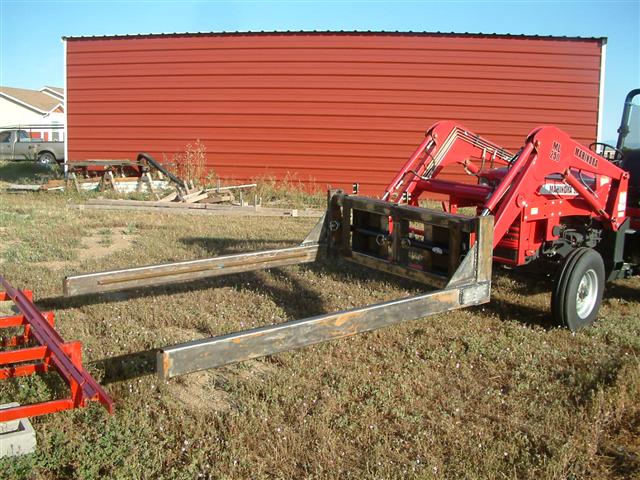

Pretty much an ideal setup for the small hay farmer like yourself on a tight budget. I have all the stuff you have except the tedder--the humidity is so low and the annual rainfall is a puny 18-20 inches that tedding isn't a necessity up here in the North Sacramento Valley. Like you, I've spent $5-6K including about $1500 for a home-made bale accumulator/bale squeeze for my Mahindra 5525 tractor.

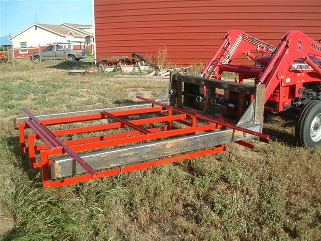

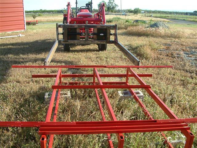

I'm too old to be bucking even the small 50-60lb square bales I get from my MF124 baler so I built this thing--also gave me a nice winter welding project and a chance to build my first custom attachment with a skid steer quick attach plate included.

I was curious about you bale accumulator, can you give me more info and some other pictures. How does it work? I'm getting a little old to throw the bales around and any help would be appreciated.
