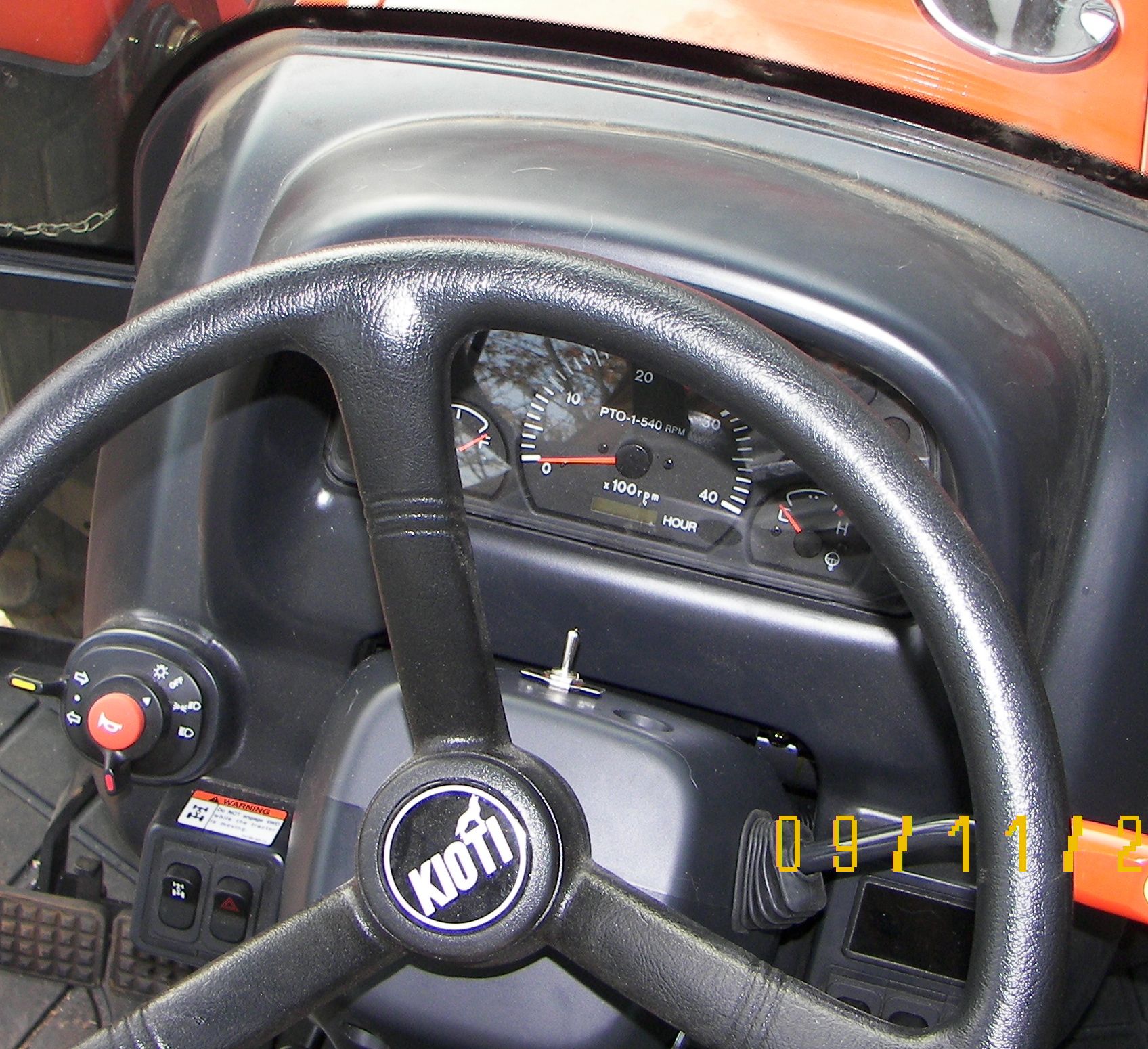

Here is what I used. A jawtype coupling, power window motor from a 190E mercedes, and a piece of angle iron.
I have a electrical plug at the back of my tractor. I just plug in the connector and operate the motor with a two way switch. I don't need the blower that often but the few times I have used it it has worked great for me.

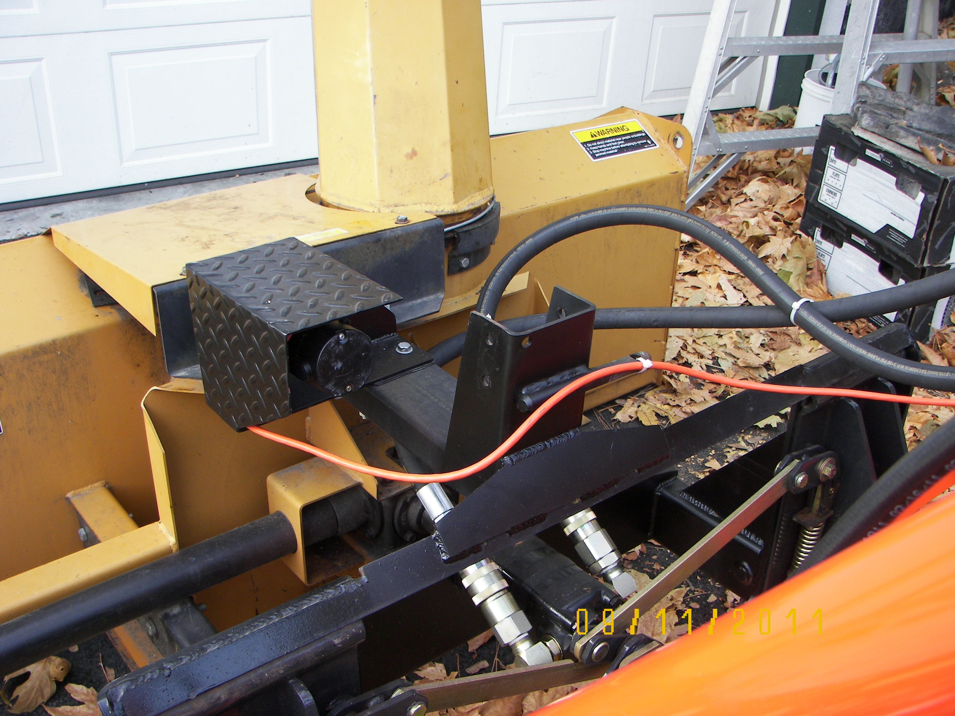

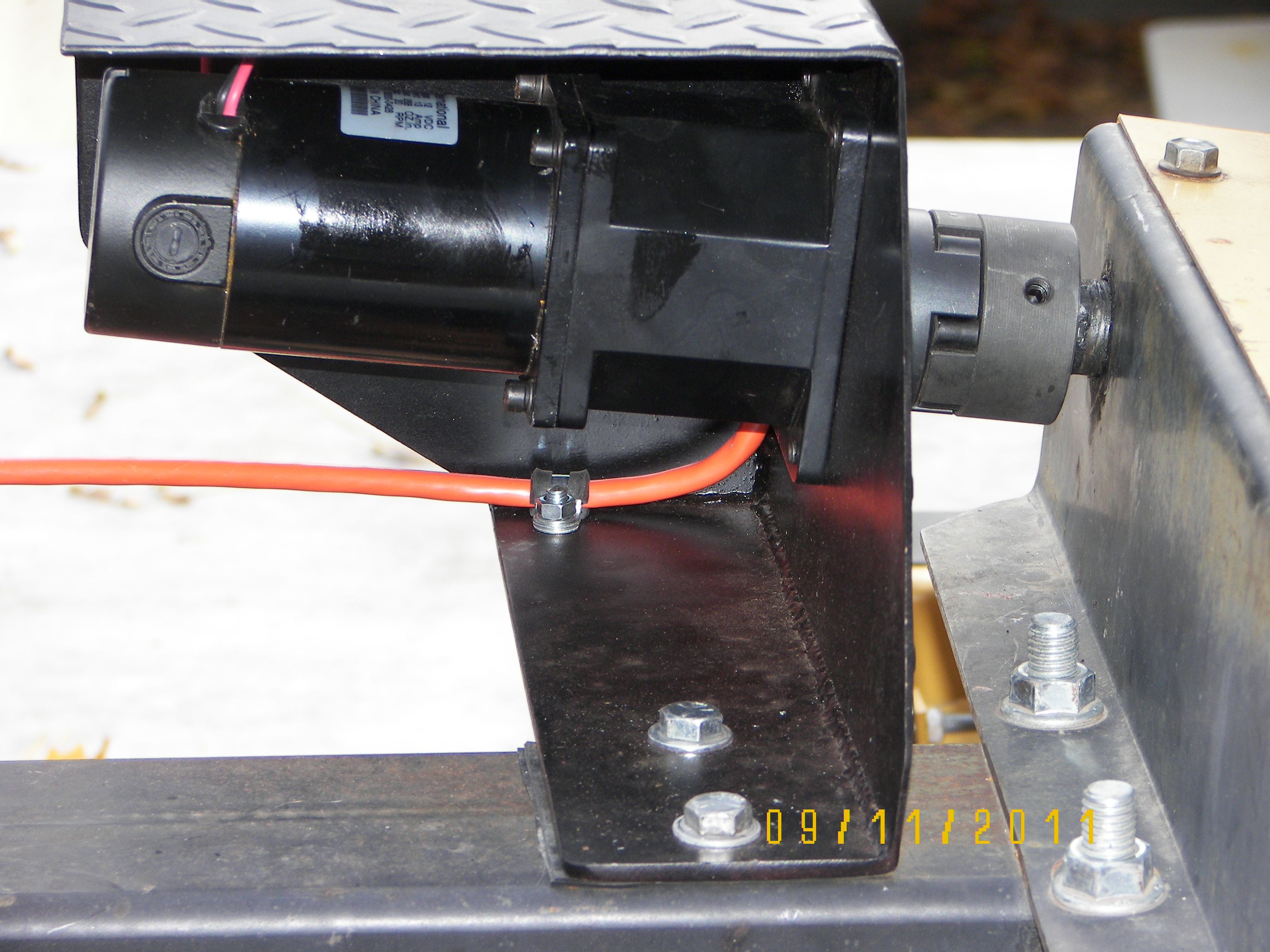

Rather than a window regulator motor I used the little gear head motor that Surplus Center sells, it's a rather beafy little guy, and we made a diamond plate house for it to keep the snow off.
The process was: 1) remove the crank and shorten the drive tube, 2) mount a flex coupling, 3) make the mounting house to fit, 4) wire it up to a fused circuit (this motor will stall out at about 13 Amps) and 5) switch with a DPDT momentary in a convenient location.

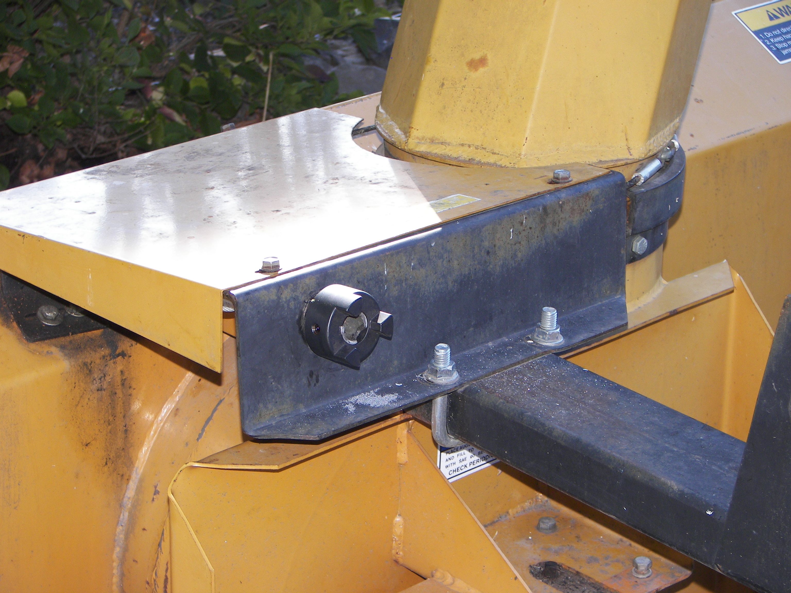

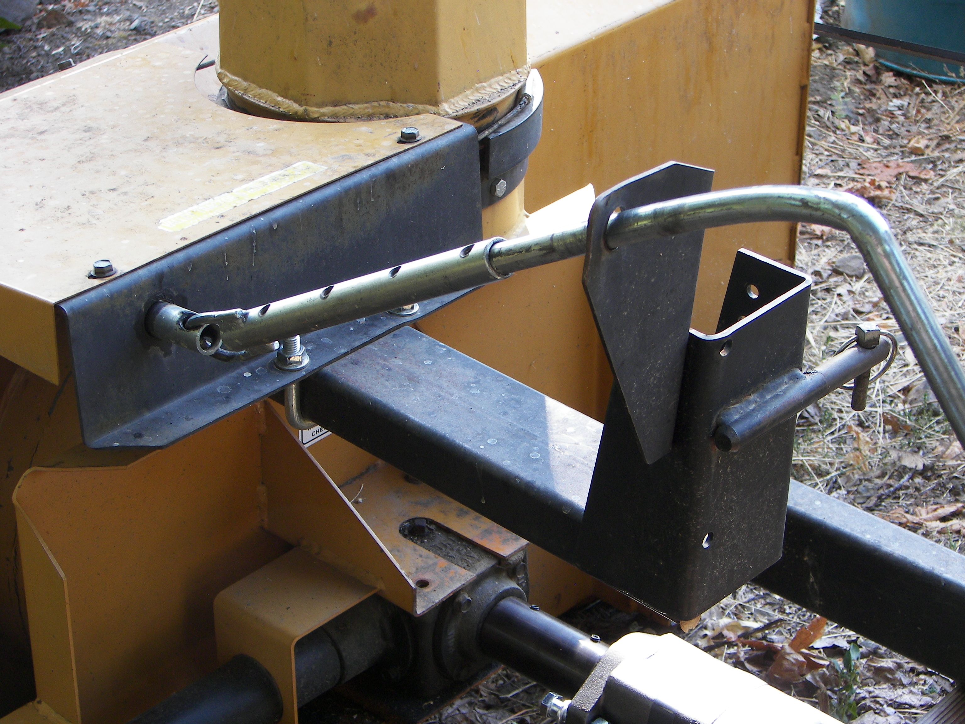

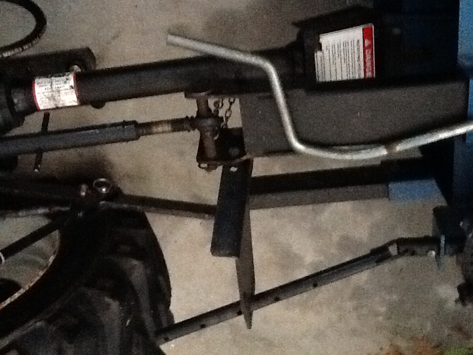

Very nice work. What actually turns the chute (from the coupling to the chute).
   / looking for detailed pics of window motor chute mods #8
Thanks, the turning mechanism is as built by Woods, cable wrapped around the drive tube and bolted to the base of the chute.
DrMac
