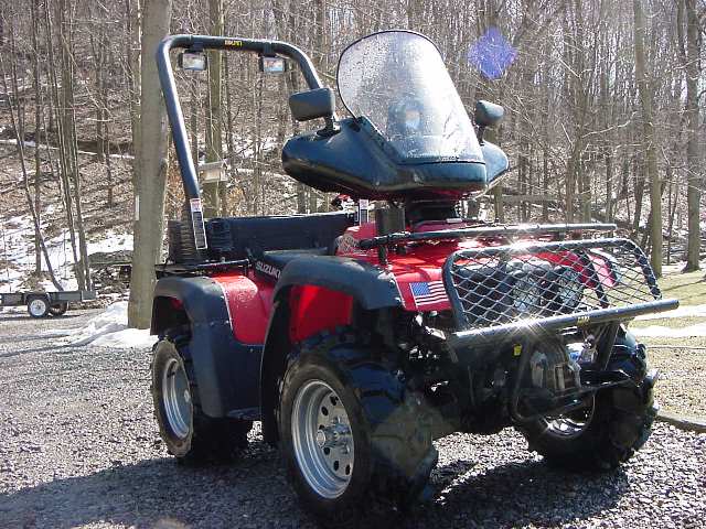

What kind of wheels do you use with your 589's? I thought about going that route and just keeping the stock ones for summer use around the yard and such and switching out the more aggressive ones for the wet stuff.

The wheels are steel, chromed. I think I got from the Dennis Kirk scratch and dent on e-bay. Got real lucky, nobody else bidded. Got all 4 for less than $40 + shipping /forums/images/graemlins/grin.gif /forums/images/graemlins/grin.gif /forums/images/graemlins/grin.gif
I would not want to run the 589's all year. They'll eat anything soft, including the yard.
Attached is a pic.

Nice windshield.....Does it help?
