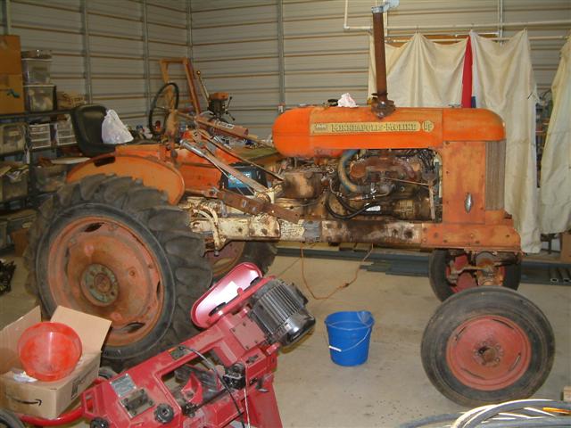

The Avery R is the same as the Minneapolis Moline BF. MM bought Avery in 1950 or so and renamed the Avery R since MM already had an "R" tractor in its lineup.
I found the operator, parts and service manuals for my MM/BF on eBay.

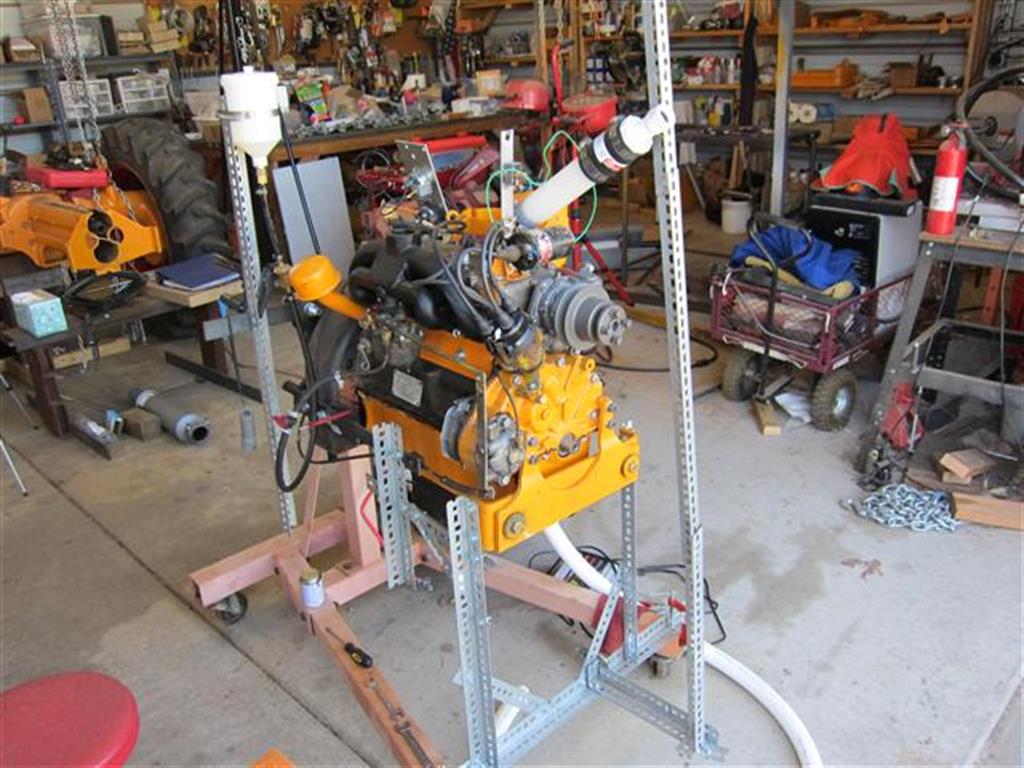

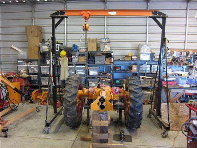

Here are a few photos of my MM/BF restoration.
MM-BF-before.JPGMM-BF engine run stand (Medium).JPGMM-BF rear tire gantry (Medium).JPGMM-BF gantry.JPG
I made this YouTube video of the startup of the rebuilt MM/BF Hercules engine.
Hercules engine run no 1 29jun2012 - YouTube

Not many around--that's the problem with these old Avery's and MM/BFs--hard to find parts and the parts tend to be expensive.
The engine in my MM/BF had zero compression on three cylinders and 25 psi on the fourth. I generally don't buy tractors that aren't running. But I really, really wanted that MM/BF (I collect high crop tractors with bull gear rear axles).
The parts (pistons, rings, valves, etc) to rebuild that 4-cylinder Hercules engine in my MM/BF cost $800 (new old stock (NOS) from Hercano). I spent another $800 in the machine shop getting that engine rebored, block surfaced, head milled, flywheel clutch surface machined flat, reassembled to the short block configuration, etc. These old ladies become money pits in a hurry.
