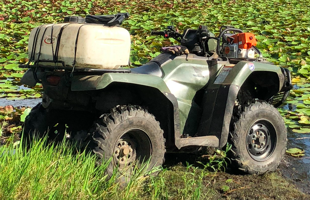

I had an ATV-mounted Fimco sprayer which I used for spraying Rodeo, a glyphosate (Roundup) based herbicide. Unfortunately, the tank failed and the chemical leaked, damaging the winch electrics for the ATV.
Rather than seek a new herbicide, I'd like to find a sprayer with a tank stout enough to handle glyphosate without leaking. This is primarily used to treat tall invasive privet and undesirable hardwood, so distance spraying is a necessity. I'd also like to spray diesel for pile burning, but that's a secondary goal.
Does anyone have any recommendations?

Never had trouble with the tanks, but I sure did with the pumps.

I ues the poly tanks with all kinds of crap and never had one leak. ---Did yours have a bad seam?

I have a 15 gallon FIMCO sprayer with poly tank for 10 years with no problems with the tank. I did replace the pump with a larger capacity one after a couple of years. I suggest that you mount a piece of plywood underneath the bottom rather than set it directly on the bar rack.
Also make sure that none of your tiedown straps have any metal touching the tank or any other metal from your luggage rack. Vibration against hard surfaces can quickly damage poly tanks.
I put mine in the back of my RTV and it is setting on a rubber mat.

I see you're in Georgia, so freezing should not have caused it. Do you empty the tank when done? I empty mine every time.. I've never had a tank leak/split.
NONE of the sprayers I've used allow/advise spraying diesel!
