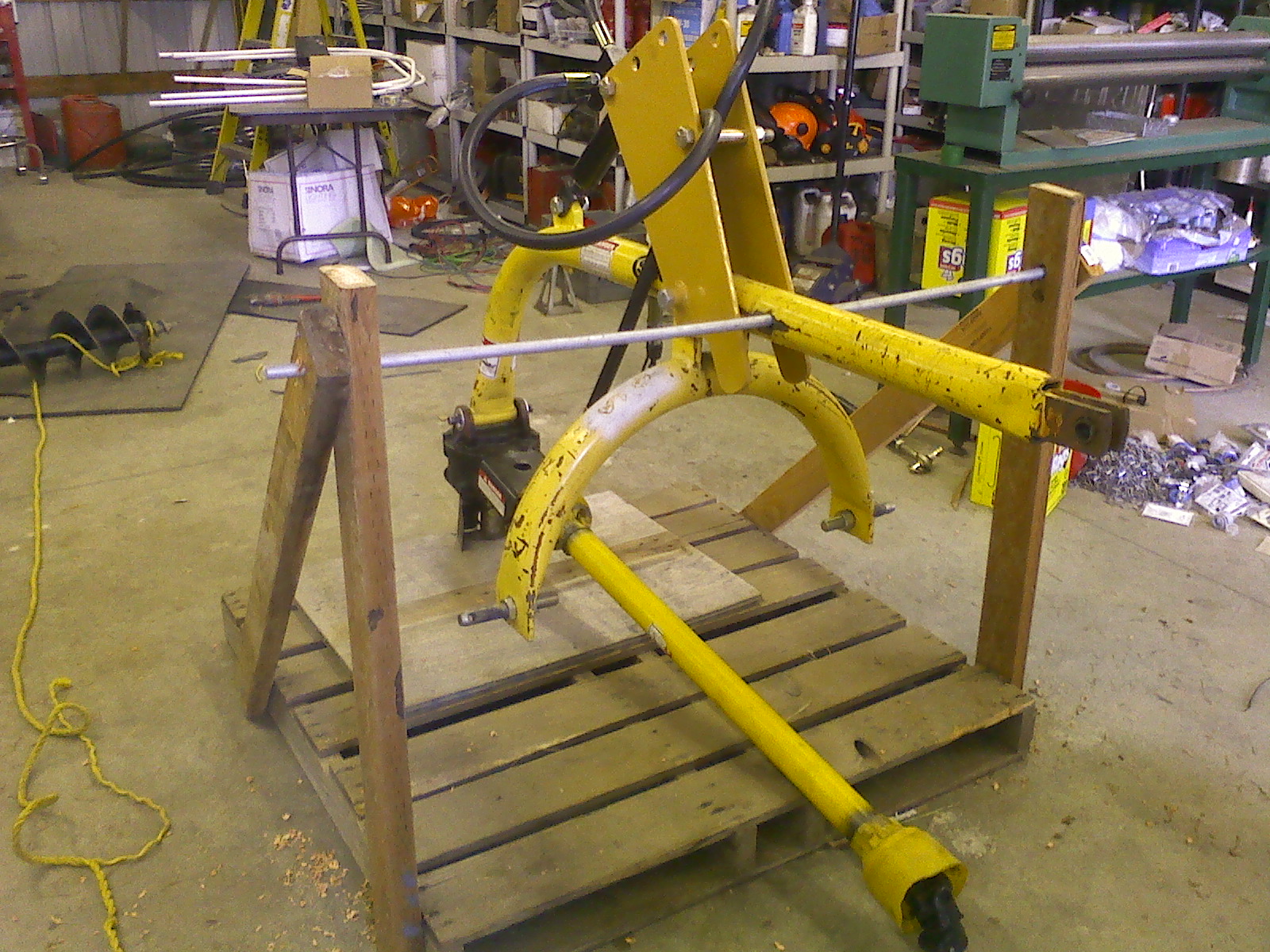

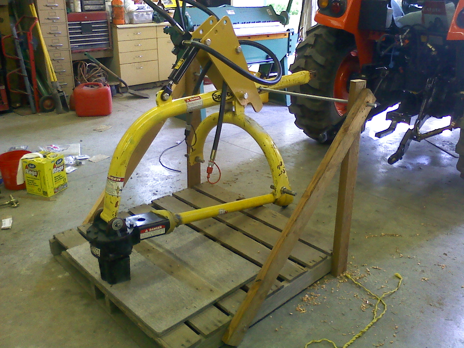

This is as cheap and easy as i could think to do with mine. Personally i remove my auger bit as i have 2 sizes anyways and i never know which one ill be using. Its made up of a pallet and some 2x4's . Then i use a 5/8" steel ground rod that pins the PHD up after its removed from tractor. Its set at the exact height needed to reinstall. And the pallet allows me to move it with my forks.
