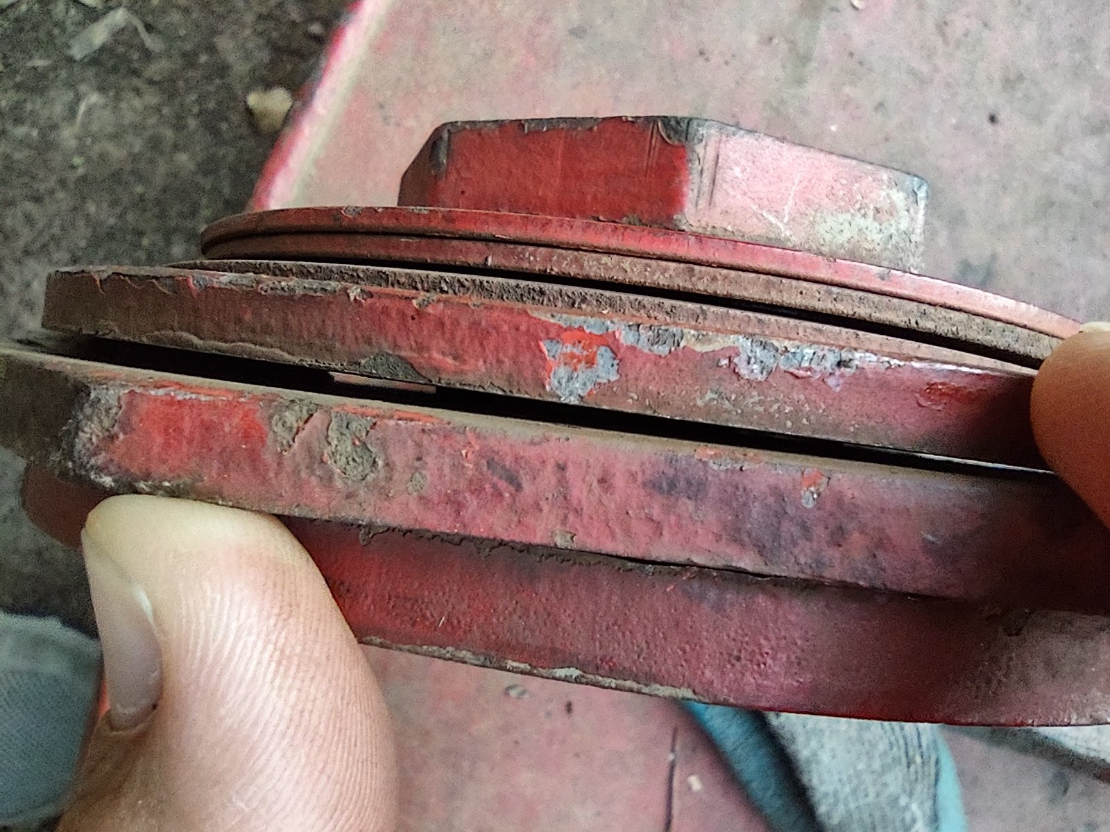

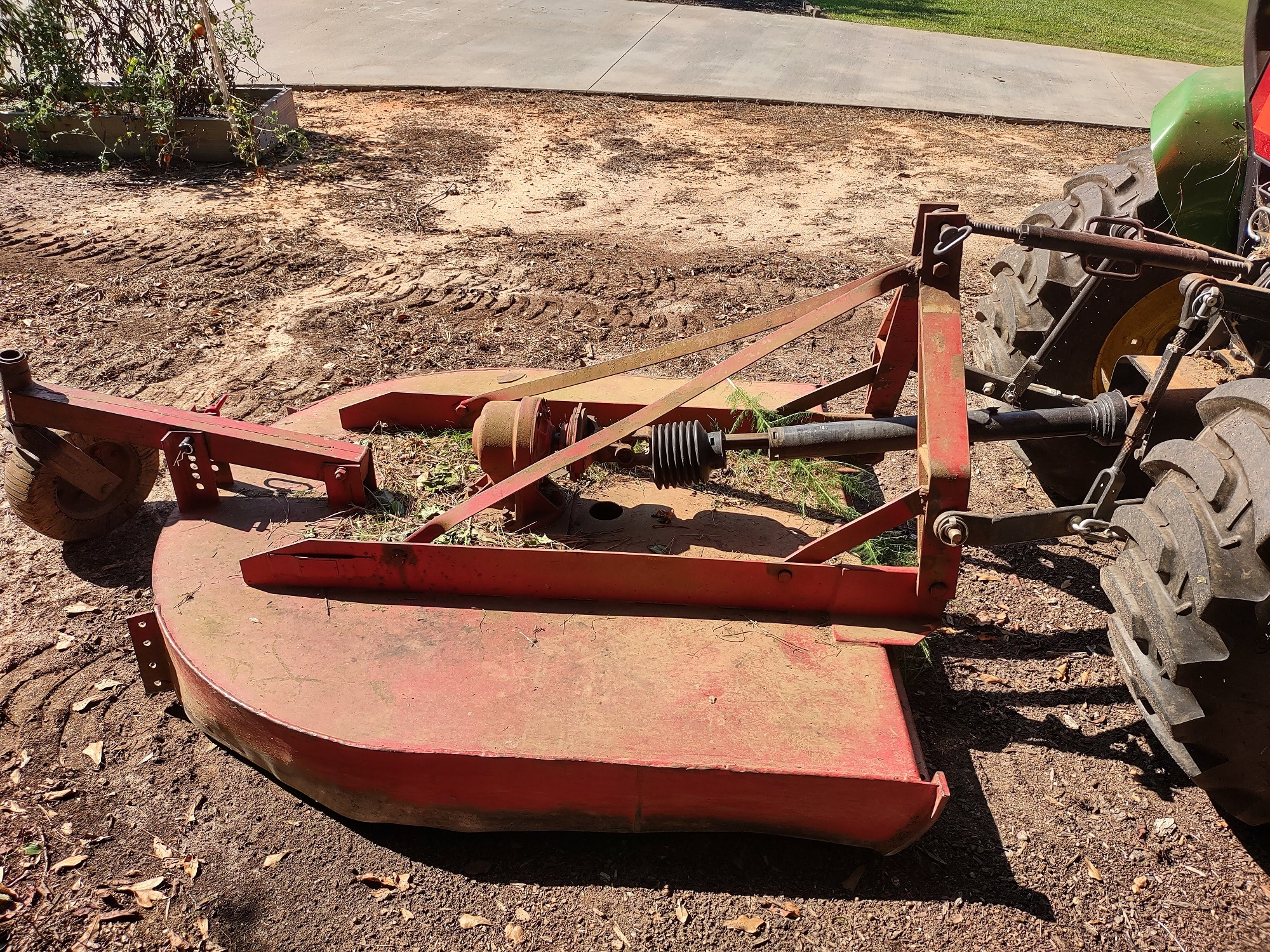

I have an older rotary cutter. I don't see a brand name, but it has the following ID:
T 660 LT
T816/443B
The Gear Box says "Auburn Gear" 2102-N
So the question.....where can I find the part in image 002?
The plates around the middle plate are not spinning with the PTO shaft. It looks like I could weld the 3 plates together. But I assume it would be best to replace if possible.
Thanks,
   / Looking for a part for my rotary cutter - 2102-N - Auburn Gear #2

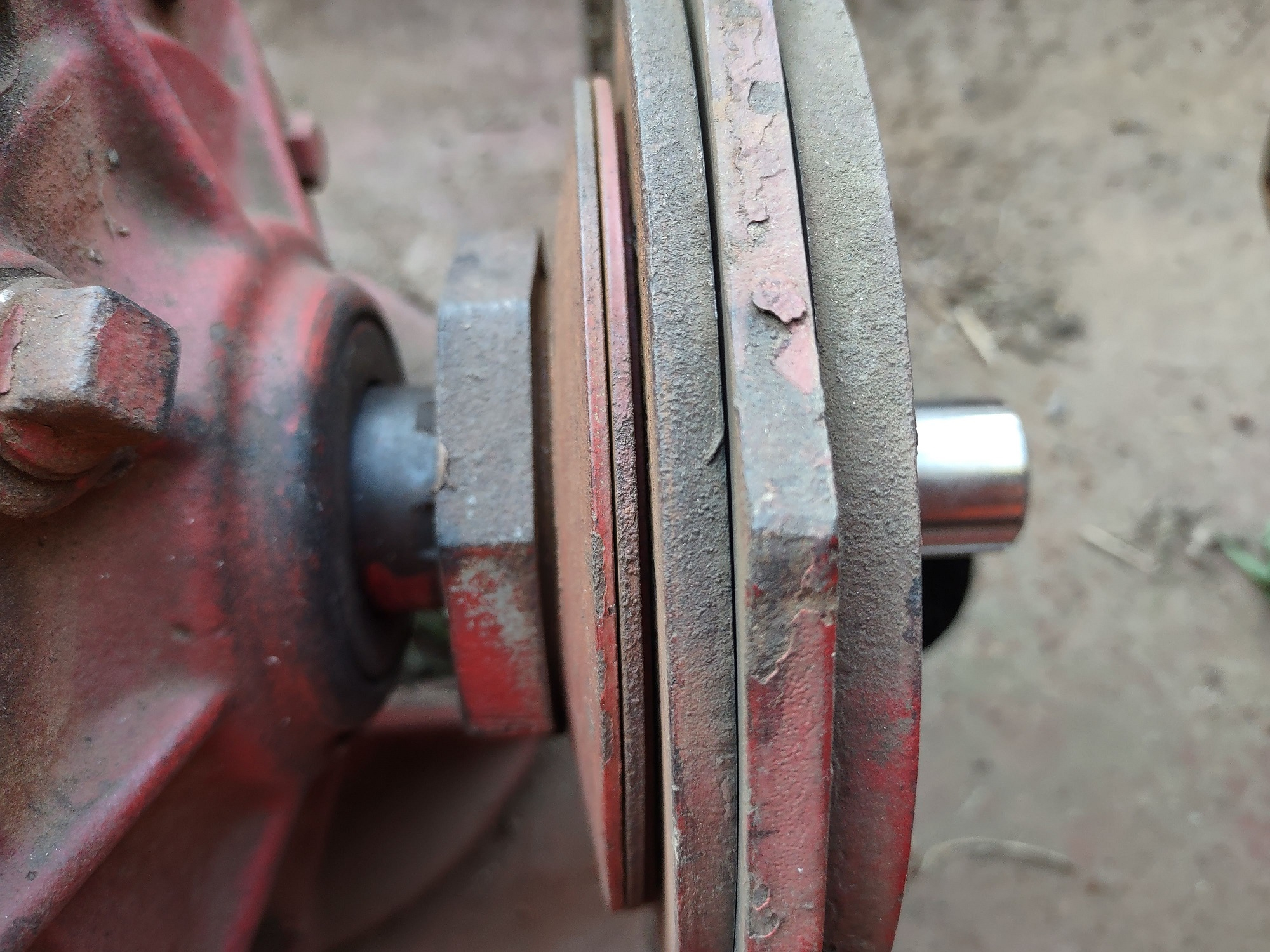

That is a slip clutch. It appears to be a belleville spring style. I would try tightening the nut on the back between the gear box and the clutch. If that does not work I would remove the clutch from the gear box and disassemble it to see if it has friction material in it. If it does most likely worn out.
Thanks, yes I know nothing. So it is slipping. I removed it. It looks like there were 2 gaskets in there and they have both deteriorated. There are 4 bolts attaching it and 1 was missing.
   / Looking for a part for my rotary cutter - 2102-N - Auburn Gear #5
I am thinking that those "gaskets" are actually friction material (like whats on brake pads).
Ok, so since they are gone...it's toast?
   / Looking for a part for my rotary cutter - 2102-N - Auburn Gear #7
Measure your old disks and call these people they may be able to help you.
If the slip disc carrier or holder is damaged they may also be able to provide a completely new slip disc clutch assembly.

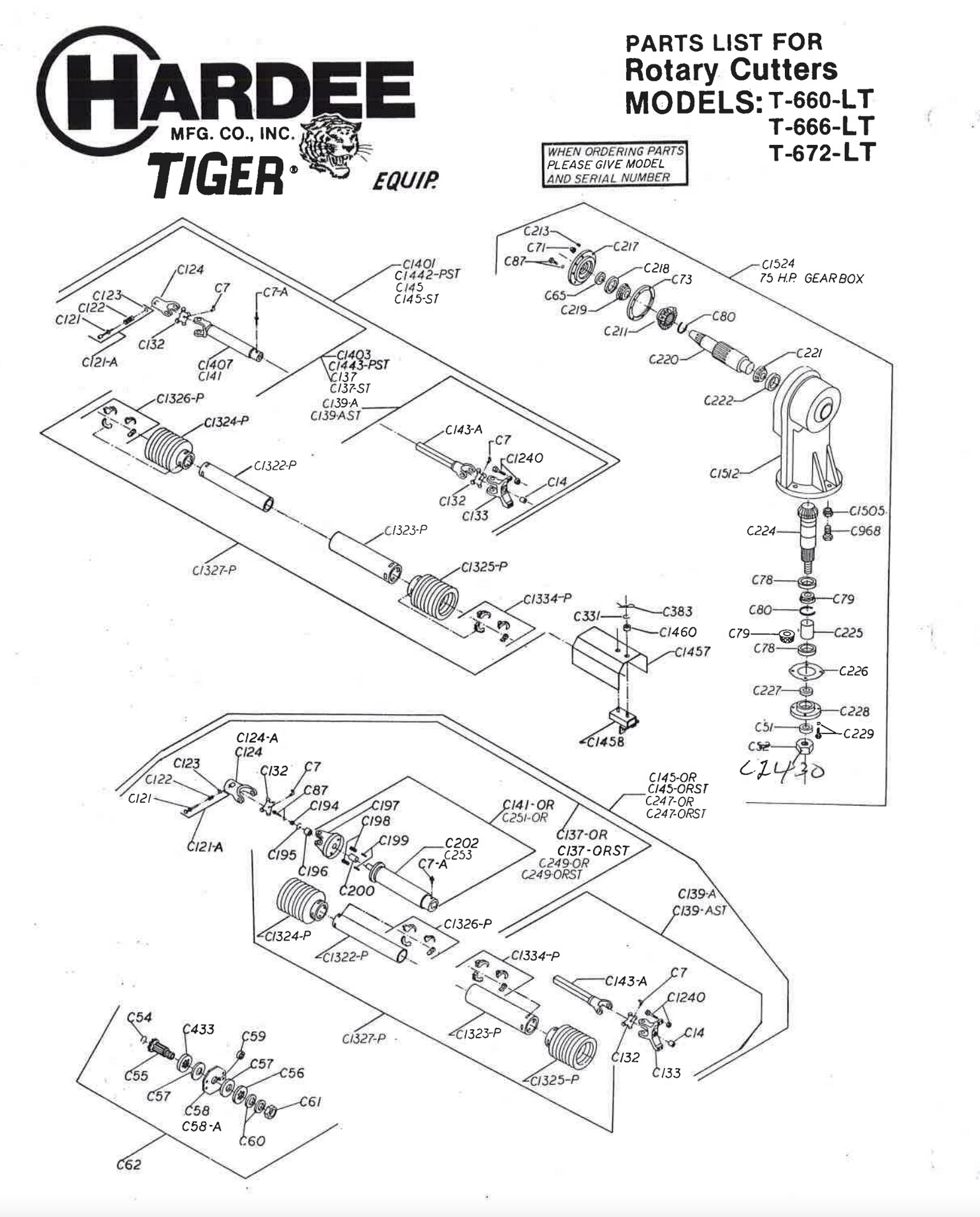

a T-660-LT is a Hardee Mower FRICTION DISC 6.5" X 2.625" 225-6526
the Hardee Part number for the friction disc is #C-57
