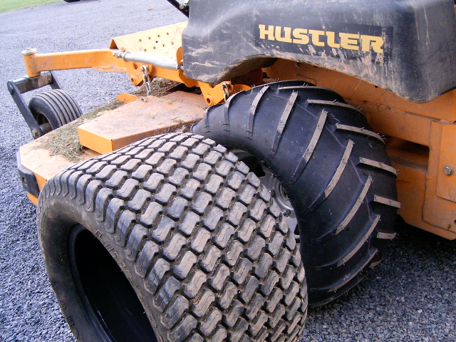

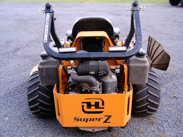

First maybe try different tires on your current zero turn.
I took the useless turf tires off my zero turn (was terrible and dangerous on hills)
Replaced them with Chevron AT 101 bar tires and the difference in traction is HUGE. The same hills that were always an issue with the turfs are no problem at all now.
