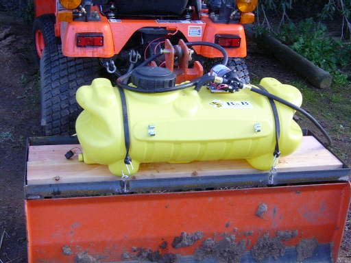

agri supply has them for like 100
This is a bad pic of mine but this holds my sprayer, boom and hose reel on top of my box blade. Just a simple L channel frame.
   / Looking for a good 3 point hitch sprayer #10
Most TSC stores have them. Or you could build one yourself. Do a search here for Carryall. There was a recent thread on building one.
