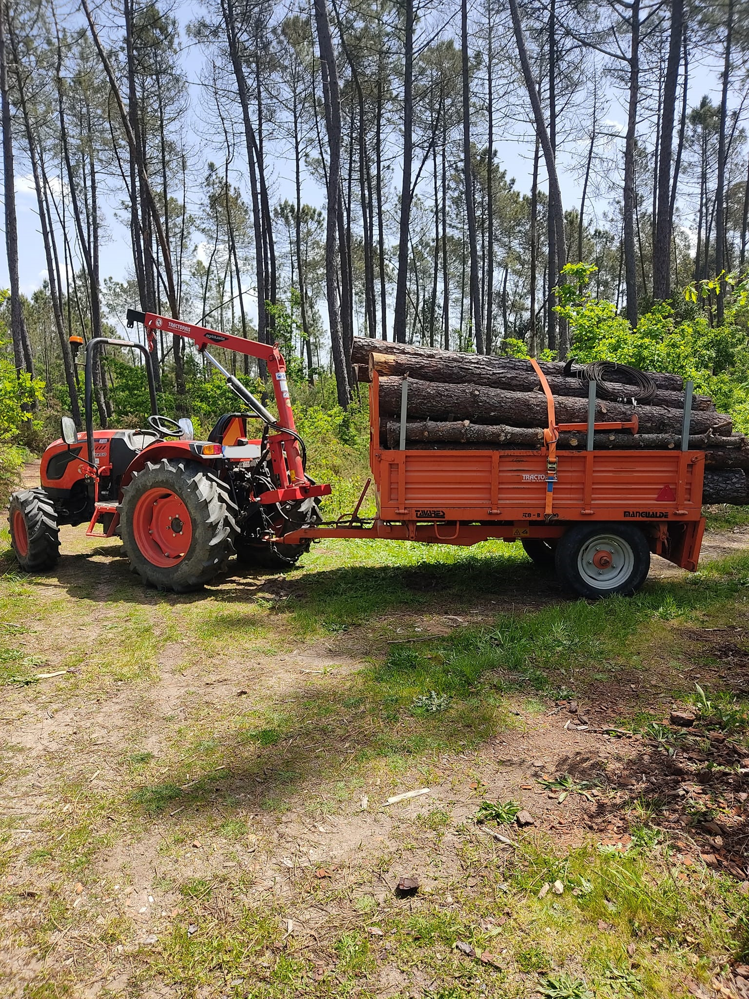

Holy crap are those trailers expensive.
That Kioti DK6010 would get 5500 kgs (12000 lbs) of towing capacity for braked trailers over here, and would most likely get either a 4 or 5 metric Ton trailer similar to this one in the picture below.
Built to last and to take a beating, 3 way dump bed (both sides and rear dump), hydraulic brakes, parking brake and light package. Can be bought brand new for €3500 to €4500, depending on the brand and accessories like taller sides. Or used but still in great condition for a lot less.
I agree. For what they are I think $3600 is pricey, but then again, the cost of steel is high these days. Still think I could build something like this or adapt something.
