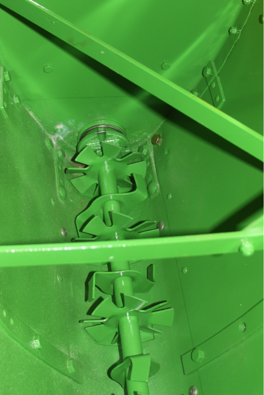

Cutting one down shouldn't be too much of an issue. For mine the agitator shaft is two piece and each side is driven by each wheel hub with a split bearing in the middle to remove the shaft if needed. It would be real easy to cut one down to half its size. They are pretty simple in design.

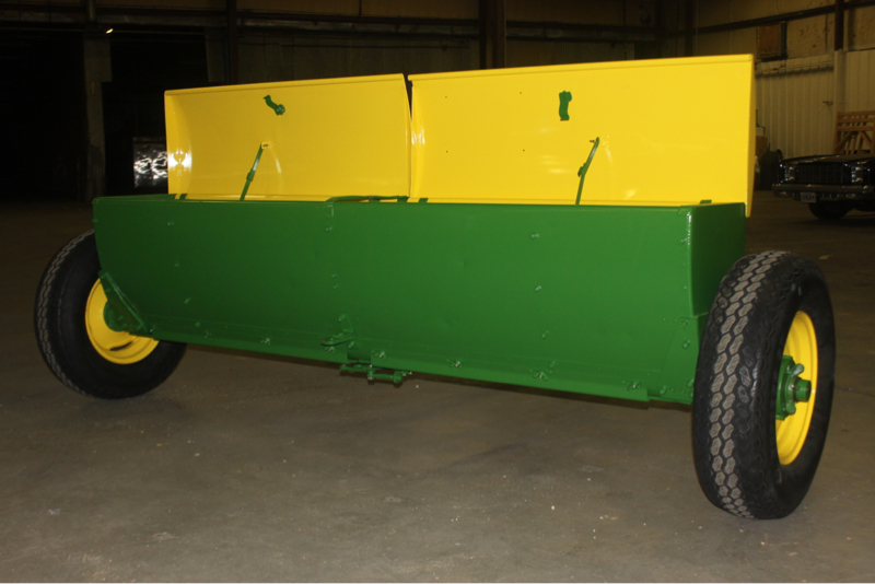

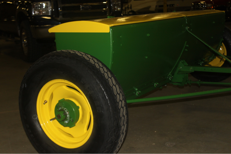

I restored an old john Deere drop spreader. They are hard to find. Mine was an 8 footer. They also made a 10. And with the added wheel width, it was hard to maneuver in tight spots. And you have to load it with another tractor and FEL. So ended up selling it and now I buy more expensive pellitized lime and use a spin spreader. It's just easier, but more expensive.
