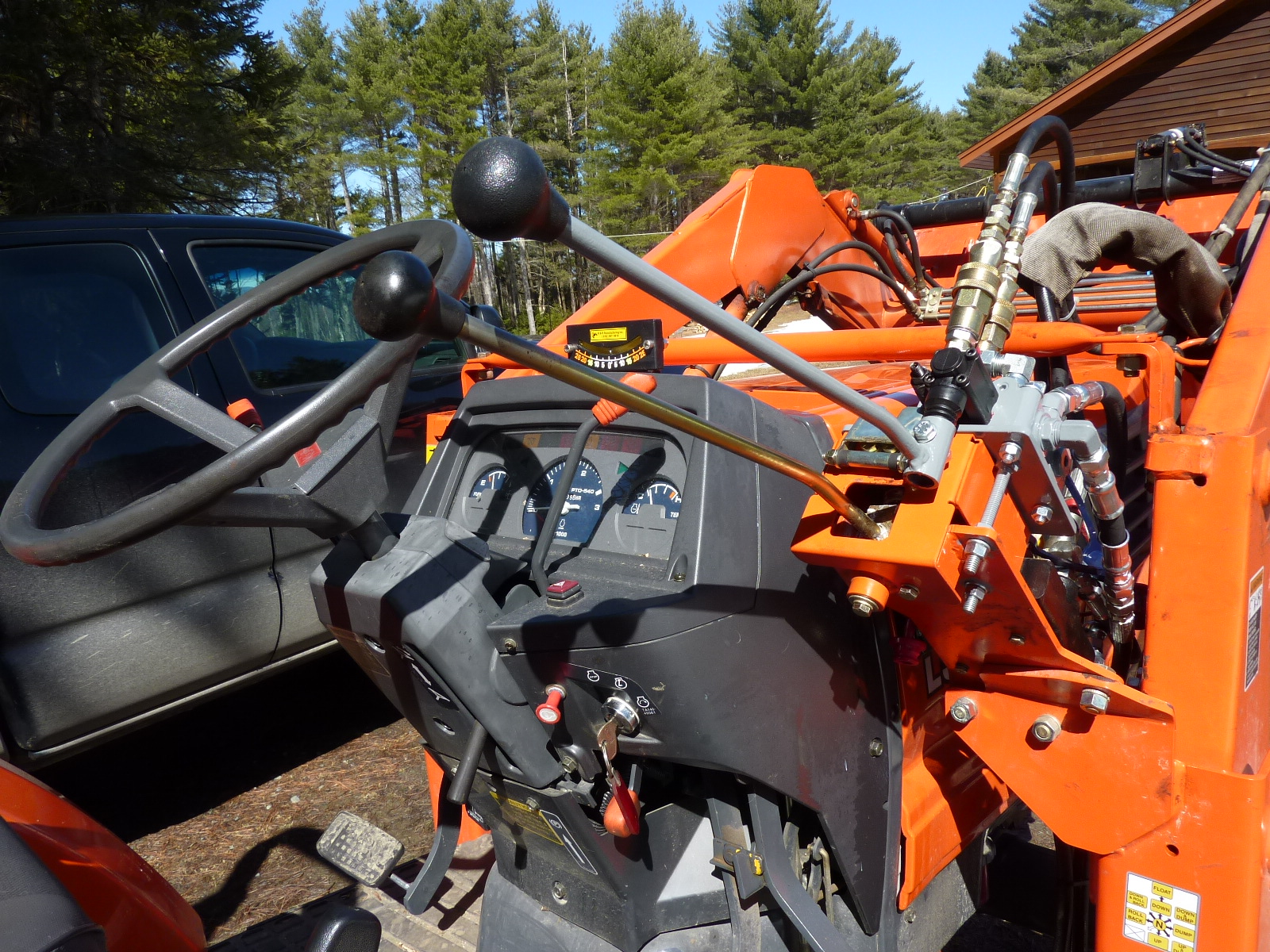

Prince has a Wolverine series, at least they used to, that are 8 gpm. I used one for my grapple. My tractor is 6.8 gpm. I got it at Surplus Center but they always have different stock.
