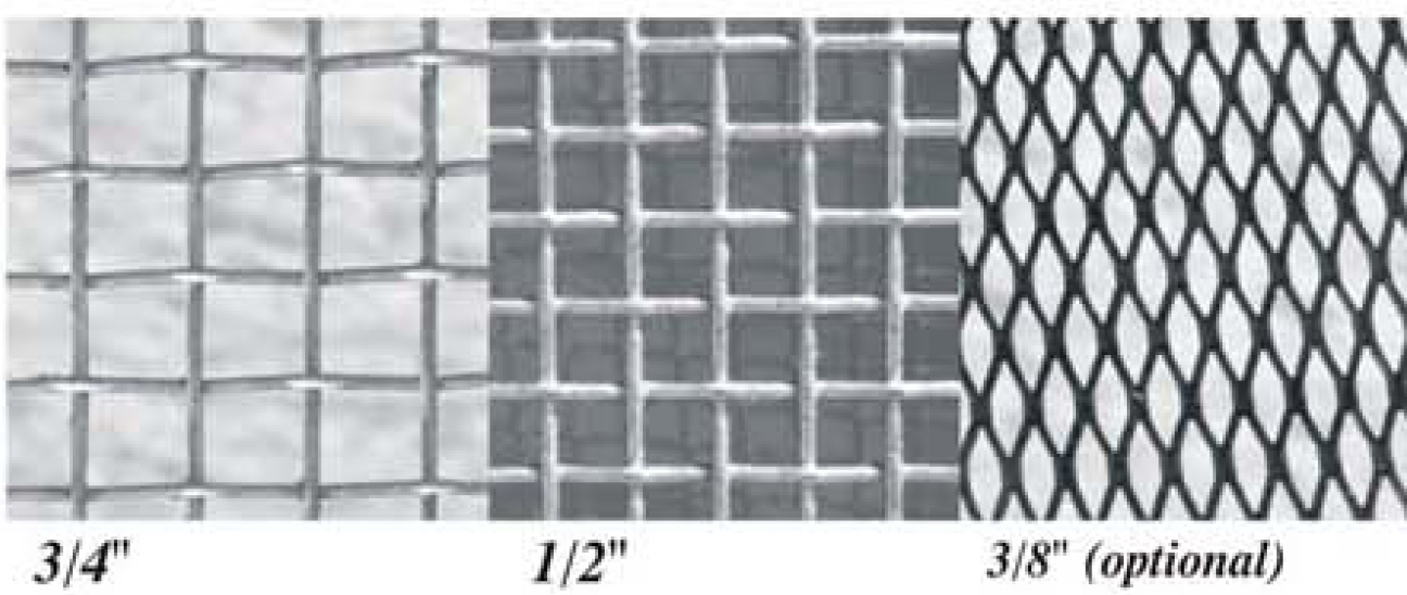

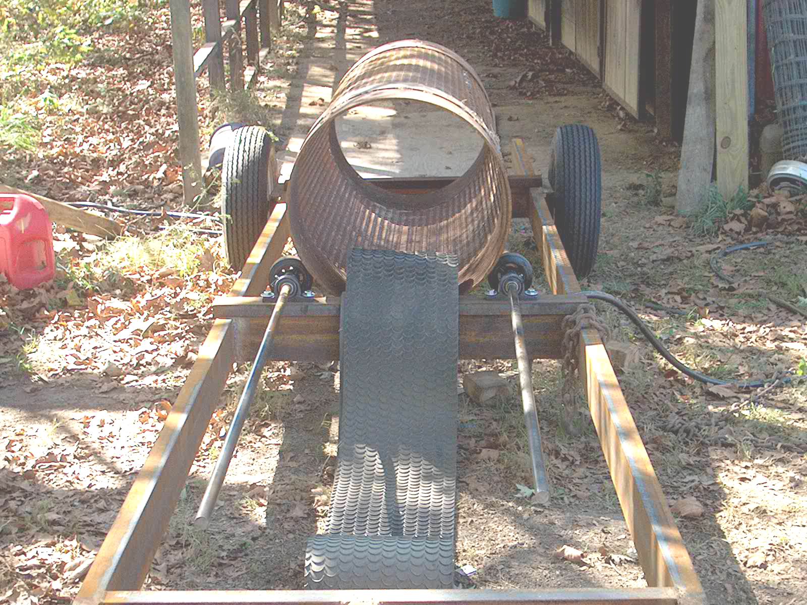

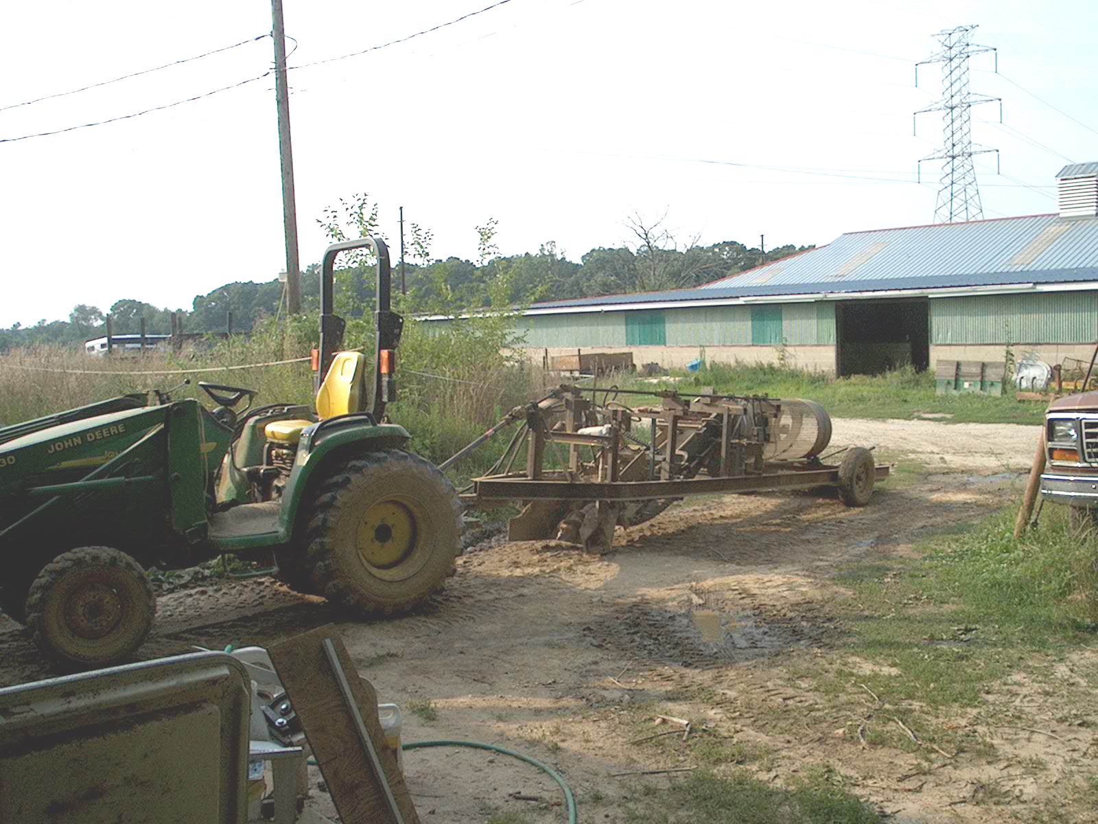

   / Looking for 1" welded wire mesh - trommel project #5
something like this?
