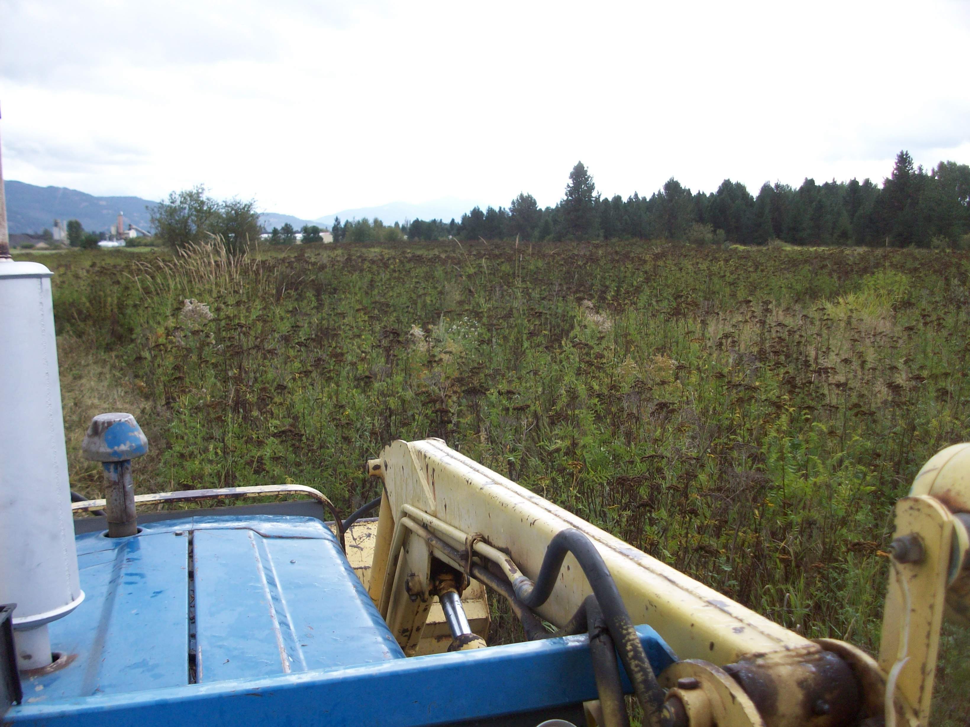

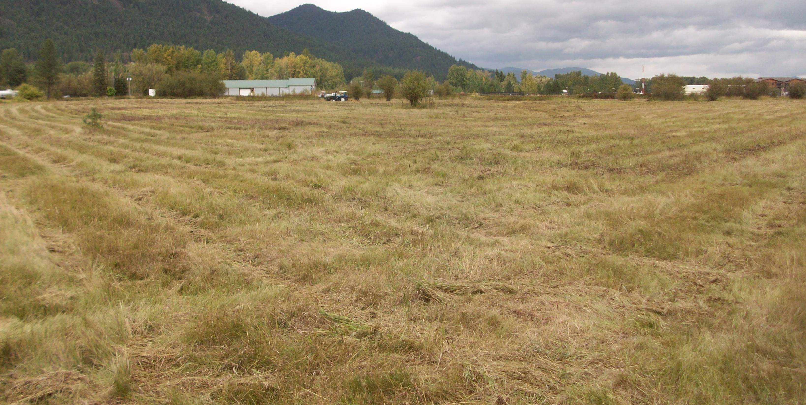

Side question- Finish mowers? Rotary cutters? If i just have a 1/4 acre of "lawn" for the girls to play what will a rotary cutter or bushog do to that? Is it that they dont cut as low? or hurt the grass? Not sure why people go this route unless they have a fairway to cut.
   / Looking at used tractors under 8K #12
in my case the rotary cutters are used for cutting the larger fields down for weed control and are really for rough cutting like this mowing Kim & Dons finished 001.jpg mowing Kim & Dons finished 002.jpg
I would not use a rotary 3 point cutter on an actual lawn, finish mowers on tractors will give a nice manicured cut - but generally you won't want a heavy tractor with ag tires for finish mowing... We use riding mowers for the lawns. As in many things- there are some trade offs depending on what the jobs are
