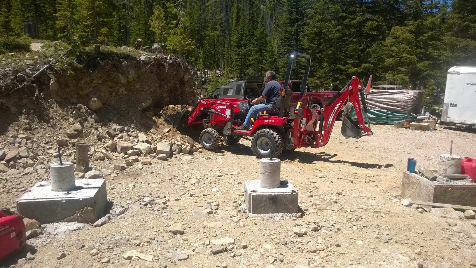

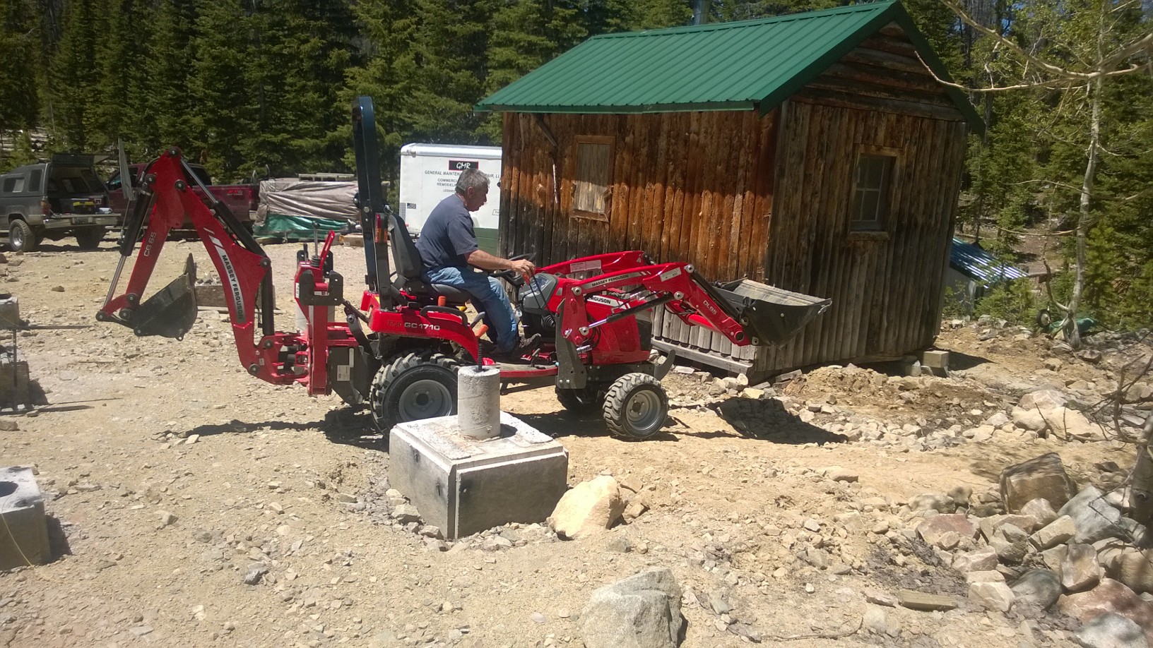

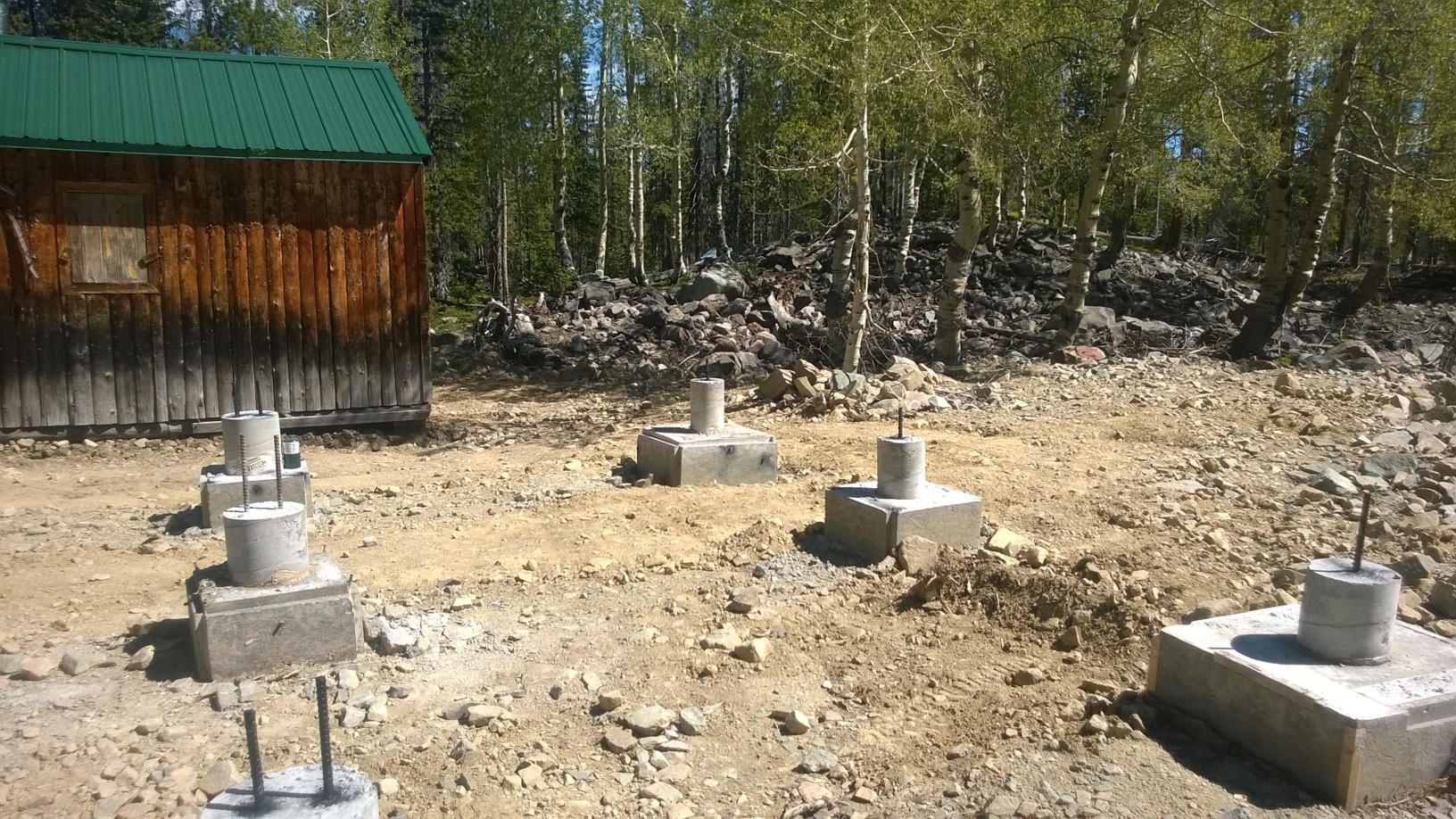

I have a gc1710, and its no slouch. I dug all these pylons with the backhoe which go down about 36 inches. Also built up a pad behind the old cabin to be able to slide it back. I even have a cat excavator and did this with the massy. It's easier to haul it up to my cabin than the heavy cat. It's a good tractor, here's my dad helping out.
   / Looking at the MF GC1720 #25
I once thought I would not use a backhoe much.. only because I had never had one maybe. Seeing these pics makes me think I could actualy find a lot of uses for it if I had it. Nice !

Snobdds, those pictures really put it into prospective why I want a small tractor, I have no interest in shoveling dirt by hand anymore, and seeing how you can get a small tractor into tight places is exactly why I'm looking for that size, my MF30B is great for the four acres behind my house but is worthless around my house in tight areas and that means I'm back to hand shoveling, no thanks I've already mastered that skill long ago.
