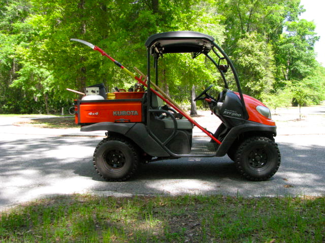

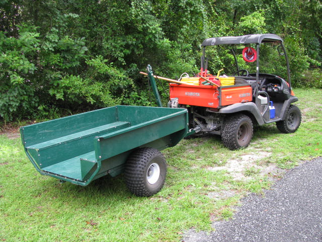

Very maneuverable. No power steering but not needed. Everyone eventually mounts a "Suicide Knob" on the steering wheel. Some mount two.
Even with loaded trailer, off-road, seldom need 4-WD, more seldom engage LSD. Very seldom engage HST/LOW. Great traction with "Turf" Tires.

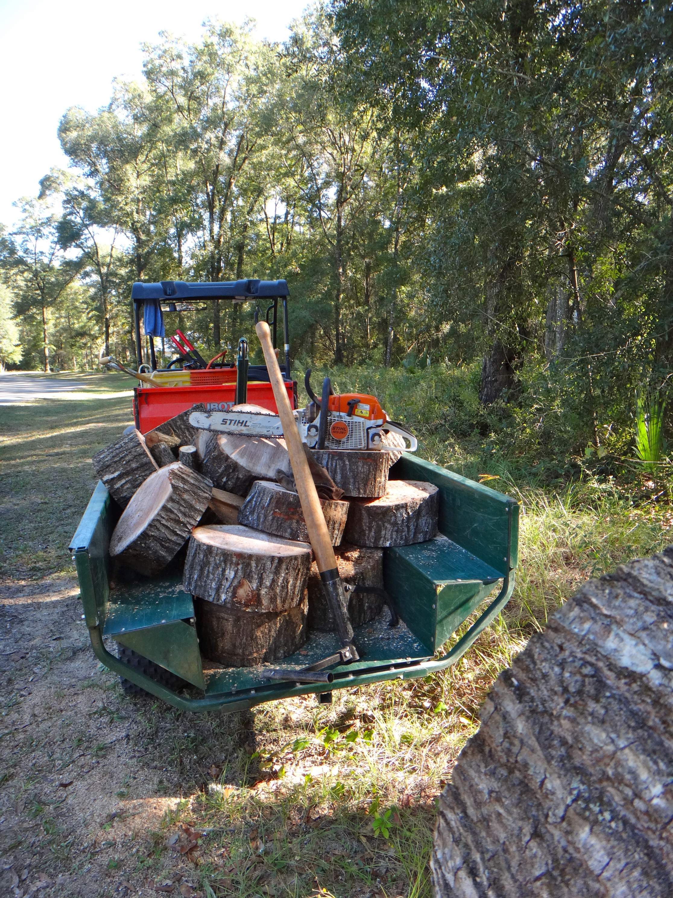

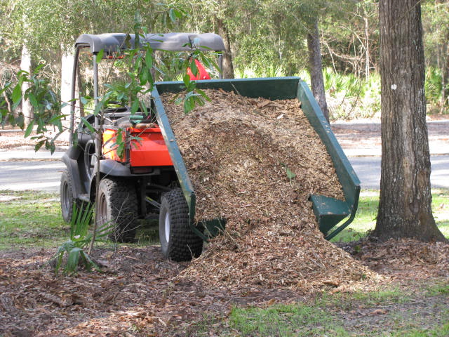

RTV500 has 15.8 hp. I pull 1,000 pounds of dirt in a trailer now and again on level, unpaved ground. That is a tribute to the excellent HST transmission more than the engine.
Is a electrical or hydraulic option available for the dump box.
Not from Kubota. Aftermarket, yes. From what I read, electric bed lifts are prone to burn out. My bed is permanently loaded with tools.
EBay is a good place to seek an aftermarket bed lift kit.
As dependable as a Kawasaki Mule, meaning very dependable. I use marine gas in mine, rather than 10% ethanol.
RTV500 is a little noisy in operation. I wear ear muffs. My 600 hour service is due. I am going to use Super UDT2 hydraulic fluid, which may quiet it down a bit.
I think optional $250 wide Turf Tires, which are really R4-Industrial Tires, was money well spent. I would order "Turfs" if you will take RTV500 on wet, mossy ramps, in lieu of 'bar' standard tires, which are R1-Ag Tires.
A 150 pound person can work standing on the optional factory roof. (Get up there, Honey. Take your pruning saw. Careful, Dear.)
Ride is a little stiff from the factory. However, springs have five adjustment positions and are easy to set to soft using Channel Lock pliers.
