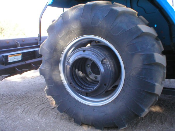

I guess that it probably depends on the wheel and who you get the weights from. My experience has been that the weights are going to weight between 65lbs-105lbs. Not to many people put on more than 3 sets, so that would be a little over 600lbs at best. Then the cost is quite high, I don't know of anyplace where it is less than $1.50 a lb and usually over $2.

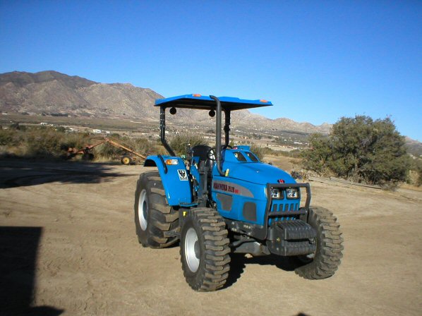

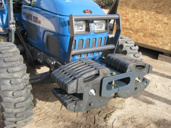

I ended up putting 6 sets of wheel weights on my 7520 along with all 4 tires being filled. It took that to get my tractor to the proper weight for ground work. That and doubling up on the front end weights. Although I could have just left the loader on the tractor, but that isn't much fun having it bouncing around when you do a lot of field work. ;) I had tried with just 4 sets and the std amount of front weight, but it just wasn't enough. :(
