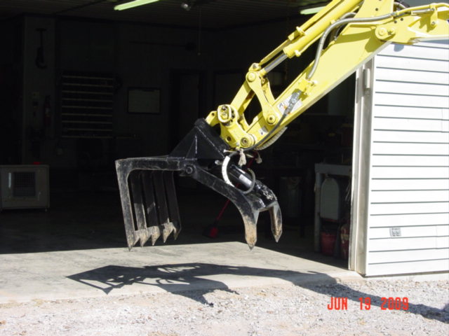

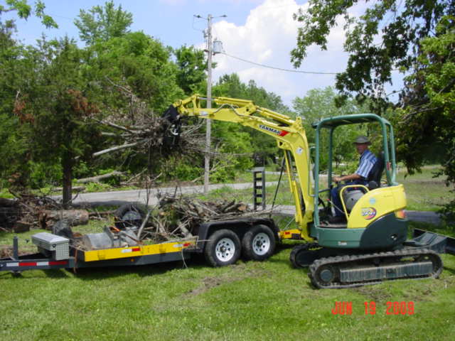

I have a Yanmar VIO-27. It isn't the smallest but for my needs it has served me well. I am a plumbing contractor. I use it to dig inside foundations and install water and sewer lines. At home I have used it basically as you describe. It out does itself every time I try something new. The one outstanding feature it has , is the hydraulic quick attach for the bucket. That aloan makes it stand out above the other three machines I had before it. I have 4 buckets and a hydraulic grapple. I can swap attachments in less than a minute while setting in my seat.
That is some nice machine with a lot of options.
