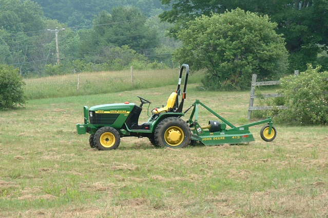

SuesApples,
Attached is a pic of my 4100 with a JD 413 4 foot rotary cutter. This would be the type of setup you would want to do the cutting you've described.
I guess you can say it's "outstanding in its field". /w3tcompact/icons/smile.gif
I have the hydrostatic transmission (HST). Infinite ground speed and real handy when you need to make a lot of direction changes. The 4100 narrow model is a collarshift gear trans only.
The standard ROPS height on the 4100 is listed at 76.7" with R1 tires. Deere doesn't list a folding ROPS as an option on the 4100 but there is one shown in the parts catalog for the Europeon model. Having a folding ROPS might be something else you may want to consider around all those trees.
