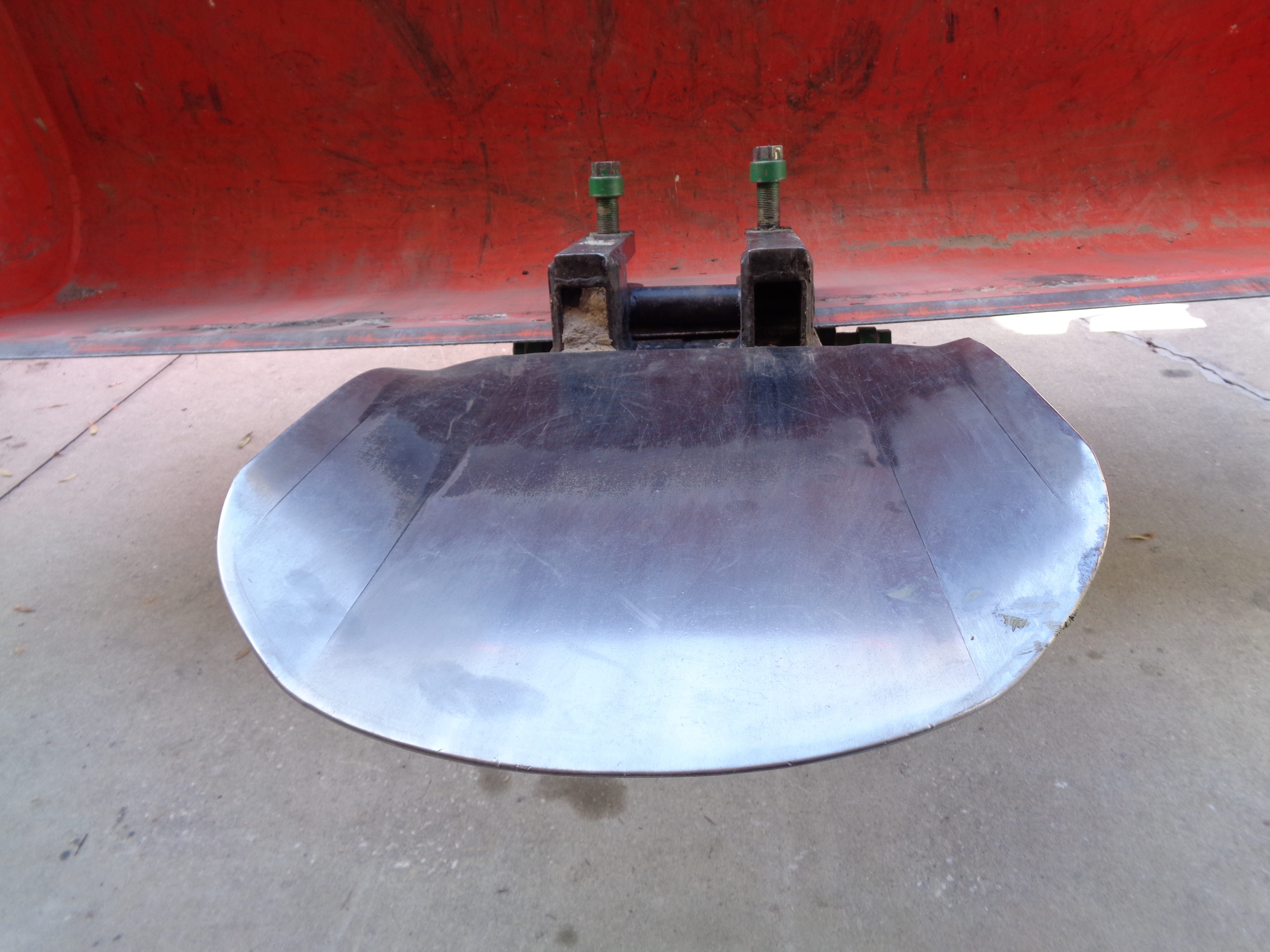

If you need a $6,000 - $7,000 Backhoe, buy one. A Bucket Spade costs $400.
