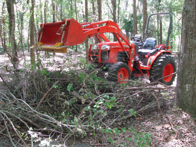

The B3300SU is a nice machine. It is LIGHT for its horsepower. Because it is light and because of the large tires, it feels a little unstable during heavy work; any 2,500 pound tractor-loader will feel a little unstable under same conditions. My present L3560 is only a tad larger than the B3300SU but has twice the weight; it is VERY stable.
Large tires make B3300SU mobile in the woods and crossing plow furrows.

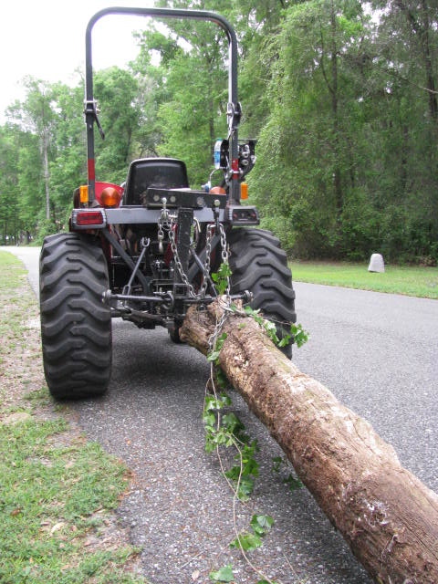

B3300SU has a Cat 1 Three Point Hitch but the space around the hitch is somewhat restricted. You cannot pull a full size 2/12" moldboard plow because of the restricted space. Plows designed for B series size tractors are available.

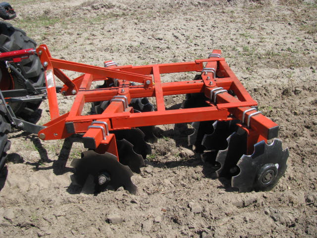

The heaviest Disc Harrow you can pull is one with 18" diameter pans, which generally has just under forty pounds bearing on each pan, the lightest Disc Harrow which is really effective.

A $300 Ratchet Rake for the bucket is the single most useful attachment for a B3300SU. Great for light grading and brush removal. You will also want two or three 5/16" bolt on chain grab hooks for the bucket.
