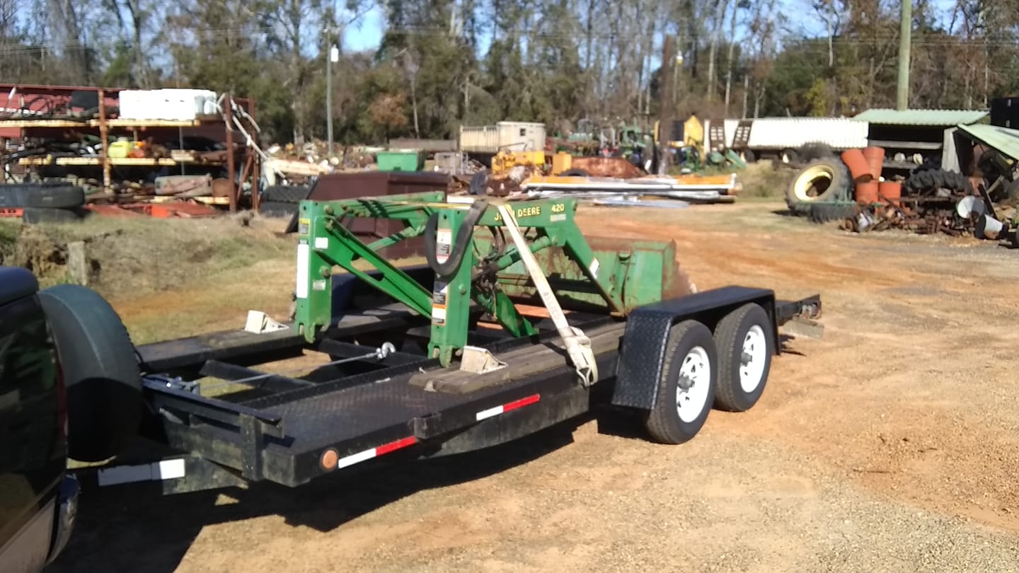

Looks straight enough. Quick disconnect bucket holes are worn and bucket cylinders missing. I was told about the cylinders beforehand so no surprise on those. Got it for $1200 so I should be okay on it. Price included all the frame mounts and the grill guard. I plan to upgrade all the cylinders to mimic the 430 capacities and height. I can cut and weld some bushings in the worn holes on the bucket.

It looks like it sit "straight" on your trailer. Nice find.
