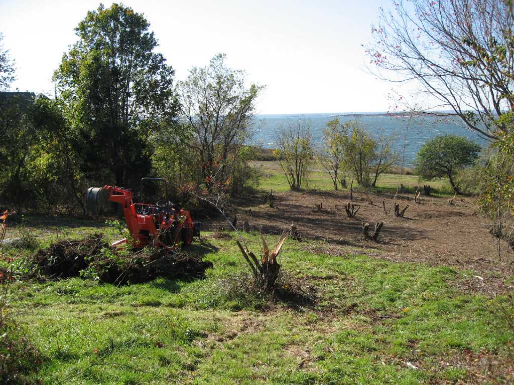

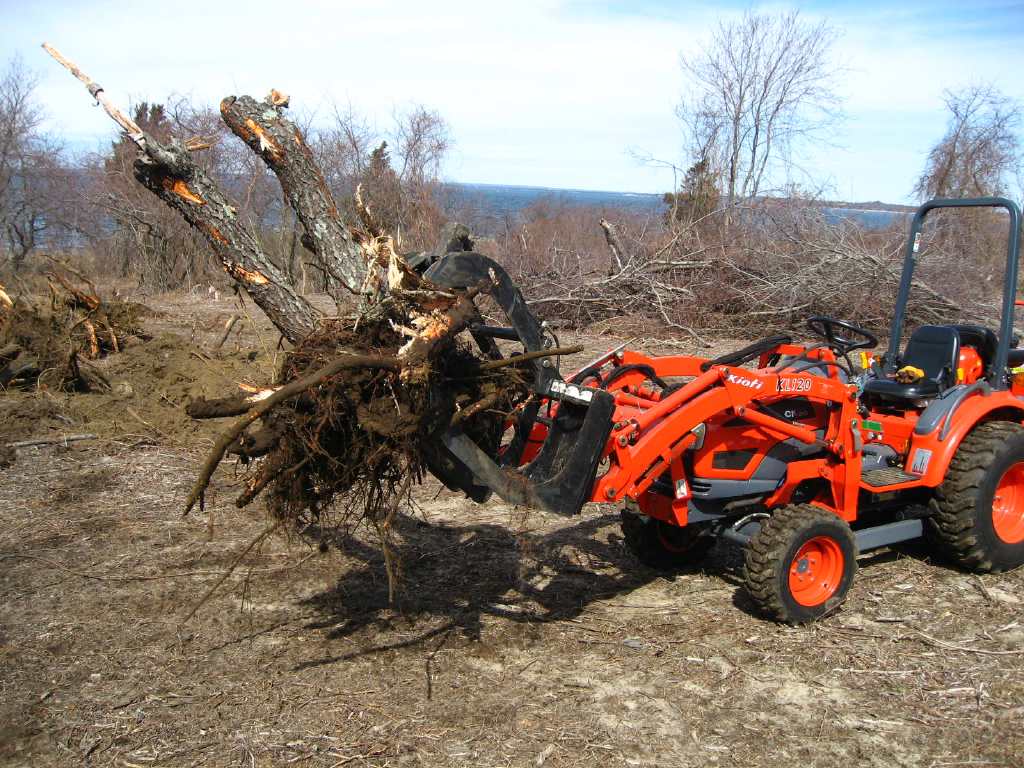

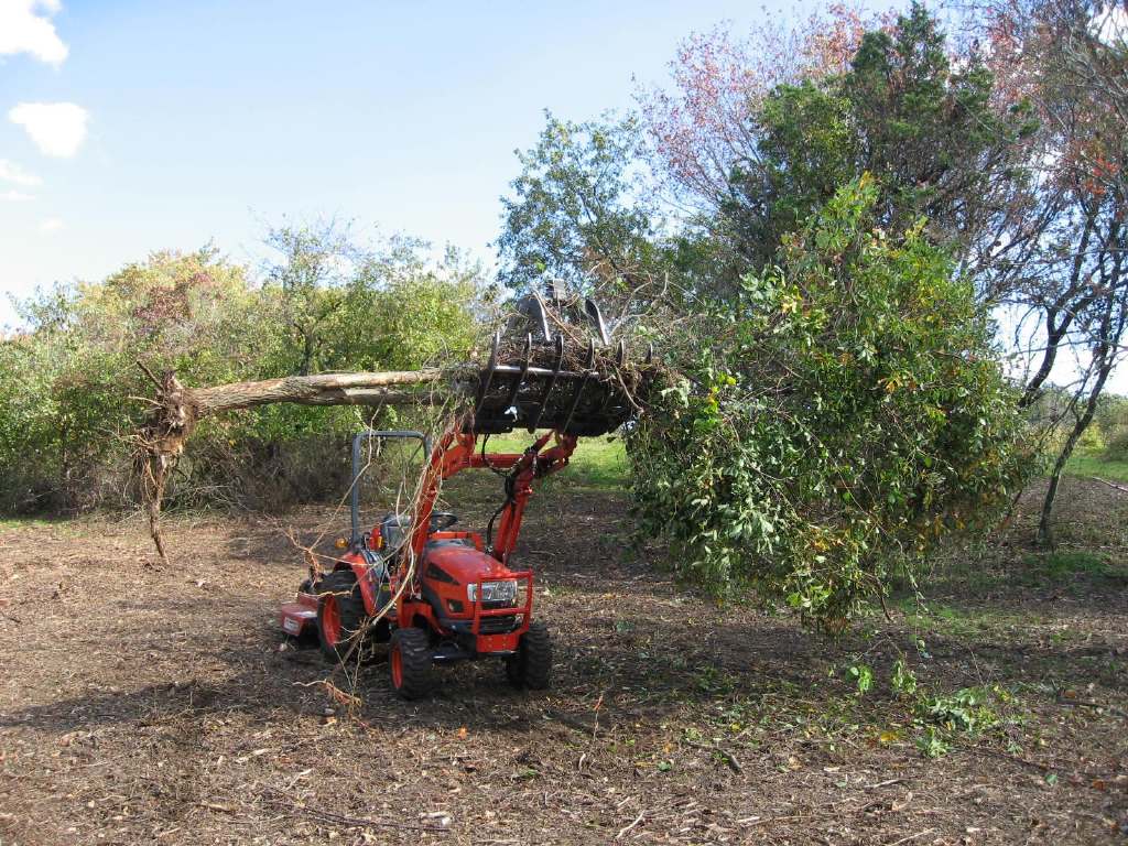

Can your 28hp mower do this? :laughing:
My CK20 was only 20hp. My complaint was mostly about the lack of a third range (mid) for the HST. My mowing speed was slow only because I had to travel in low, I don't recall problems actually cutting grass efficiently. It did fine otherwise and did most of the work in clearing three or four acres of brush, stumps etc.
I agree 20hp ain't much but the CK20 gets a lot out of those 20 horses.
