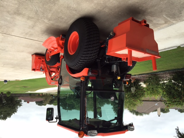

I have had my B 2650 for almost a year and really enjoy the comfort from heat, dust and bugs with the cab. I had asked my dealer about spacers and he told me known were available for this tractor. As for noise I wear Bose Quiet Comfort head sets that cut out the noise but still let me hear voices and the radio. Besides it bluetooth to my phone.
Attached image of my tractor shows the ballast box I made. A basic Kubota box filled with concrete and the two pieces of PVC allow me to holster a shovel and rake safely and out of the way. Yes, I have holes in the bottom to allow any water collected in the tubes to drain. Another must have option is a fire extinguisher the cab. I also installed a rear camera which reminds me I need to order a new dashboard monitor for it. Enjoy the new tractor
   / Looking at a new B2650 w/Cab #7
Would someone please tell me how an image right side up gets uploaded to the forum upside down
   / Looking at a new B2650 w/Cab #8
You must have taken that picture with an apple product? That's why the thumbnail is upside-down but the other is rightside-up.

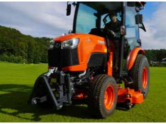

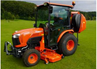

I wish we could get some of the European options on the b2650, they have a front 3pt hitch, then I could just hang my weight rack on the rear or front 3pt, depending what task's I'm doing.
Screenshot 2017-09-21 at 10.40.18 AM.jpgScreenshot 2017-09-21 at 10.41.31 AM.jpg
The Wheel spacers were available dealer installed 1.5".
