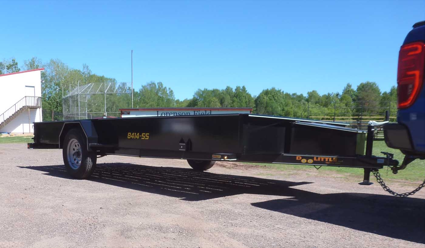

We have been reasonably happy with our do-little trailer. Its in your weight class and I do have a review of it somewhere here.. No brakes.
