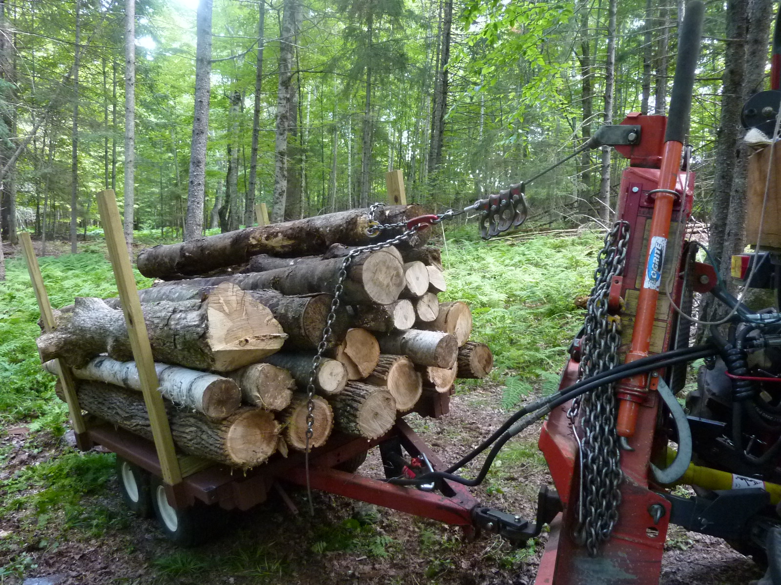

Looking for a DIY hitch so I can pull my log loader trailer attached to winch and then attached to tractor.
I have a clevis style hitch on the log loader and that attaches to the winch . I have a roll hitch on the loader . Loader can roll over if need be tractor stays on wheels. When I turn left and right clevis on winch to trailer can turn as the clevis hitch allows that.

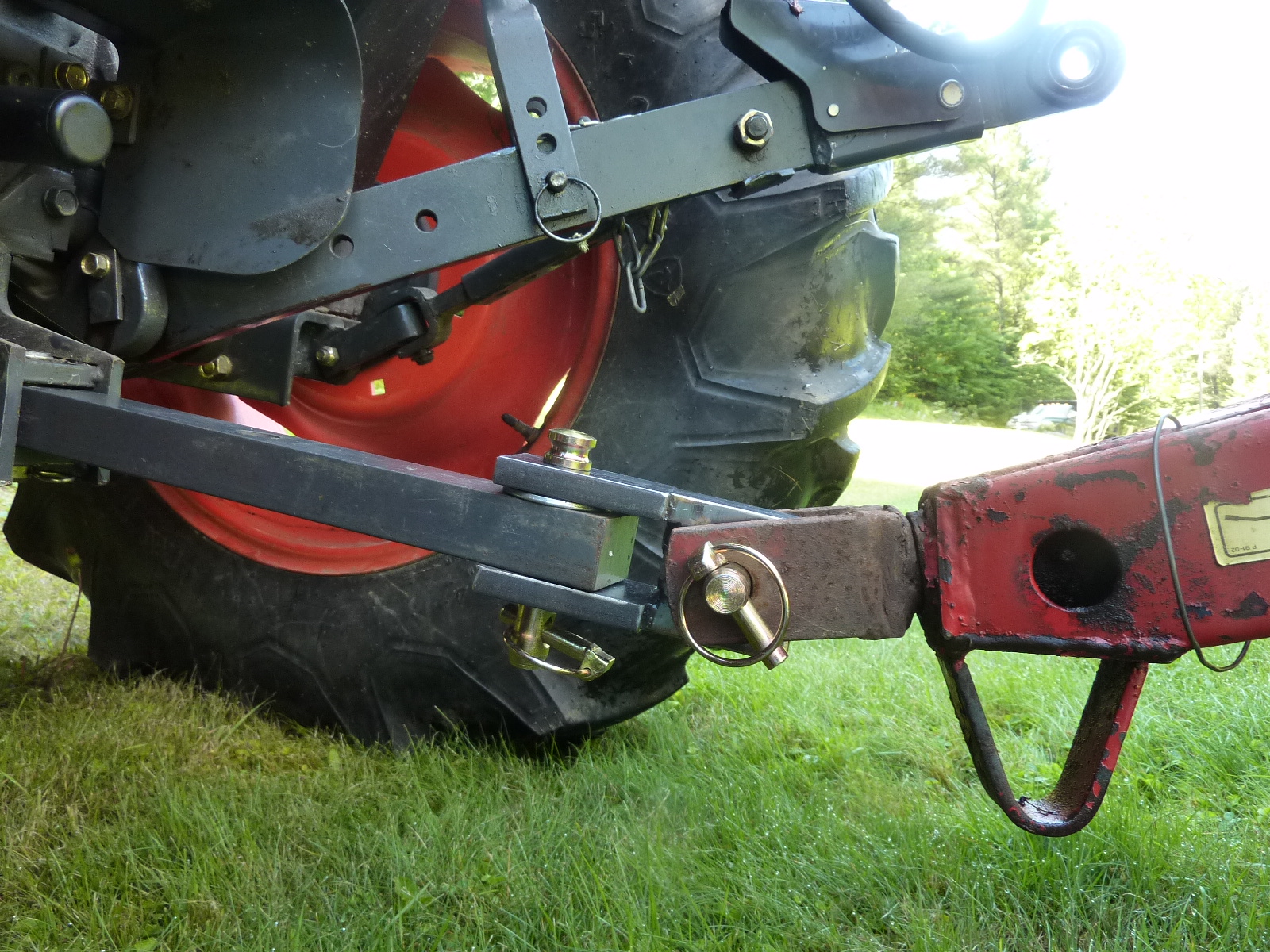

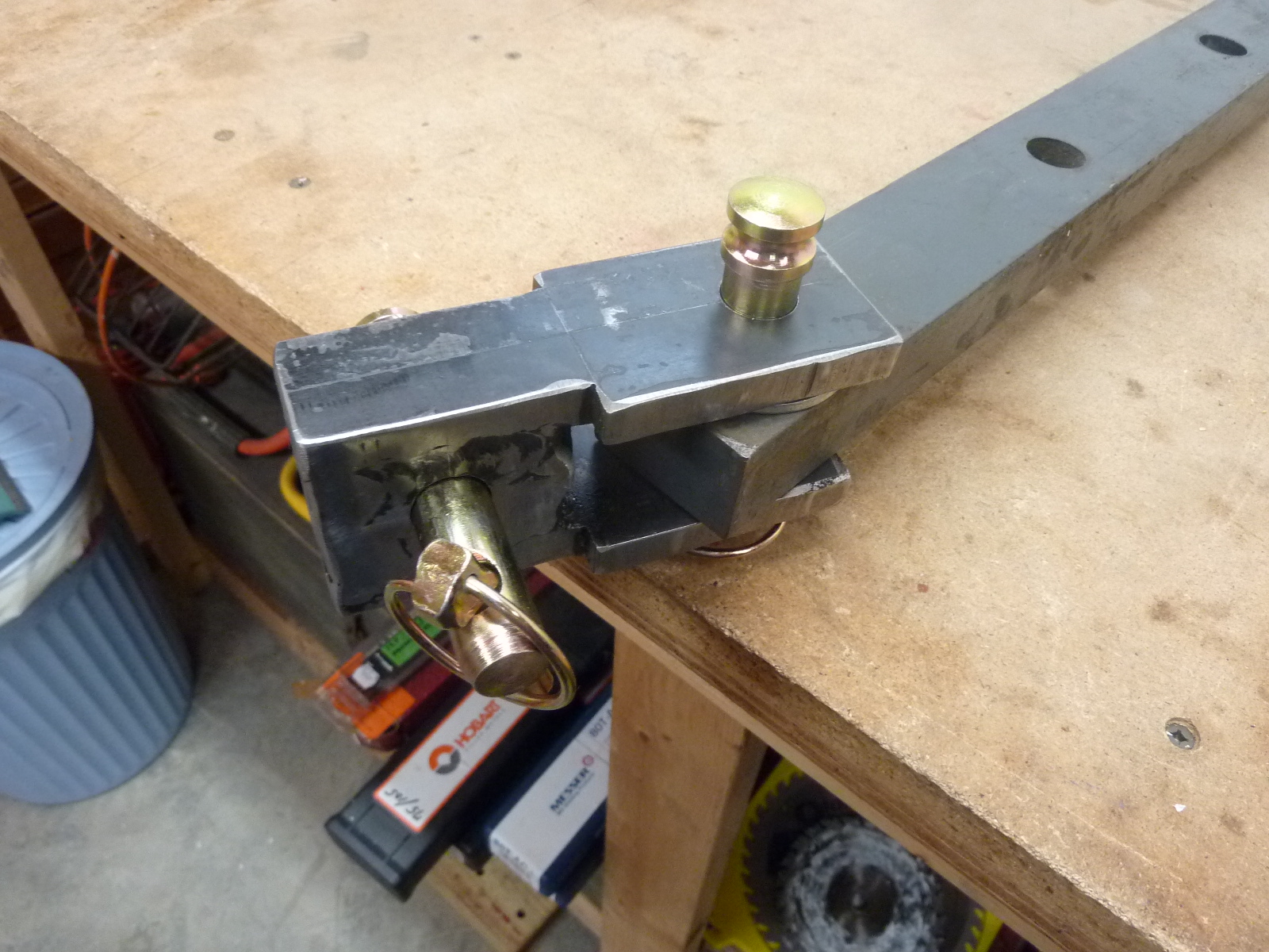

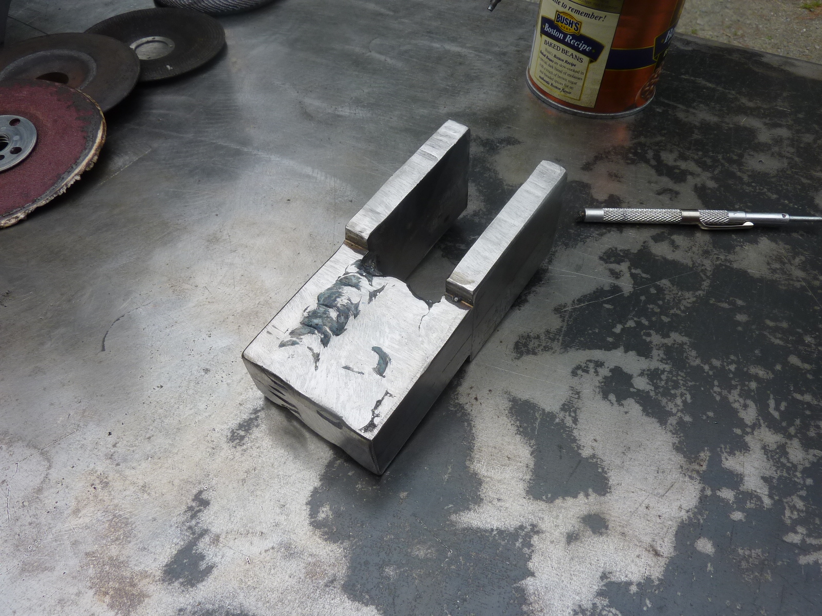

I made a swivel hitch for mine. Sandwiched up some pieces of 1/2 and 3/8 plate.
gg

Make a drawbar with a 3pt hitch draft link/lift arm end. Then your trailer's clevis hitch can handle moderate dips and bumps without bending the pin.
