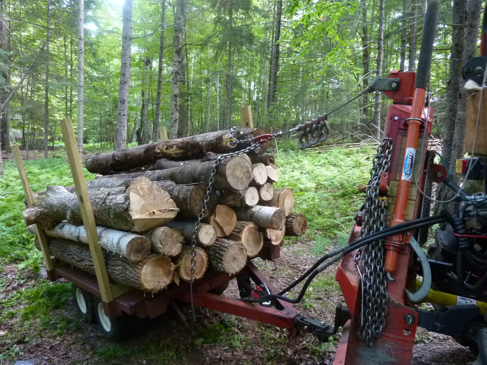

Hello again been gone a long time from this site.
Looking for a DIY hitch so I can pull my log loader trailer attached to winch and then attached to tractor.
I have a clevis style hitch on the log loader and that attaches to the winch . I have a roll hitch on the loader . Loader can roll over if need be tractor stays on wheels. When I turn left and right clevis on winch to trailer can turn as the clevis hitch allows that.
My issue is when tractor goes down a low spot or over a hump I continually bend the pins in hitch as there is no movement in that direction.
Thought I had it all worked out I would roll the trailer hitch 90 deg so the pin goes in from the side rather then down The trailer hooked like this would still allow a rolling action But now I cant turn the tractor left or right.

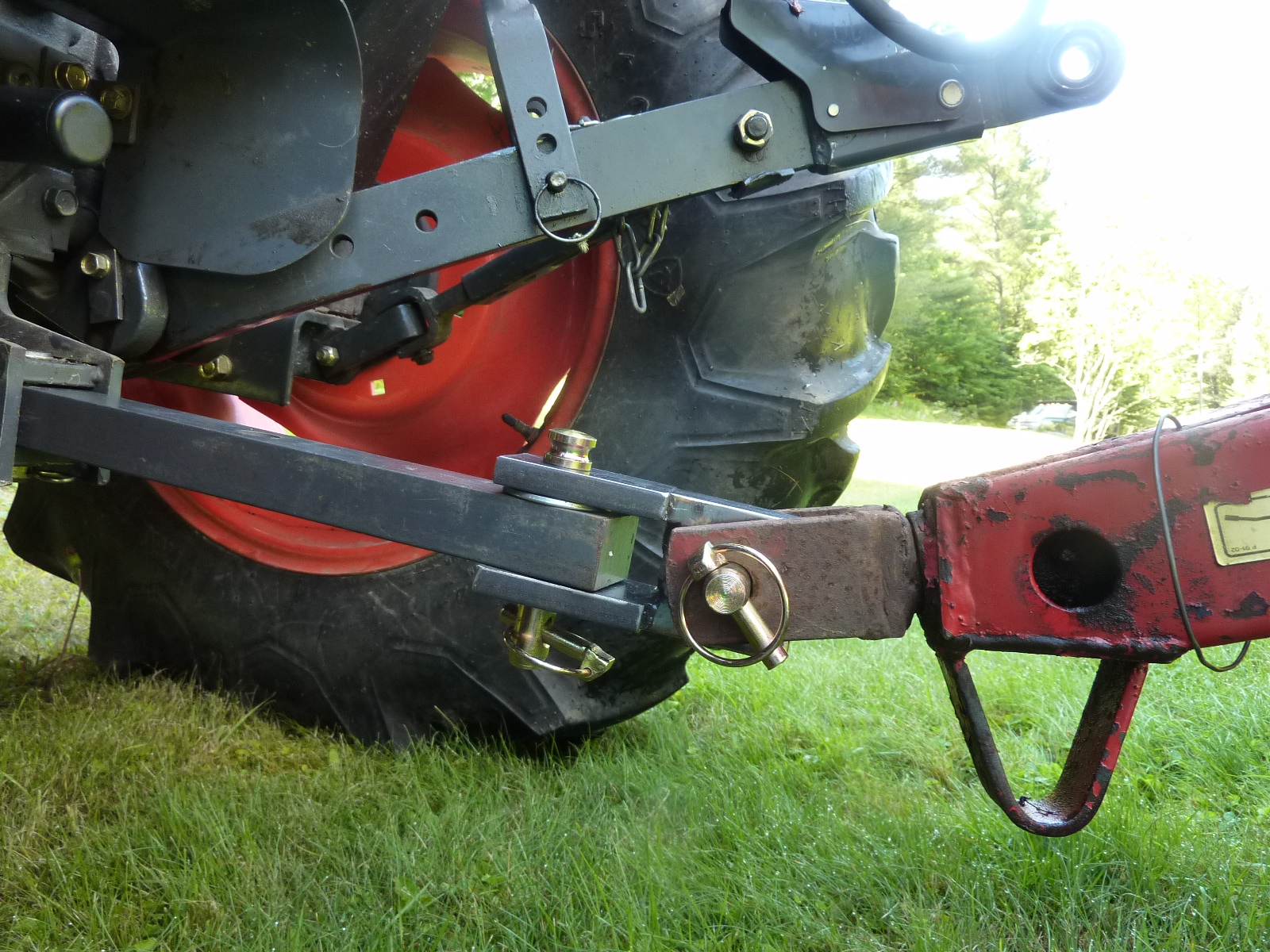

/ Looking a DIY hitch idea #3
Seems to me you answered your question with the clevis you use elsewhere in your setup. If you can put a pin in you should be able to pin in a clevis and it should provide up, down, left and right travel.

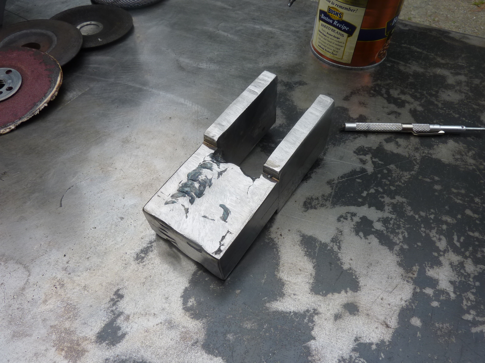

/ Looking a DIY hitch idea #5

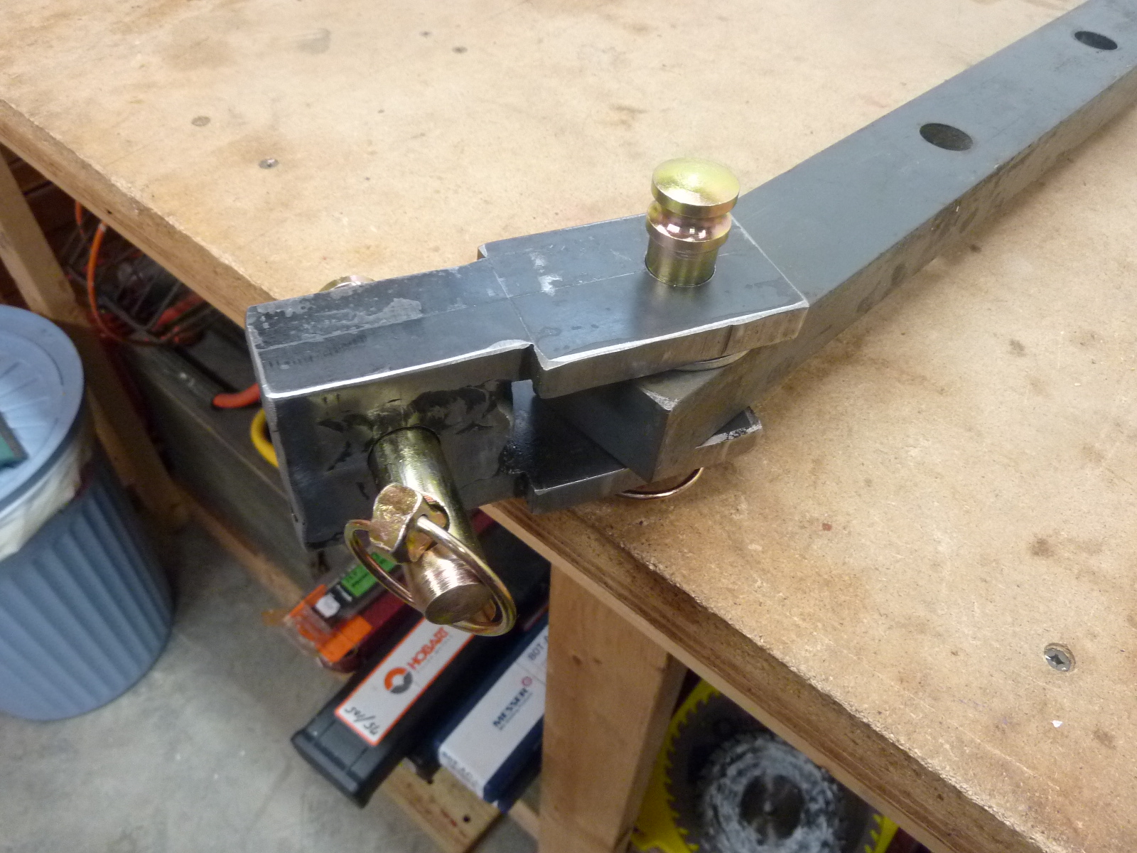

I made a swivel hitch for mine. Sandwiched up some pieces of 1/2 and 3/8 plate.

/ Looking a DIY hitch idea #7
Make a drawbar with a 3pt hitch draft link/lift arm end. Then your trailer's clevis hitch can handle moderate dips and bumps without bending the pin.

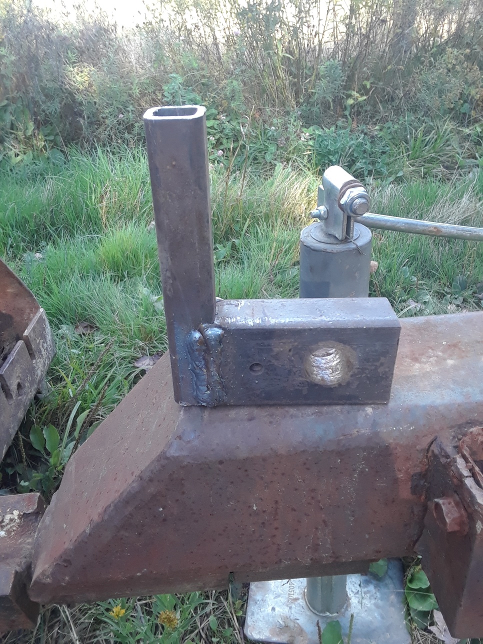

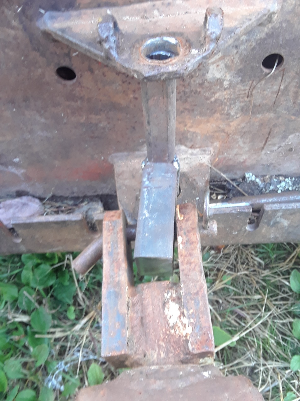

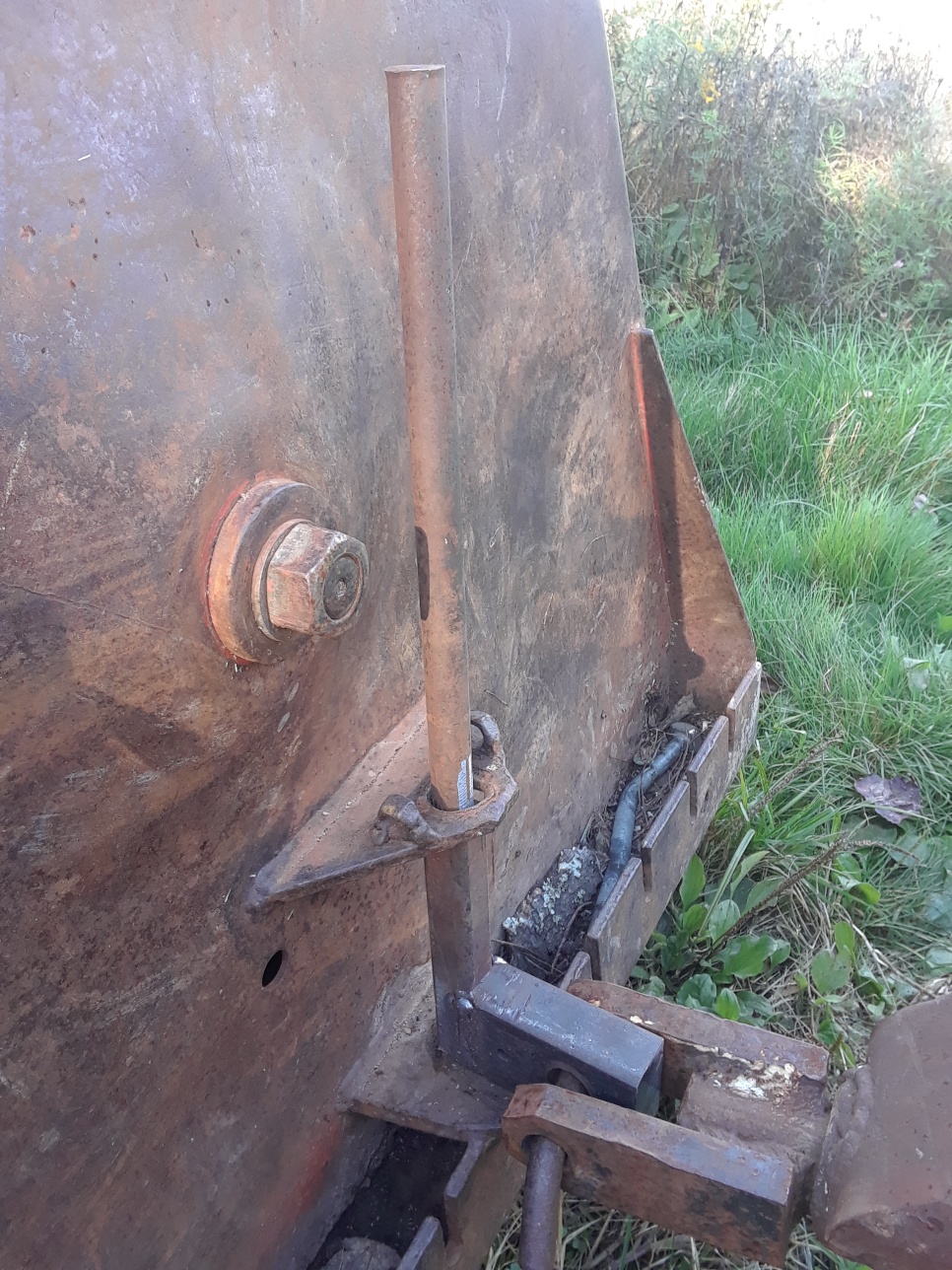

#16

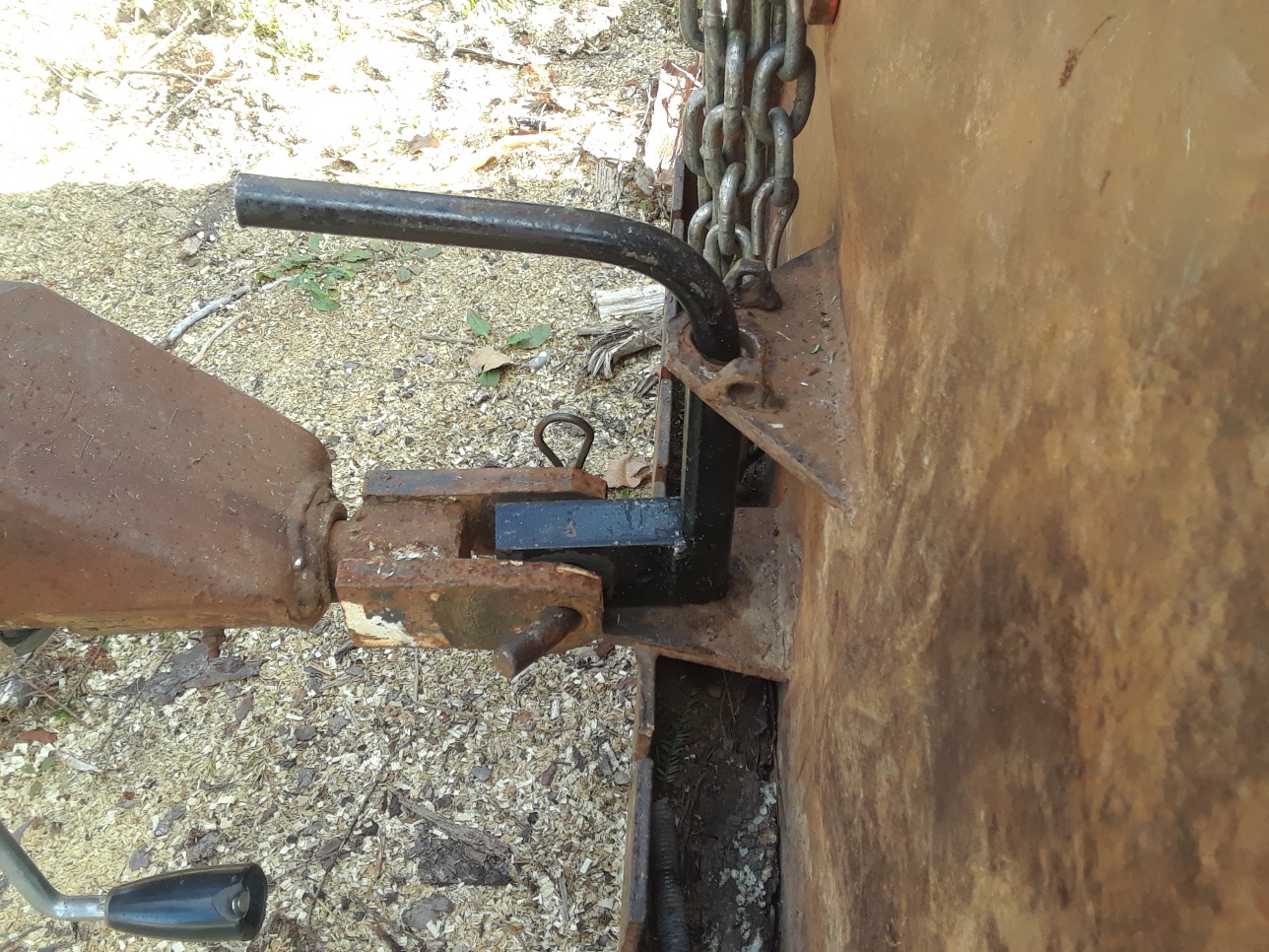

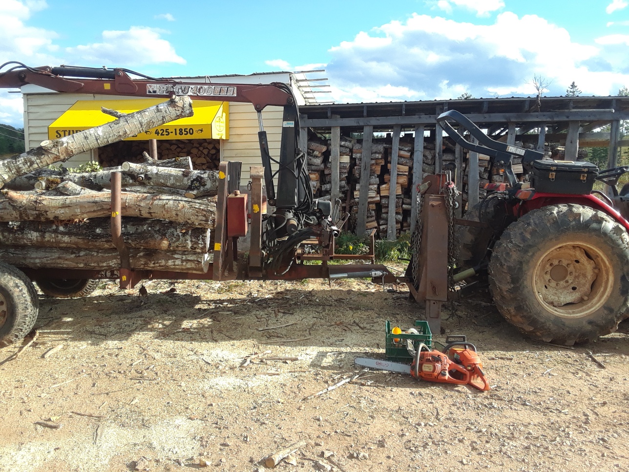

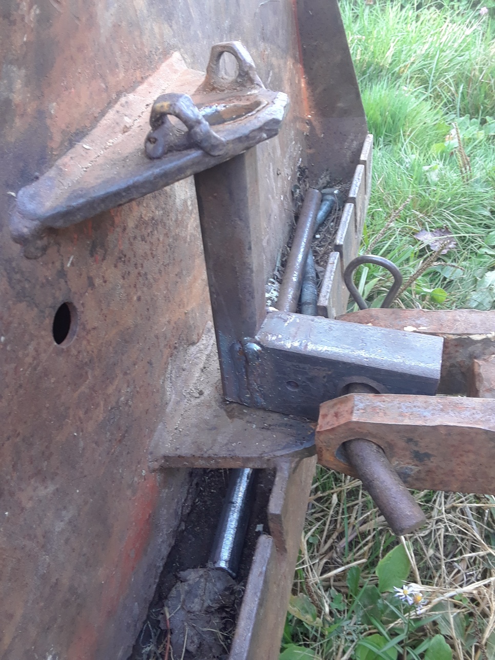

So here is my hitch .
Like everything here It made half *** as a test but if it works will be here along time.
20201001_161727_resized.jpg20201001_161739_resized.jpg20201001_161754_resized.jpg20201001_161841_resized.jpg
Goes along with minimal noise back there.
/ Looking a DIY hitch idea #17
You have all the ranges of motion covered now. :thumbsup: Give it a test run.
