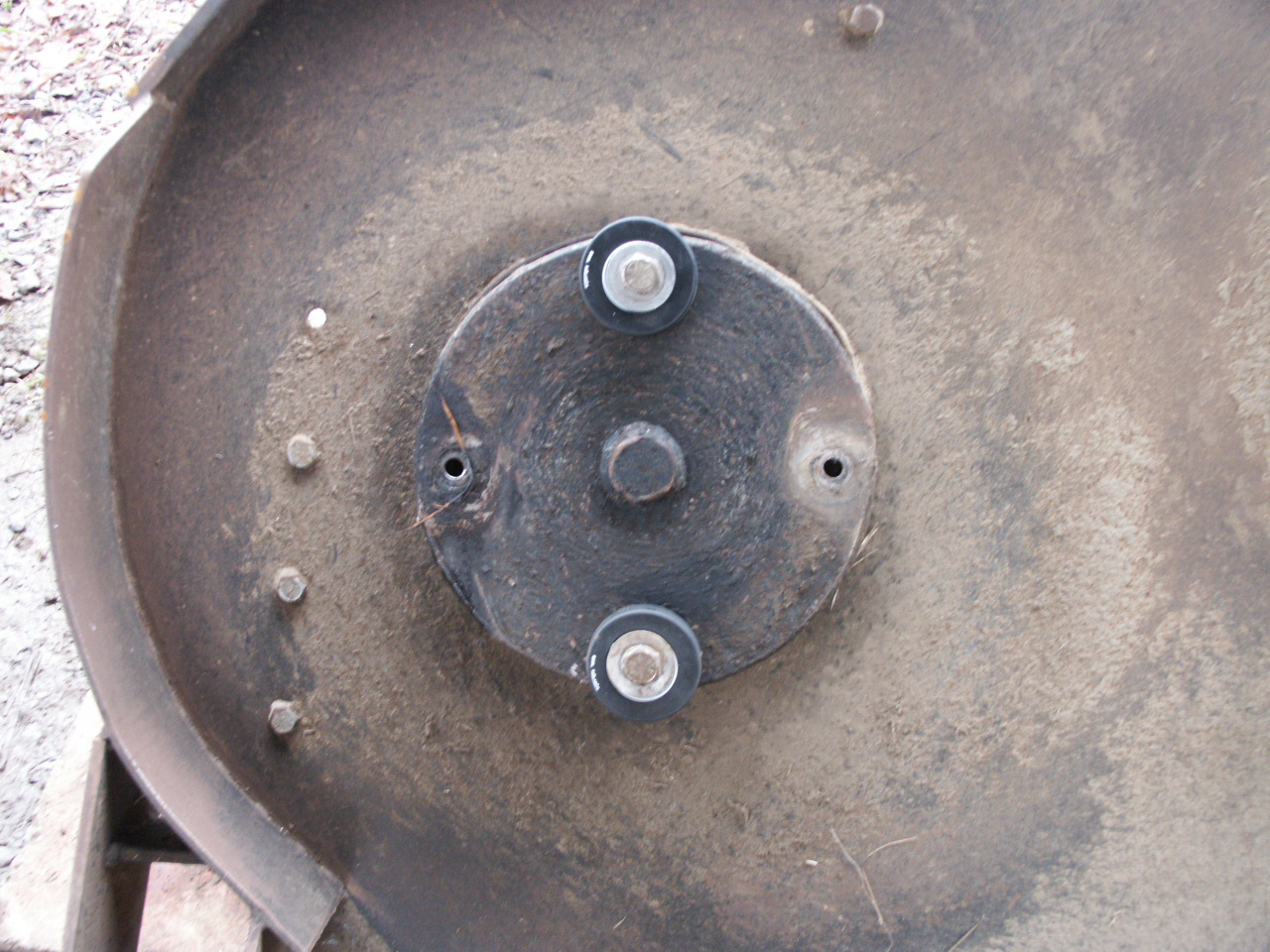

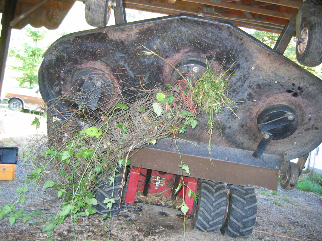

Also like the attachments it comes with. Everthing we'd need (ex. a Power Rake). We do need the Boom mower and Stump cutter. The 4n1 bucket will be good to have but were still gonna buy a standard 60" 9cu ft Bucket. The 90" mower will be great for Brush hogging and Mower large lawns (and gets the smaller ones done faster :D).
How does the 90" mower cut on lawns when changed to a Finish mower (Finish Cut spindles)?
   / Lookie this!
??? Never heard of this. Something Terry recommended? Swapping the spindles would be no fun in my book.
The standard 90" Rough Cut mower comes with 3 Stump Jumper spindles for when your mowing Tall Grass, Weeds, and small brush. These spindles can be changed to Regular Finish Mower spindles and hass standard Mower blades. This set up is for mowing lawns.
   / Lookie this! #8
I am going to step out on a limb on this one. Take a look at the picture below. Now, I only know my little lawn mower and have never seen the underside of a grass mowing tractor mower. One thing I learned here was that the blades need a bit of lift built into them to cut grass better. Also, from what I can tell on my little gas powered mower, the body of the mower deck is designed to help with that suction. If you look at the bottom of the PT deck, well, not much design work for airflow. I had custom blades made for my PT, hardened, and then the edges upturned. I guess the mowing of grass is a bit better due to the suction, but I will tell you the amount of dirt I now have to breath is impressive.
