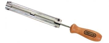

Thanks agreed its a pain having to drop them off and wait. i have 3 - 20", 4 - 25" and 4 - 36" loops so its not usually a problem just really annoying when you find you paid for nothing.
LOL i'm hoping to retire that method i've been using one for years. I don't mind it much but 25" loops have a lot of teeth and seem to take forever. I run full skip on the 36" and they only have a few more teeth than a 20" but still take forever.
I've had one of these for years. The hydraulic feature is really neat, but I have had to replace the hose a couple of times. I also use a plated steel grinding wheel to cut the teeth. It doesn't ever have to be re-shaped. Also consider setting up an air stream to cool the teeth as you grind them.

nice grinder for sure, i have a grinder i've been using for about 30 years now, dont have the heart to replace it.
By any chance is your grinder mulit directional? If it is, well, when i grind chains i spin the wheels direction in the direction of the high edge of the cutter. When you file a chain you file from the low side to the high side of the cutter pushing away from you each stroke, thats the way i run my grinder. Just a thought. I grind from 6 -30 chains a week. Ours go from 18" to 42" with Actually it relaxing for me. Yesterday i just cleaned the grinder and realized it was supose to be orange! . . .imagine that. :cool2:

Well I finally broke down and ordered and Oregon Heavy-Duty Bench Grinder with Hydraulic Assist. For years I've retouched loops by hand several times and then eventually take them in for sharpening. The last two times I've taken loops into the local saw dealer they've messed up a total of 5 loops. At $6 for the 20" loops and $7 for 25" I've given the dealer $33 to take my dull loops and make them duller (they might have cut butter without smoking). They have a high school kid who was not properly trained screwing up chains. I keep my rakers cut down and in spec, I have had to sharpen these chains by hand to be even useable. You could tell they had been run on a grinder but they were not not sharpening the full chisels to a point the chain needed to be pushed further forward into the grinder.
Now i just need to make some room in the barn to mount this bad boy. I would have really loved a Silvey but used ones don't come up very often and the new price for an amateur like me is insane.
These sharpeners are the real deal. I've owned mine for 10 yrs or more & used it many times over. Still on the same sharpening wheel.... My opinion,,,,,They are a great tool to have!!

Yes, I got mine from the same place, I think. It was about 25 years ago. I used it commercially for at least 10 years, until I sold my small engine business and have used it for my own and friends chains ever since. Lasts forever. That's the reason I have the cooling air stream. Keeps the teeth cooler when you are cutting and also protects the CBN abrasive from getting hot and makes it last longer (I think). I'll try to get you a picture this weekend when I am in the shop. It's a really simple set-up.
The one negative to the steel wheel is that the spring on the grinder is not really tight enough to bring the grinder to the fully up position, when you let it go. The best part is that you don't have to hesitate about hitting the tooth with the grinder for the full time it takes to sharpen, as opposed to the vitreous wheels which you have to use very tentatively to avoid overheating (burning) the teeth as you sharpen them.
