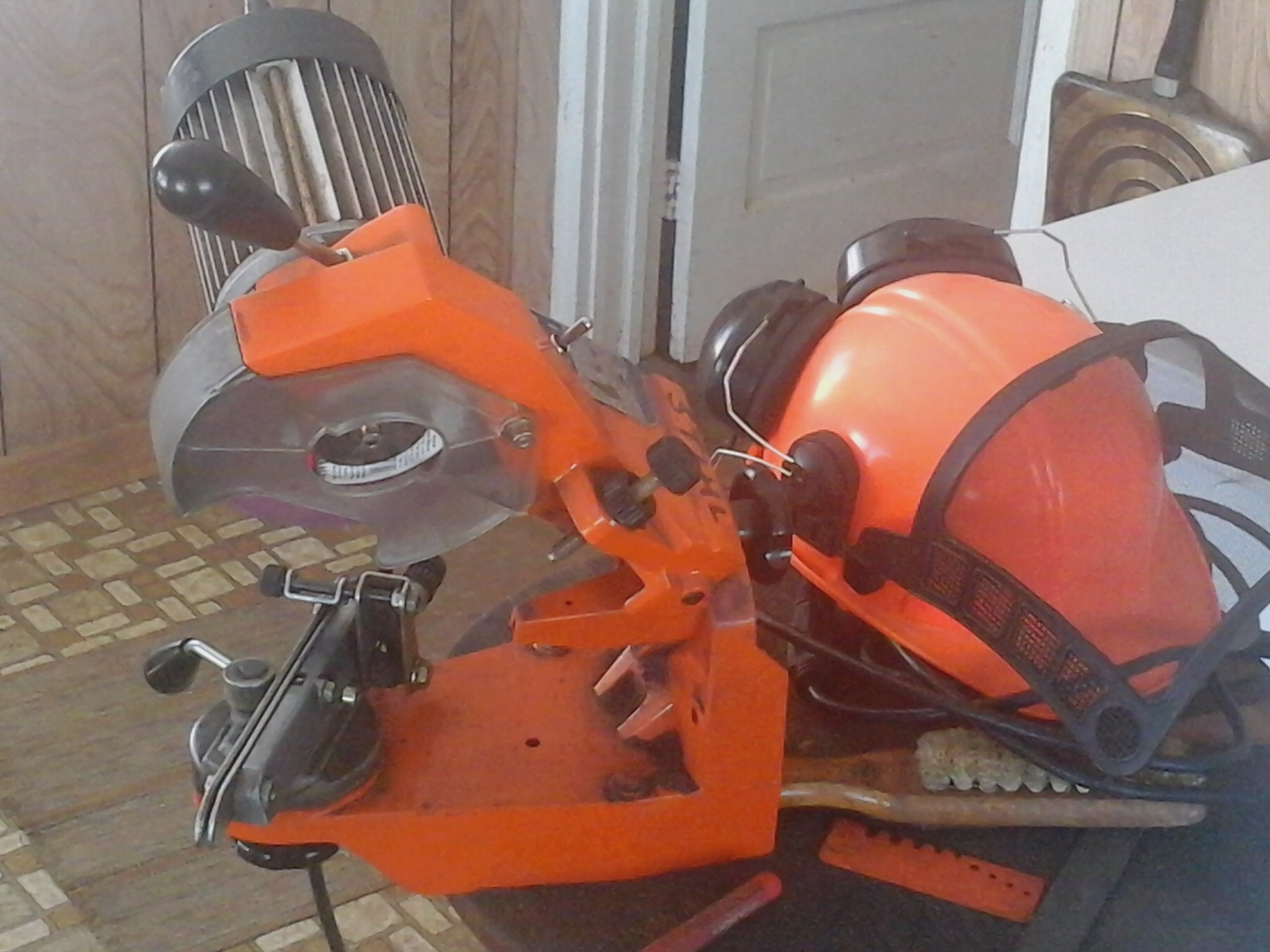

nice grinder for sure, i have a grinder i've been using for about 30 years now, dont have the heart to replace it.
By any chance is your grinder mulit directional? If it is, well, when i grind chains i spin the wheels direction in the direction of the high edge of the cutter. When you file a chain you file from the low side to the high side of the cutter pushing away from you each stroke, thats the way i run my grinder. Just a thought. I grind from 6 -30 chains a week. Ours go from 18" to 42" with Actually it relaxing for me. Yesterday i just cleaned the grinder and realized it was supose to be orange! . . .imagine that. :cool2:
My next purchase is a chain beaker and rivet spinner so we can make our own chains.
Enjoy your new grinder . . .John
