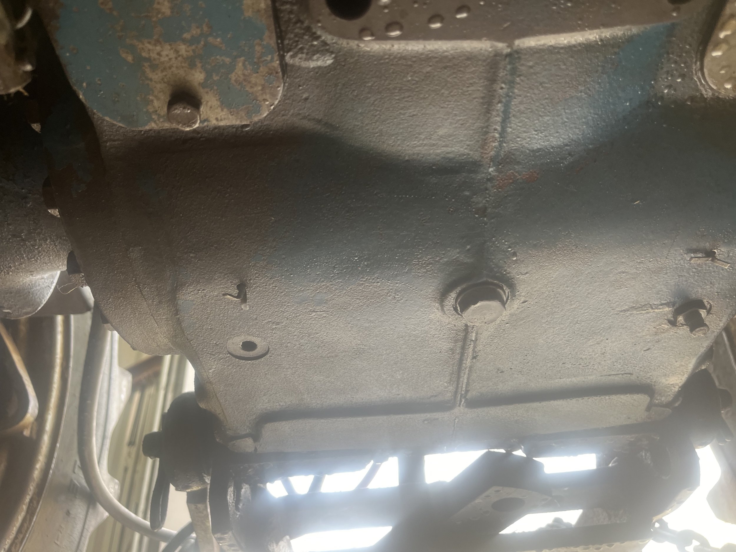

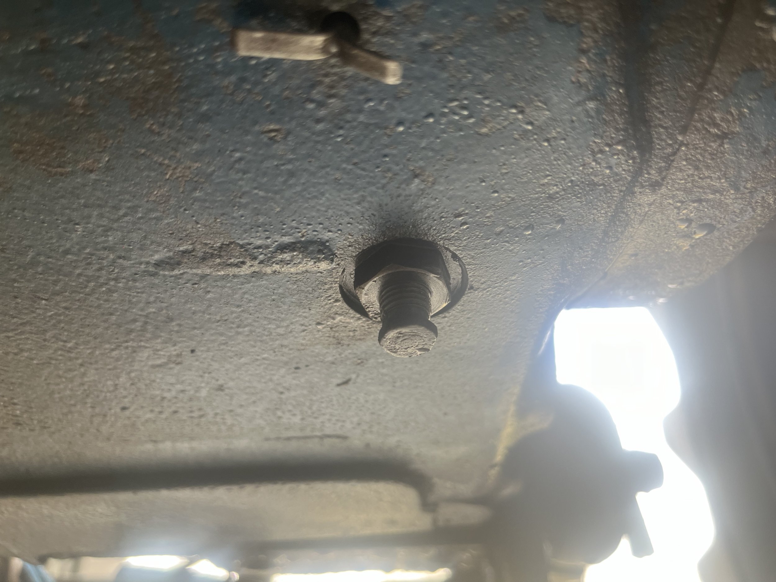

I have a Long 560 tractor with a hydraulic leak from the transmission case. The drain plug and two holes in line with the axles and drain plug are on the bottom side of the case. One hole is plugged with a bolt and jam nut. The other hole is wide open and the parts manual does not show anything for it. Any suggestions

From which hole is it leaking?

The one to the left of the drain plug in the second photo

Looks like the brake setup on that tractor uses brake bands and you're missing the set screw and jam nut on one side.
Those set screws with jam nuts adjust the band so it sits close to the drum but without touching it. Without that set screw, the weight of the band is just pushing down and rubbing on the drum creating extra wear for no reason.
If it's leaking oil there, you may have a seal going bad inside the rear end housing, as I'm pretty sure there shouldn't be any oil on the brake compartment.
   / Long Tractor hydraulic leak #6
The bolt and jam nut are for centering the brake band. You don't want to simply seal up the hole. Oil leaking there indicates a seal leaking between the axle shaft and differential housing. Did you not notice the other holes with cotter pins dangling? You have dry brakes operating in those compartments.

Can't help you with a salvage yard but if you can identify the diameter and thread pitch of the adjustment screw on the other side, you can simply get a bolt and a jam nut. It will most likely be metric.
   / Long Tractor hydraulic leak #9
I would simply take the other one out, use it as a sample, and look for a bolt and nut the same size. It's probably m10 or m12, and most likely 1.25 thread pitch.
