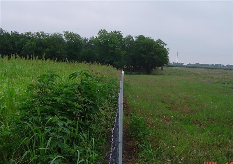

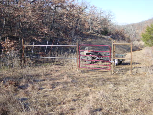

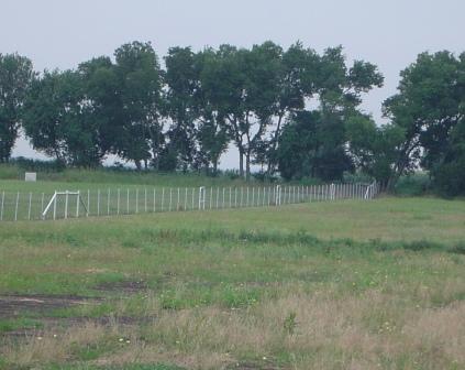

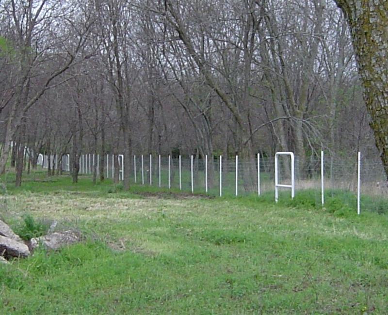

My pipe fence is nearing completion after almost 3 years. As many of you know we have been in an extended drought so welding has not been an option. This is my first pipe and sucker rod fence. It has been a real learning experence. I would like to give wrought'n harv (Harvey) a special thanks for all the helpful information and inspiration.
I will spread out the pictures over the next several weeks as I get them all together and resized.
These pictures are of the north and south sides of my property. I have 8.5 acres here. The sides are around 950ft. Picture 2 shows a terrace at the back of the property.

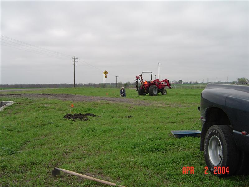

Setting the corner posts along the front of property. These will be at the driveway before angling back to the gate. Note the date on this one. :mad: Oh well you can't rush mother nature.

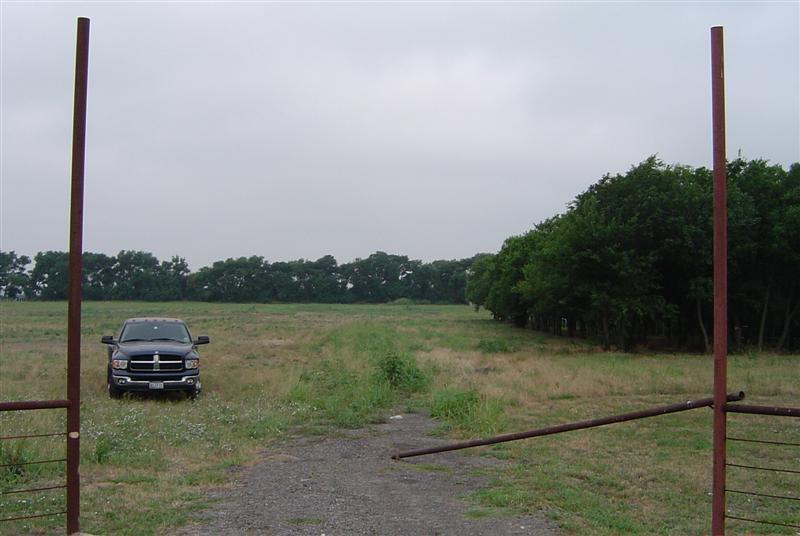

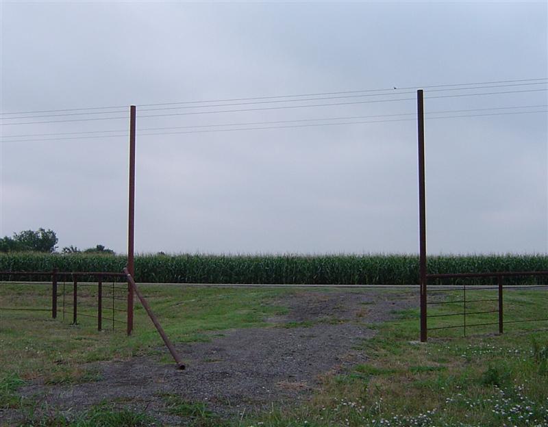

Here is a few pictures of the gate posts installed. Both are 4 1/2" pipe 3/16" thick. Each post is 25' long. They are roughly 9 1/2' in the ground. The paint blotch on the left post is the center mark. When setting with the FEL I wanted to know the tip point.

The gate posts holes were easy the first 3 1/2'. After that they were dug by hand. I have a screw type manual post hole digger. It had to modified using 2 sections of 3/4" black pipe. A lot of water, a lot of patients and elbo greese and the holes were complete.

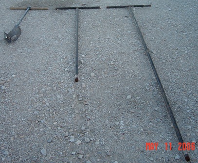

Eddie, I have a well on my place now that I dug in about 4 hrs using this method. 21' pipe and 3' sandpoint. I have sandy soil.
