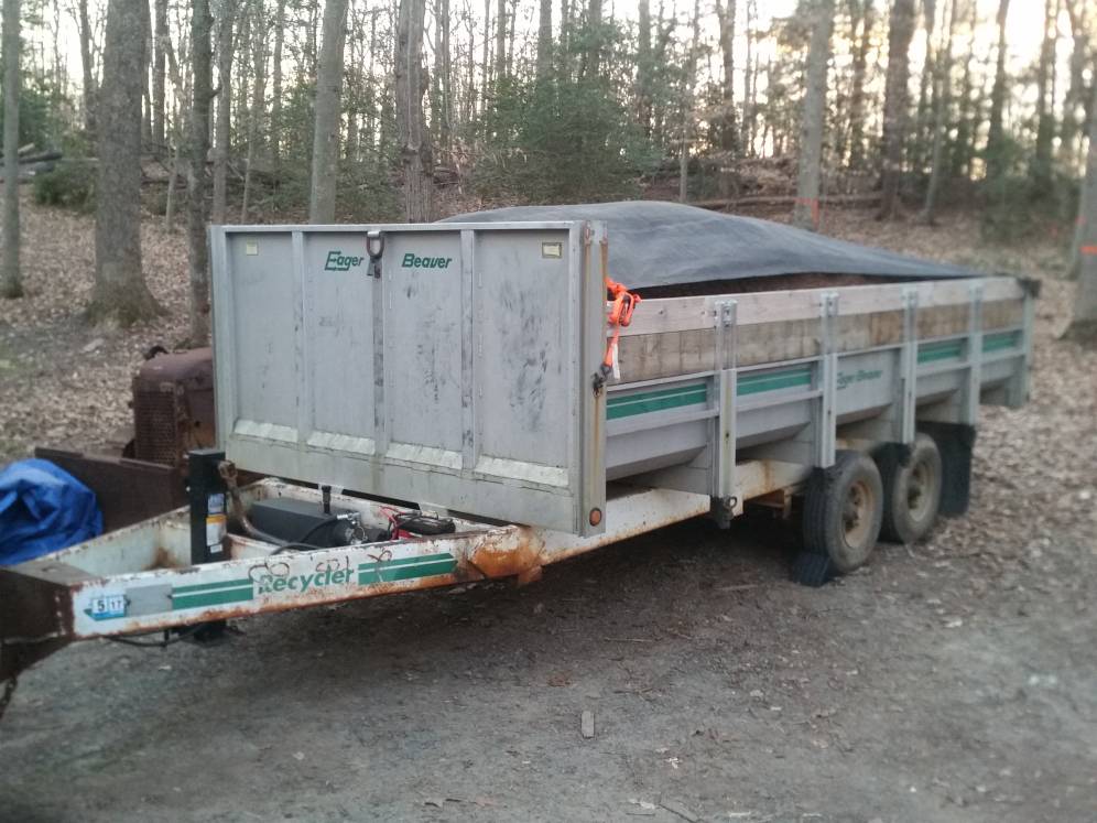

My 16ft deckover dump is lighter, but that's due to having an aluminum body. 20170223_175217.jpeg
