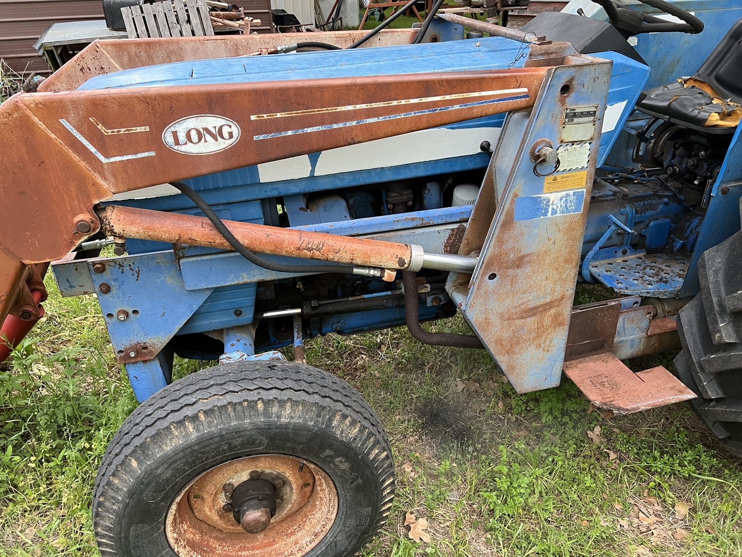

My dad has a Long 610 that sat up for about 6 months and now when we start it, oil spits/leaks out of the breather tube. It is hard to start and runs roughly. You can see the black spot on the grass below the breather tube, that’s about 60 seconds after start (and yes I know it’s a rough looking tractor but before this it worked great). I also have a video but hadn’t figured out how to post it. My thought is that the oil rings on at least one cylinder have given up, but I’m not a diesel mechanic.
I have two questions, first, is there anything else that might cause this? If not, is it advisable to pull the engine down, check the cylinders and re-ring it or should it get a full overhaul? It has a host of other issues and I’m considering whether I should put the money in it or move on. It’s a Long 610 (serial plate show 1582) and the engine s.p. indicates D-121.050.

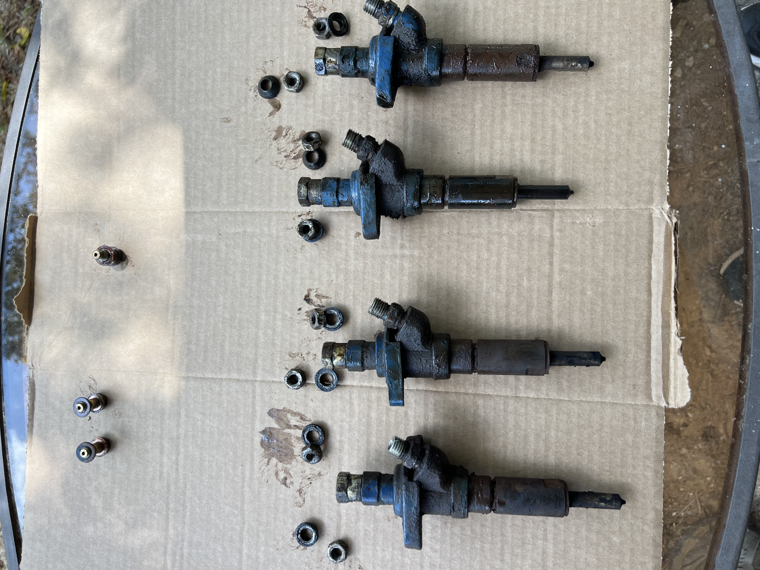

A quick update on this. I removed the valve covers (it has two small ones that cover 2 cylinders each) and inspected the valves/pushrods/etc. All pushrods were straight and all valves seemed to move freely when I rotated the engine.
I pulled the injectors but was unable to perform a compression test as I couldn't adapt the tester to the tractor. It does crank evenly.
A few more pictures are attached in case someone sees something I don't.
I also noticed that the oil doesn't start leaking out until the engine has been running about 3-5 minutes.Once it starts spitting, it doesn't stop and even continues to run for about 15 seconds after the engine is stopped. It starts up normally (1 crank of about 3-5 seconds). Also, when it starts there is zero white or blue smoke at all.
Hopefully I can find a compression tester that works and get get some resolution on this soon.
