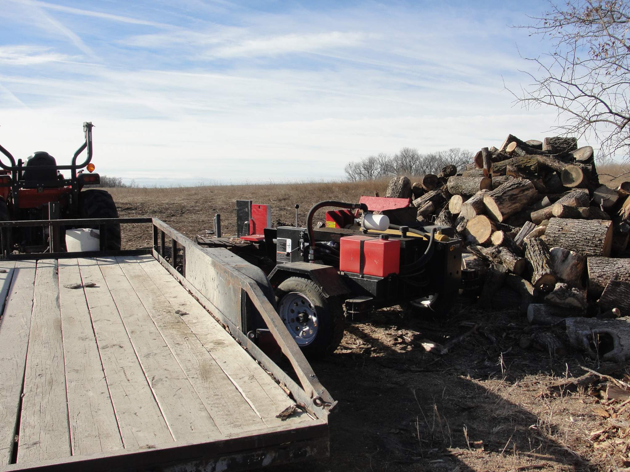

A dozen different people use my trailer mounted splitter including teenage Grandkids. I too worry about safety. I'm not a safety freak, just have valid concerns. I want manual control of the split stroke, auto return is great. I also lecture my family that only the lever operator is to touch the log once it's in place. No one else puts their hands in that part of the operation. Then as a helper, you naturally don't reach for some last minute adjustment during split stroke when someone else has ahold of the lever. Lastly, I've lost track of the number of times I've had logs slide up the wedge or twist sideways on the block or a number of other situations when it's important for the operator to have his hand on the control lever for quicker response to stopping the ram.
As to 4-way wedge, it's the only way to go. Cuts the split time in half on all of the smaller stuff that requires 2 split strokes without it.
I don't have a great picture, but here's a couple of my splitter.

Is that Honey Locust Rob?? I love burning seasoned Honey Locust. Puts out a lot of BTUs and is easy to burn.
   / Logsplitter Wedge, This way or That, Whats the Difference? #37
Actually, it's red oak.... I skidded a HUGE amount of blown over tree's last summer/fall, and after sawing out all of the "saw logs", there was a LOT of firewood left...
