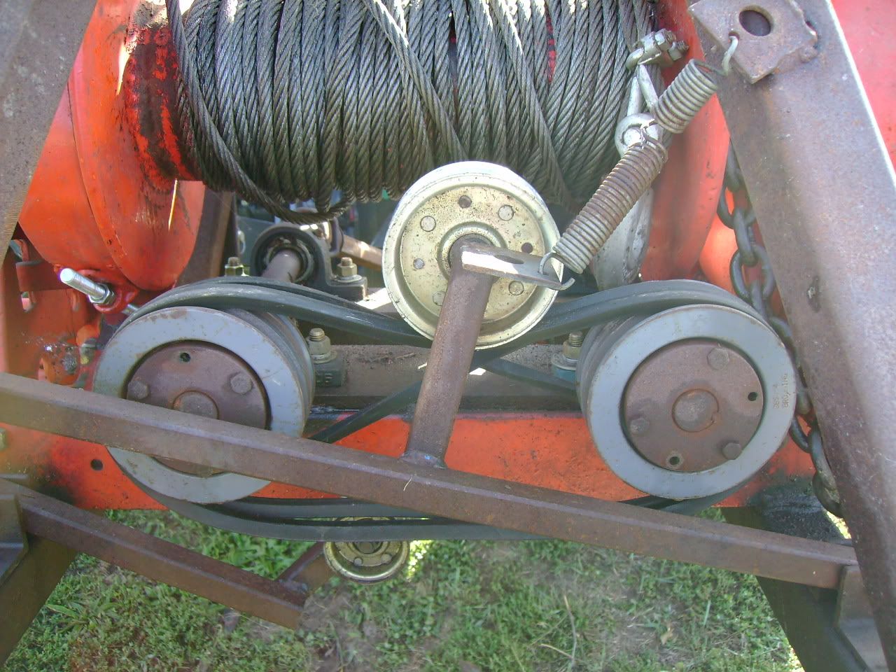

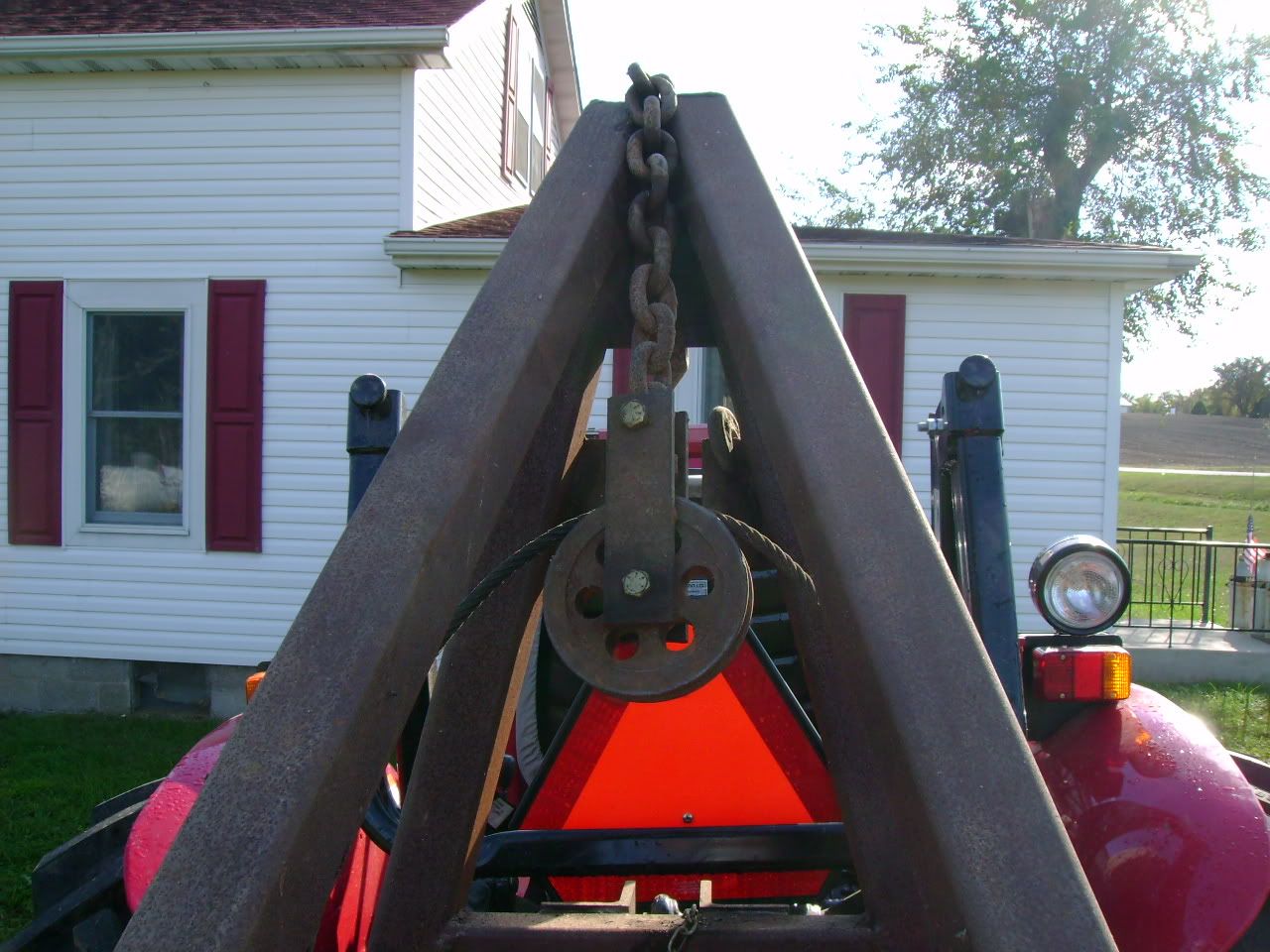

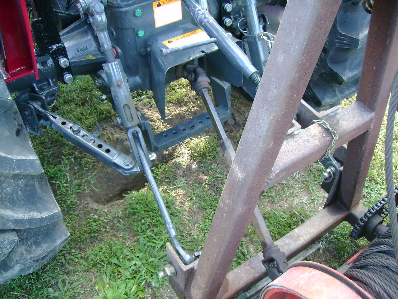

I finally had a need to hook up my logging winch that I built about 5-6 years ago, so I figured I'd snap a few pics of it...
I've not used it yet on the Mahindra, I built it for my 8N after they logged the woods behind my house to drag up the tops that had fallen down into the creeks, valleys, gulleys, etc. It works quite well.
Since the 8N has no hydraulics, I had to make it PTO powered. The PTO shaft drives a 3 groove pulley, two grooves are used to drive the winch, the 3rd groove is for the reverse belt. For the "clutch" I put an idler pulley on a spring loaded lever, which presses the idler pulley into the belts, which drive a jackshaft which drives a sprocket/chain which ultimately drives the winch. It works fairly well, I just need to come up with a way to make it so that I can use a rope to engage the drive, for safety. But, the winch is wound with 100' of 7/16 cable, which I don't think I could break if I wanted to... It would pull the tractor over first, at least it would with the 8N.
Now that I've got a tractor with hydraulics, I'd like to convert it over to hydraulic drive... that would be much much more convenient... That reverse belt is a PITA... definitely the weakest point in my design I think.
Take a look!

Thanks for the compliments!

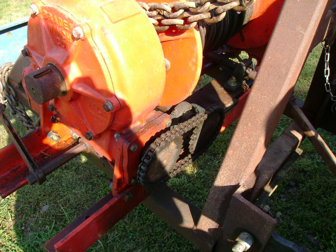

I got the inspiration for building this one from looking at the Farmi winches and how they were set up. I called and priced them, and decided that if I could find a suitable winch, I could build one myself much cheaper than what they were asking for a new Farmi.
So, after watching eBay for a few weeks, this one came up for sale, freshly rebuilt, from a gentleman in Wisconsin. I won it for $150. Shipping to get it down here to S. IL was more than that. So, once I got it here, I started scrounging parts, got a few different things from buddies at work, and had to buy some steel. I think I've got maybe $650 in it, tops. Had a lot of fun building it... it was my first serious design/build project. I drew it all out on paper, figured out all the angles, then started cutting out a "kit" from the square tube steel. Started welding everything together, and it all fit!!! I almost couldn't belive it:D.
It isn't the fastest winch in the world, I think I calculated it at 21 feet per minute at 540PTO speed, but, it gets the job done... I'm not in "production" mode when I use it, so speed isn't that important. It's strong enough to completely pull the 8N over on top of itself at idle, so anchoring the tractor is the real limiting factor. I usually try to find about a 4-5 inch sapling that I can put the bull blade against if I can't get the blade to dig down into the ground, or if the ground simply won't hold it (quite common out in the woods)... that way, I've got a good anchor, but if whatever I'm winching hangs up, the sapling is still small enough that it will give out before something else does.

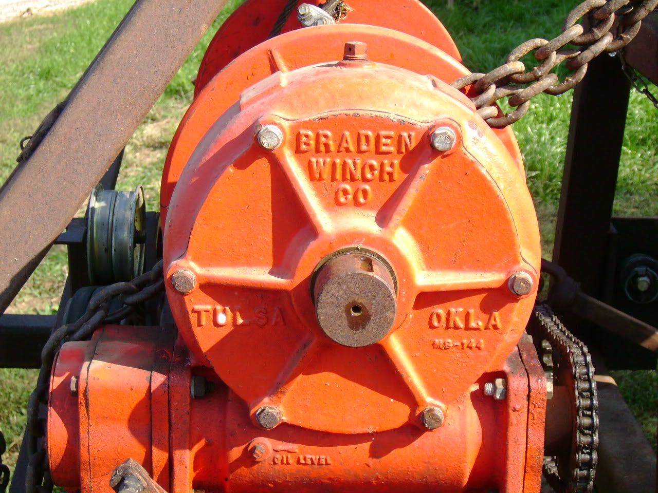

I fired off an email to Paccar (new parent company for Braden) to see what they have to say about hydraulic motors... and to see if they can find the specs on this winch. I can't get anything off of their website, I guess the winch is too old, and probably isn't supported anymore. Looking at the serial number, it was built in 1950... I think it is a 10,000 lb winch, but I could be wrong, it may be higher rated than that. It's a Braden M9-18B-L, if anyone out there has any info on old Braden winches...
Could it be 20,000?
Vander Haag's, Inc. - Exact Parts Inventory
(There are a couple of Braden winches on the page)
/ Logging Winch
I saw that same page yesterday... I think you're right, it's a 20,000lb winch...

This is my first post. I found this site looking for logging winch ideas. I had something like this one in mind and was wondering if the original poster xlr82v2 was still around or if anyone else has made one similar to this.
I have an old brayden winch that is about the same design and am wondering how this mounting frame worked for pulling logs.
Anything you wish you had designed differently? If you made a similar one what is the best feature of yours?
Is it easy to rewind the cable with that pulley on the chain or do you unhook it and guide the cable by hand?
Any other design tips for a winch mount similar to this one?
