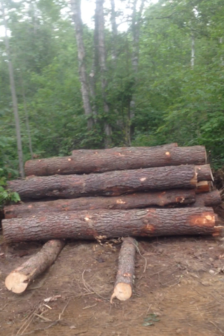

What you have pictured is what I WISH I got. LOL
I can't look a gift horse in the mouth, but my "pile" is much messier. The logs are also parallel to my access, rather then perpendicular.

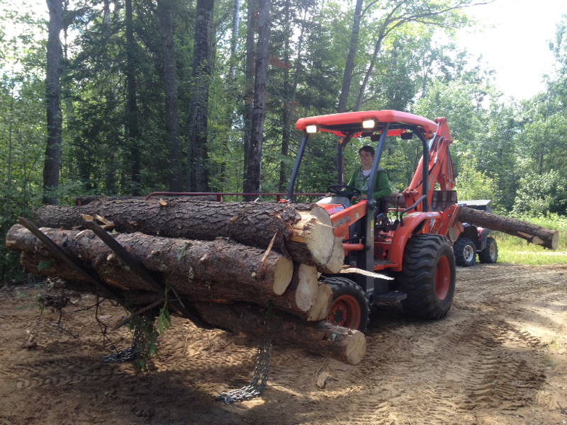

I have pallet forks, lifting tongs and a backhoe thumb. A pair of lifting tongs on either side of the bucket allows you to neatly stack logs. I like using them for setting logs on the trailer between the fenders - not so easy to do with pallet forks without rolling a log into the fender. To lift logs with lifting tongs on the backhoe, you would have to pretty well balance the log, even with a pair of tongs it would take a bit of trial and error. With a single lifting tong on the backhoe, you could lift and drag one end of the log on the pile and then do the other end of the log. Unless you have a helper, it is slow work with the tongs.
I have a mechanical backhoe thumb and it is very handy. I took down a dead 45' tall pine the other day. I cut the tree in two ~20' lengths, grabbed a length of tree, branches and all, with the thumb. I could swing the hoe around as a drove to maneuver the tree between other trees to get it out to my cutting and chipping area. Three trips and the entire tree including the stump were gone.
