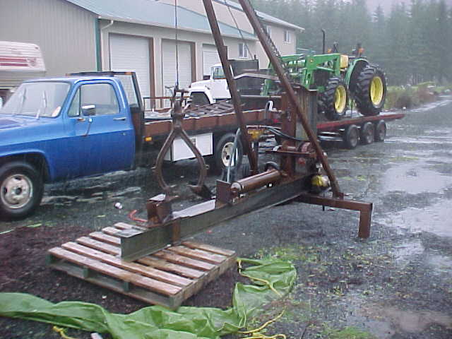

A joystick runs 2 spools with one lever. He ties the stick over to one side to get the oil to flow for the splitter. You have to disconnect the hoses for the bucket and hook the valve from the splitter to them to get oil.

splitter pic
