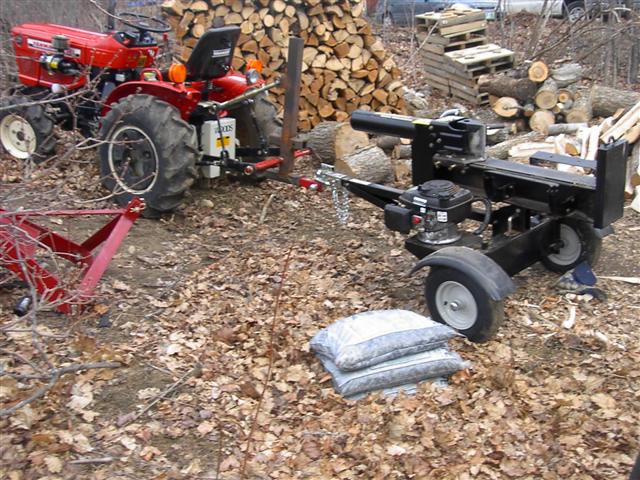

I have a Yard Machines (MTD) splitter that I bought several years ago on eBay. It was slightly used and saved me about 35% of the cost of a new one. This is their current model , but mine is 26-ton and a 6.5 hp B&S engine. I've split 150 cords of hardwood in the past two years, without any significant problems. I really liked the Timberwolf, especially since this is a business for me.... but I just couldn't handle the cost. This splitter has performed well and I have no regrets. The cycle time is a little slow, but I rarely let the wedge fully retract, so it is really a lot shorter. And if you are operating the machine alone, the slower time gives you a chance to get the next piece.

I too have a "Yard Machines" splitter, purchased at the Depot. I was able to get it during a 10% off sale.... a fair amount of money when you are spending $1200 or so. Mine has the Honda motor and a 27 ton rating. I love mine, and i have split some gnarly hardwood with barely a hiccup. I would certainly say it has exceeded my expectations ! I had weighed out getting a 3ph splitter, but when you factor in the additional hours running your "more expensive" to replace tractor engine, versus a "less expensive" to replace small engine... i opted for the self powered tow behind unit. Of course... to each their own, just thought this was the best route for me !

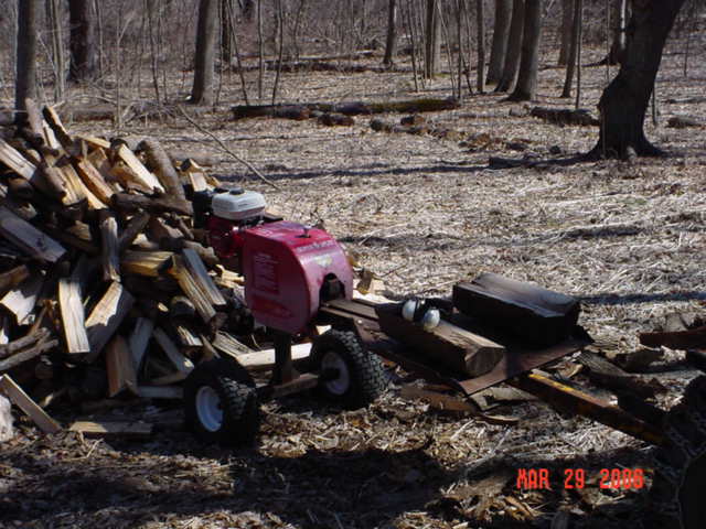

I'm surprised you didn't see this one in the WantAdvertiser recently. I have a 3PT tractor run hydraulic splitter. It works great and is super on large pieces of wood that you cannot lift. But I got tired of the slow cycle time. I saw this one last week in the WantAd and picked it up. It is a Super Split logsplitter with a Honda 5 1/2 horse motor. Cycle time is under 3 seconds. It has split everything I have thrown at it so far that I could physically lift up on the table. What is great about a seperate unit is the fact you can put your bucket right up to the splitter and fill it up as you split wood. Others have commented about this in the past and I always felt it was just more money to spend. Now I have a total different feeling that I have more time to do other things. Mine has the work table on it which I highly reccommend getting if you buy any type of splitter.

I, for one, would at least try one out if I had the money and needed a splitter - and their prices aren't all that bad anyhow.
I have seen them referred to, write ups, ads etc over the years. Never heard and negative comments.
Harry K
