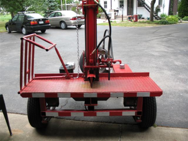

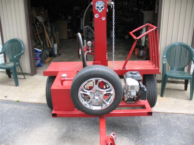

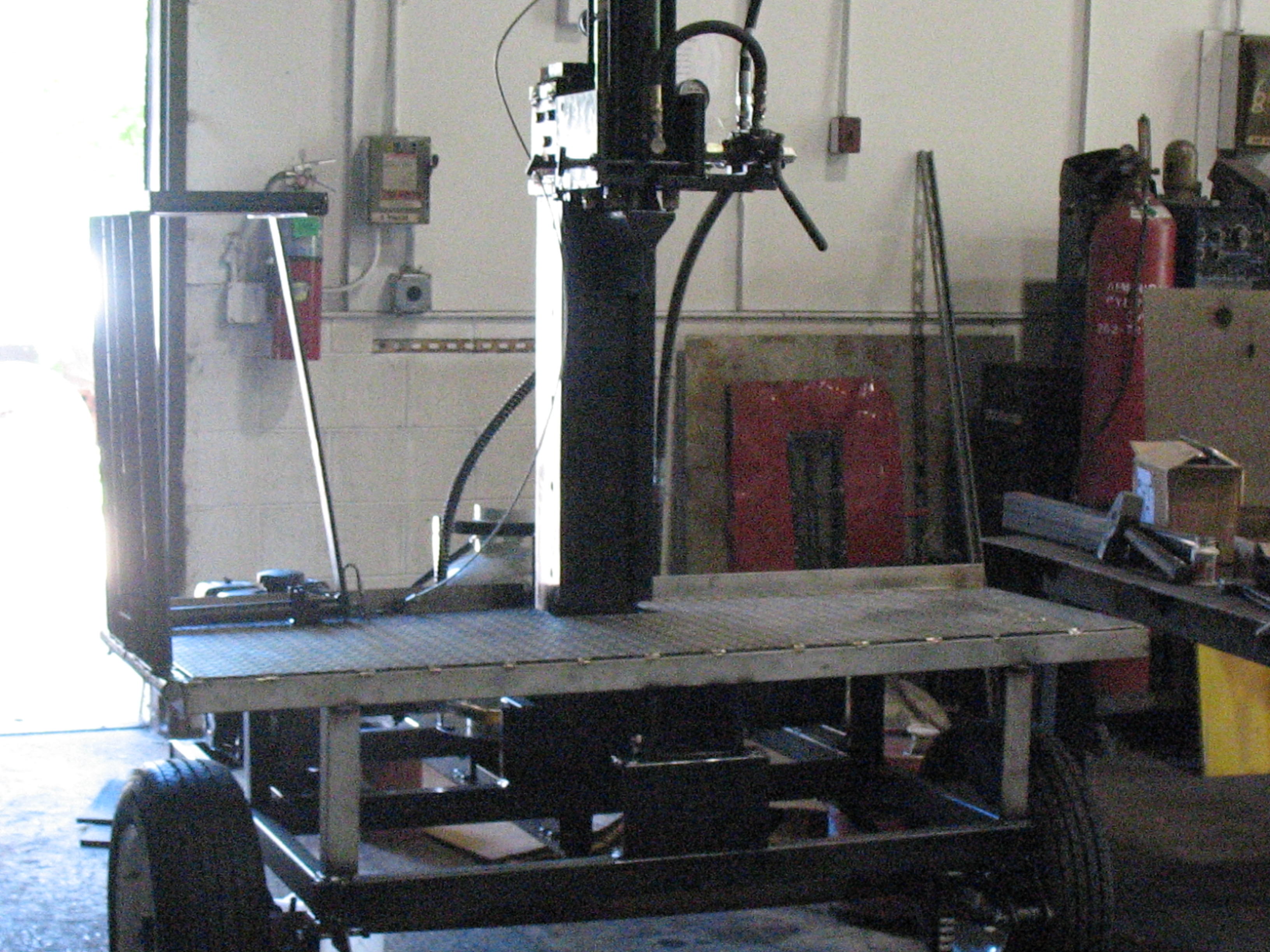

A log lift for this style of splitter can be very inexpensive to add. I found the only real added cost when building this style splitter is the steel plate for the table.
I have made 7 of this type, 2 where people want their horizontal or H/V converted to the table style. The red splitter was brought back to have the log lift repaired after it was backed into.

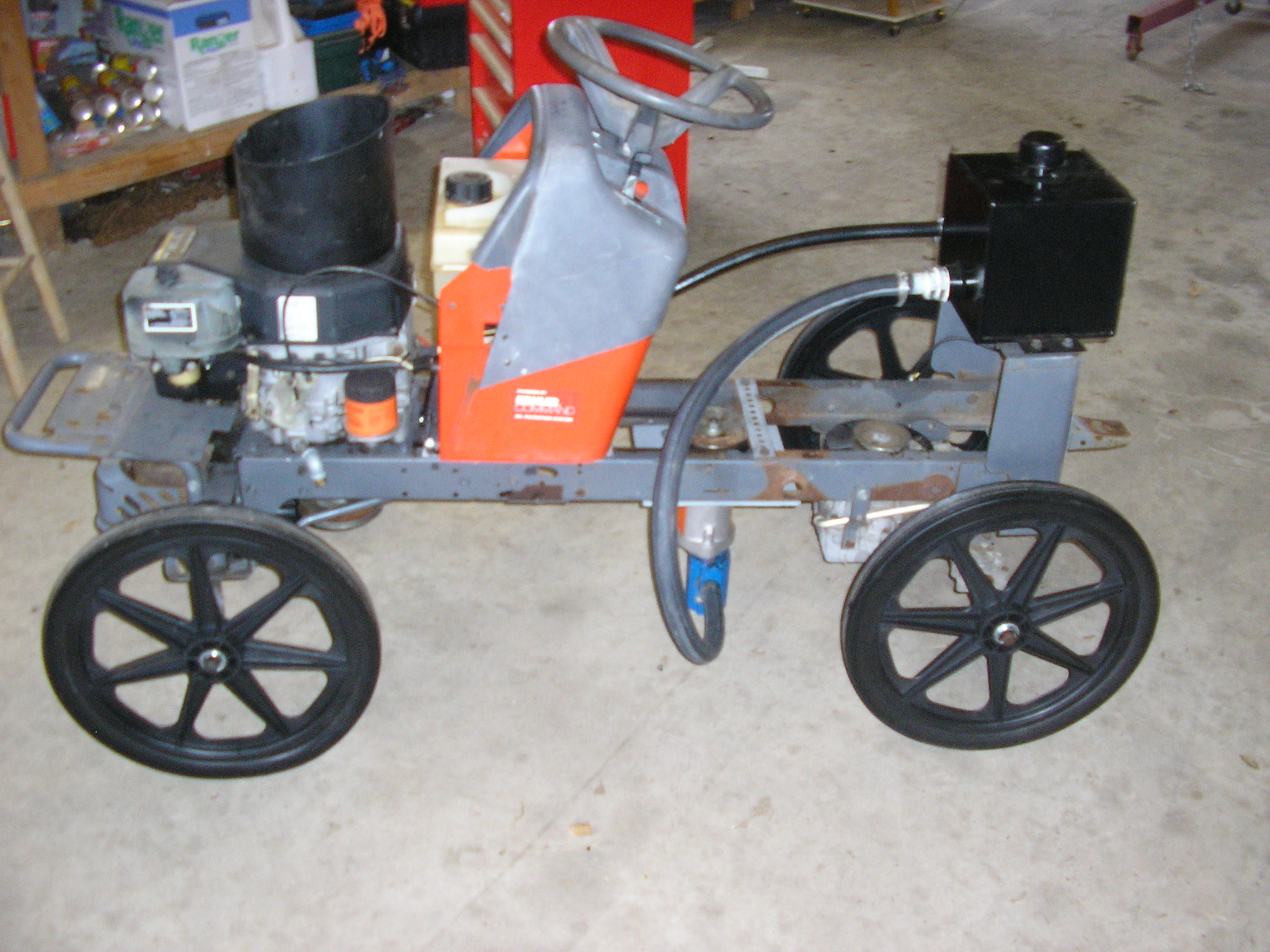

/ Log splitter.
#11
Trip,,,, that is almost exactly it. Thanks for the pic. I am going to use a ready made and convert it I think. A little more farmer, just tired of fussy fabrication. I was going to hook it to this horse and have held it up for guestimation and need to get back to it. I might use a forklift mast for the lift table. I also thought of a roller conveyer to set several up at the same time, can deliver them off the loader even.
