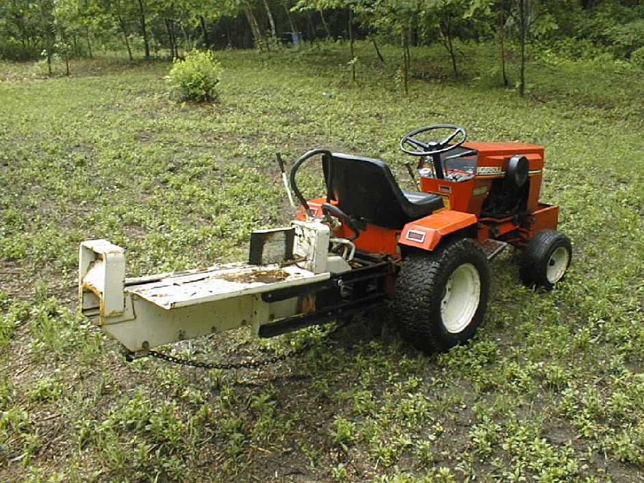

Thought I would show you this picture. It is a log splitter on my wifes Ingersoll 224. This thing will split anything! It is dubble acting, and runs of the tractor Hydrolics.[The Case/Ingersoll hydrolics on the tractors put out about 10 gph]

No vertical. It will lift up, or down though. You can lift it up so you dont have to bend down, or lay it almost to the ground. In the pic it is about middle. As far as lengh, I don't know for sure, reg fire place/wood stove lengh fits, but I was going to split some bon fire stuff a little long, and it was to long. I am gussig about 24"

A splitter of this design would be very inefficient (for the operator) if the stroke was longer than the normal length of firewood (18-24"). The operator would have to wait for the ram to get back to the next piece of wood everytime. I'm curious as to why you have 4' long firewood?

Hi, I bought a Northern 3PH log splitter for my NH 2120 (9.8 GPM) but because, as another poster mentioned, the control valve did not have a detent position on the return stroke it was not very good for splitting wood fast. Most splitters have a detent in the control valve that allows the user to not have to hold the valve handle while the cylinder is returning (return stroke only). You and make the most of this time by picking up another piece of wood so when the wedge returns far enough you can drop the wood in the splitter and reverse the direction and continue splitting. The stroke time is slower on this unit because of the low volume tractor hyd. A 4" cyl @ 2500psi will give 16 tons of force and requires 1.3 gals at 24" stroke. This equals a 9 sec stroke time out and 9 sec back. As for me I prefer the horizontal splitter because I'd rather lift than bend over and work, but thats just me. If anybody wants to build one I have a set of plans for a 3ph unit that u can build for about $300.
